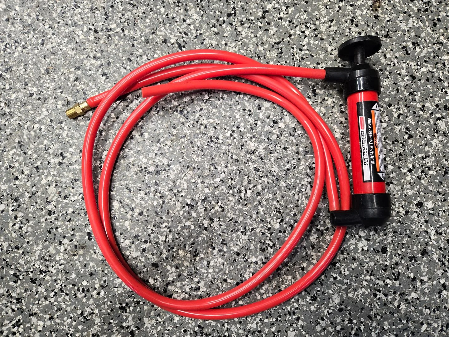

LILCBRA said:
You'll obviously need a couple tools to get this all accomplished, these are my recommendations:
Multi-Use Transfer Pump
Amazing deals on this Multi-Use Transfer Pump at Harbor Freight. Quality tools & low prices.
www.harborfreight.com
Amazon.com

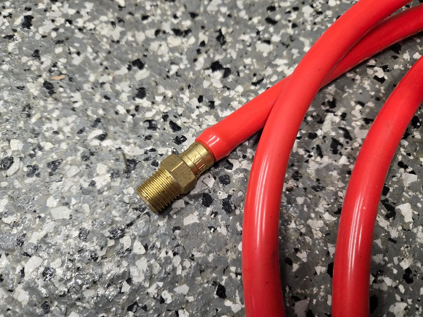

Rdub6 said:
I’ve always had trouble with the hose on those pumps curling up, and then they’re not getting to the bottom of the tank. Anybody have any tricks that worked to get that hose all the way to the bottom?
I have the same one. A trick i found is to put a brass air chuck fitting on the end of the tube. It goes through and comes out of the filler neck fine. You also get that satisfying clunk when it hits the bottom of the tank! Works great actually.
Reactions: LILCBRA, Rdub6, Mcmahst and 1 other person
