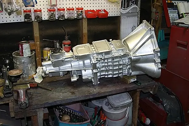

Can someone help me identify this transmission... apparently my car started life as an auto...

It's a Tremec 3550 or Tremec TKO. The 3550 has a 10 spline input shaft and a 28 spline output shaft. The TKO will have a 26 spline input shaft and a 31 spline output shaft. It may also be a TKO-500/TKO-600, which is the newer model of the 3550 series. I don't know the specifics on the newer models off the top of my head. Good transmission to have either way. TTC claims much higher torque ratings for the TKO-500/TKO-600 series transmissions, But I've rebuild both the 3550 series and a TKO-600, and they are virtually identical inside.

Looks like a TKO-500: Tremec TKO-500 Transmission - Ford Mustang

Definately a Tremec, probably a 3550.

well kind of confirming what I had a hunch of but the reason I'm asking is because I need a new transmission mount... someone gave me a t-5 mount and said "it has to be a t5" but when I went to bolt it up it was too wide where it bolts to the tranny.

I would be stoked. A 3550 is like a $1300 transmission new. That transmission is infinately stronger than a T-5.

oh i am happy that its not the t5, i just don't know what mount to use

Def. not a 3550.
I'm positive its a TKO-500

Is there a part# on the thing you can ask someone at Tremec about?
I said a 3550, b/c the pick I saw of a TKO 500 had a slightly different looking shifter mounting plate/piont.

Shifter mounting points are the same. That looks like a stock 3550 shifter to me, which isn't a very good shifter. I think the TKO-500 actually comes with a better shifter.

its a 3550, the tko 500/600 had different shifter plate.
the 3550 has the front two closer inward and on the tko 500/600 all the bolts are inline
