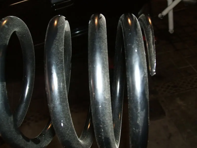

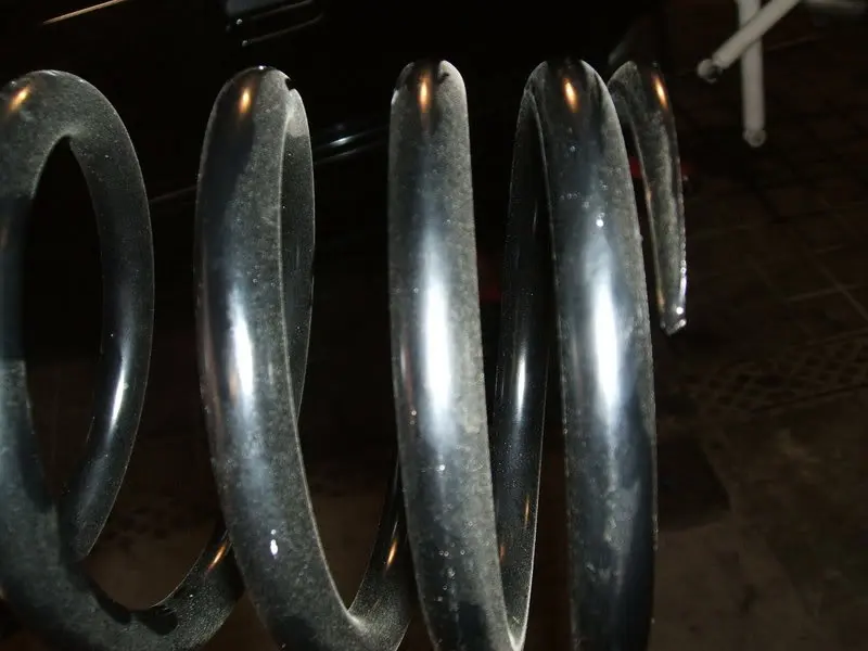

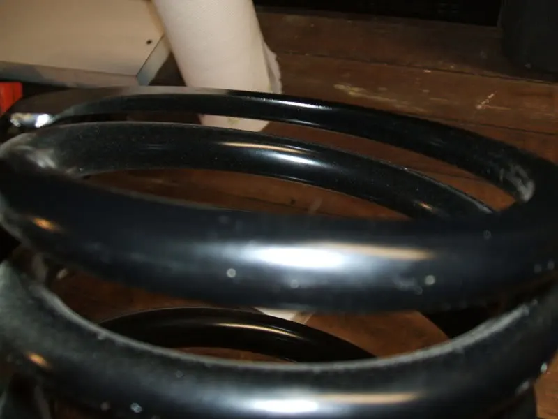

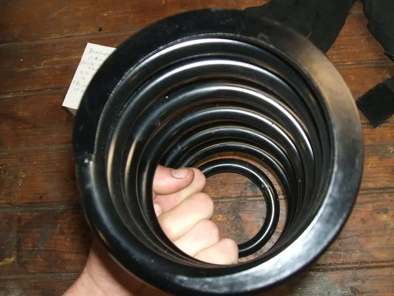

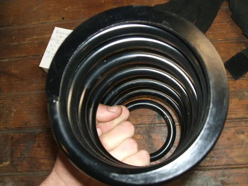

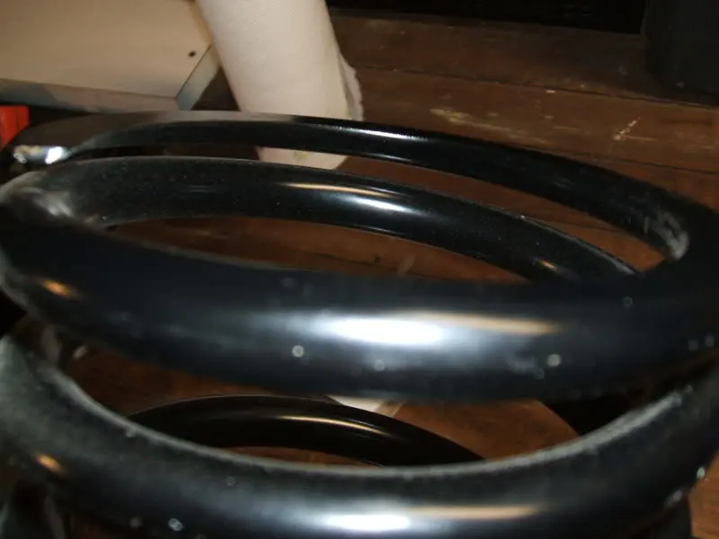

Ok, heres the deal. I used new iso's all the way around. Top and bottom. I do not want to remove them either. The instructiions that came with the springs said to "cut" them if you are not happy witht the look so I assume ford racing has done there homework and its ok to cut the rear springs. I can get 2 fingers between the front wheel well and tire and 4 fingers in the rear. I guess thats about an inch difference. How much do i cut off the rears and how. If i cut them then i will be losing the flat spot on the top of the springs which will suck. Here are pictures of the springs, so maybe someone could put them in "paint" and put a line on where about i sould cut the springs to lower the car in the rear another inch. Thanks

yeah bro. The front settled alot but the rear is up in the air like a jack rabbit. It looks rediculous. I know its not gonna drop much more. I even threw about 300 pounds of weights in the back and let it sit in the gargae for a week and still thats the result.
I have heard 1 coil = 1 inch. I have never done it but thats just what I heard. Maby you should put the 300l;bs back in it and drive it around for a week or so. Once you cut the springs you cant weld it back.

Since the rear springs have different dimensions top and bottom, you'll want to cut from the consistant side (the bottom). Figgure out how much you want to drop it, and realize if you just cut the flattened peice off, its not really going to change. You'll have to move up past that flattened peice. Maybe cut right after the flat part and use a bench grinder to flatten the remaining spring so that it can seat properly?

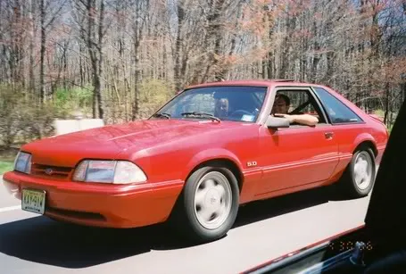

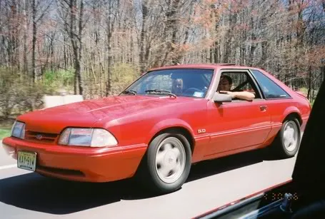

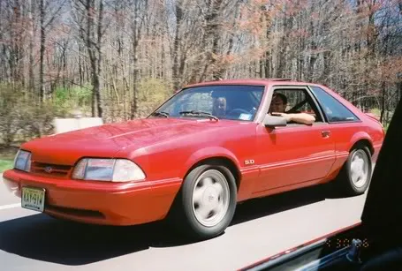

is the rake worse than this? this was my 92 with "C" springs: (yes its sitting slightly downhill but you can see the rake if you pay attention to wheel gaps)
but at 65mph it looked like this:
i always thought it was interesting...
I wish mine looked like yours. Put it this way, I can see my shock absorbers.

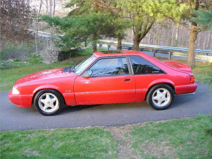

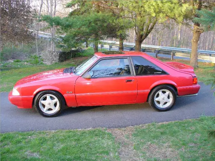

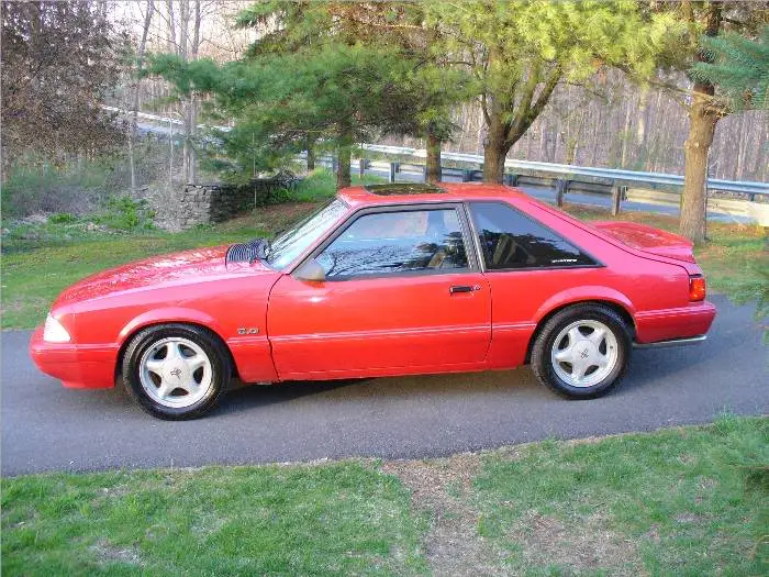

here is what mine looks like with C springs, and a lot of weight reductions.

I cut a rear set of C springs a few years ago. Don't worry about the flat spot on the end of the spring. Just cut 1/2 coil, see where it sits. If it's still too high, cut another 1/2 coil.
