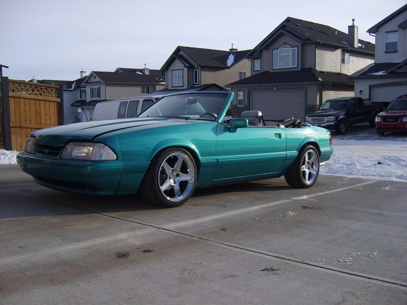

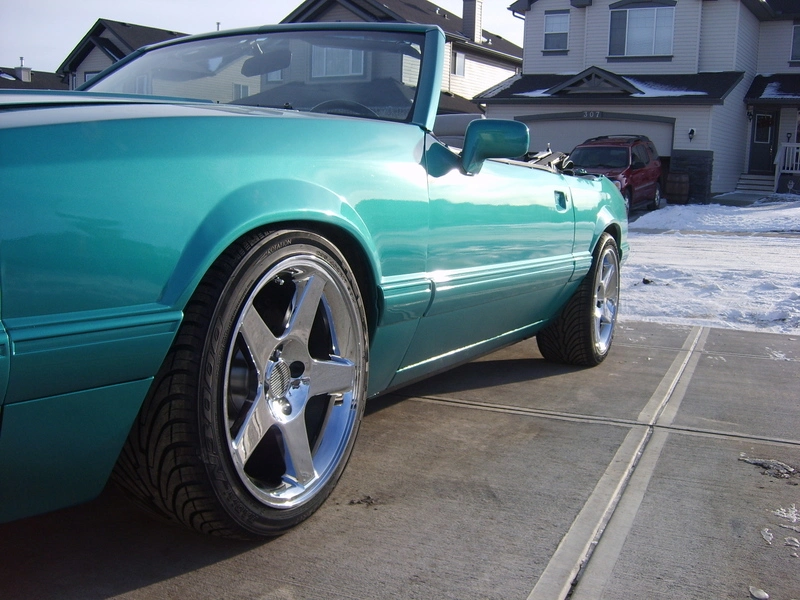

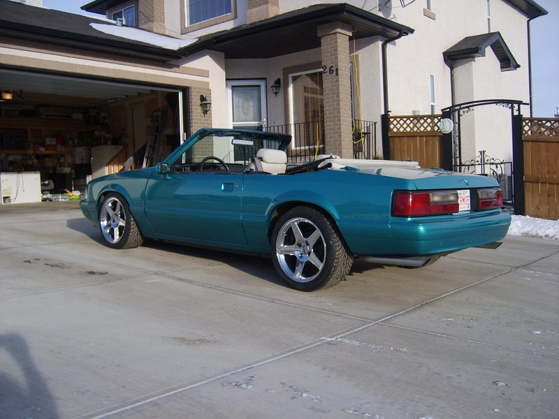

here is mine, i had to cut a coil off the front to get it like this, but i think i amgoing to get it a bit higher in the front, the rear will sag a bit cuz there is no gas and no sub in the trunk yet.
