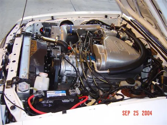

I ran an AFCo on my blown 331, and have buddy running one on a blown 347. And using a volvo fan, that can be found on Ebay and Corral..This is a thread I posted on 4eyedpride about the fans, but you can see the AFCO rad..
I put about 5 of these on for guys around here, 3 of them were on blown & stroked cars. The move allot of air and are reasonably thin, around 3.75"'s for you blower guys..And they have a decent size shroud. I installed them with an adjustable Thermo switch and let them work on their own...
Just trim off all the extra tabs and it fits great. On stock sized rads they fit without trimming the shroud, but have to trim some on the AFCO rads I put them on. On stock sized rad they cover any where from 90-100% of the fins... And on the AFCO rads, it cover 100% of the fins..
Here a few pics of one I put on a blown 347 car with 8 rib 8" renegade pulley.. Can see the one pic where the shroud had to be trimmed for the AFCO rad. Also put one a Novi 2000 car with th 10 rib set-up and it fit. That car had a FMS aluminum rad and had about 1/8 to 1/4 inch clearance.. Don't have any pics of that install, and will try too get soem next time I work on that car...
