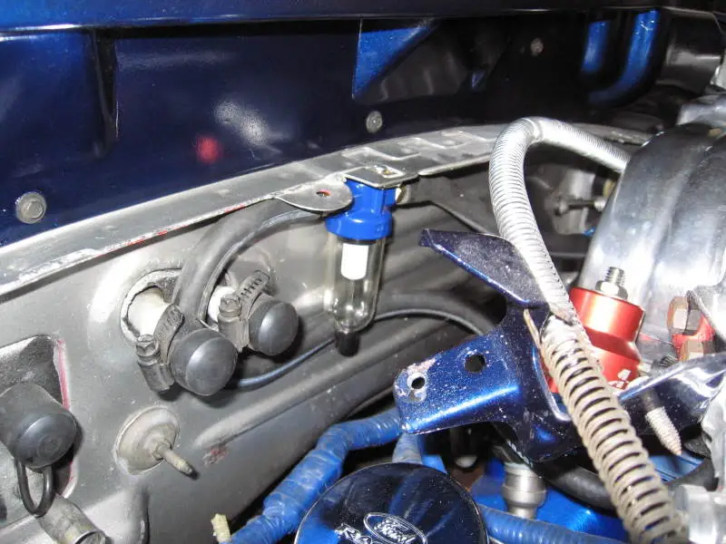

I was just thinking yesterday about the oil sep. things
Now that some time has passed, what are the peeps who put on on seeing?
Are they noticing oil collecing, any engine symptoms good and bad?
basicily a progress report on the time effects of the seperator.
I'm dumping mine out once about every 10 days. It accumulates about 3/4" to 1" of oil in that time frame.
BTW, I have that same seperator .... and removed the filter element. If you run synthetic oil, and do not remove it, it will partially clog.
For me, I found that the separator filter media would clog and stop allowing oil to be deposited in the trap. I removed the filter and it works like a champ.
As said, the separator helps keep that crap out of the intake, which helps combustion, lack of detonation, etc. Something to do if your bored is how I see it. :D
