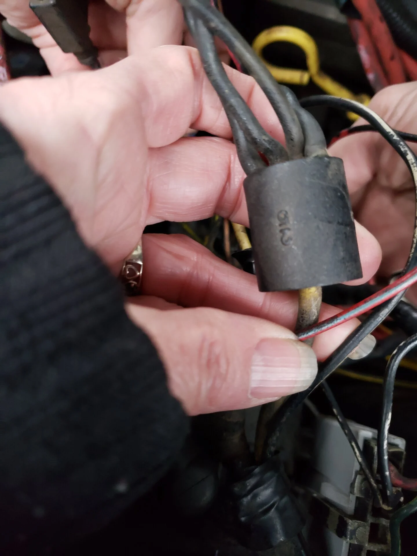

Can you tell us what this is? Seems to be half or all our problemSo is robscar fixed? Something tells me no.
Can you tell us what this is? Seems to be half or all our problem. Connect into coil cluster of wires

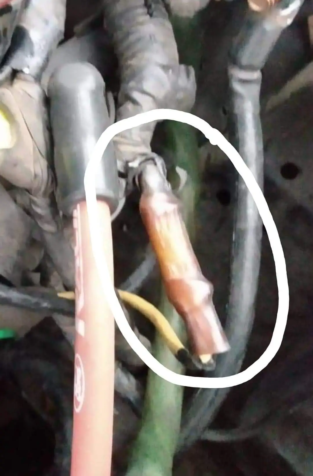

Think we found a broken wire from coil. There is spark to coil but not to top of cap. Tried different coil wire just in case but get the same result. Noticed the yellow wire off the coil seems to have been fried at some point because it looks broken and burnt in the fusable link. (What we believe is the link)Thats just a junction where the fusible links connect to the wire that goes to the battery/solenoid.
It was, yellow. We replaced it and a couple other wires that looked like they connected and were a little crispy and ta da!! She runs!! Thanks everyone for all the helpIt's a fusible link. What's the wire color?
