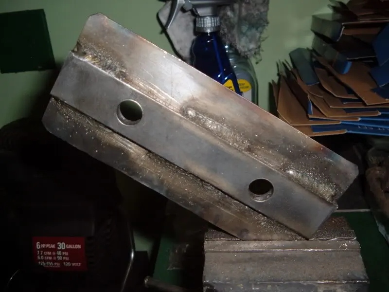

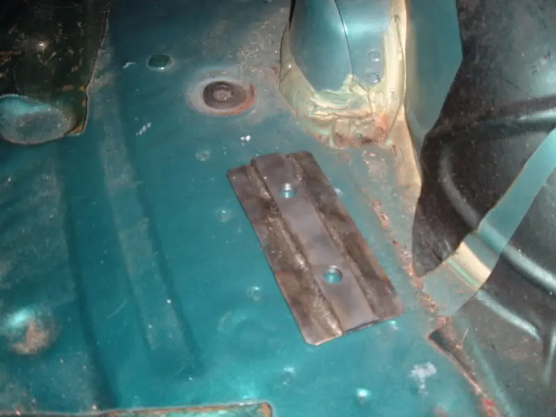

Couple questions, is it from an 03/04 or 99/01? Does anyone know if the 99/01 have the brace infront of the pumpkin? Do the solid axle gears fit the IRS pumpkin? Also I drove two Termis this weekend and on rough roads the ride is so much better its worth the price of admition alone IMO. Also you can get a live axle to be just as good on a track, but on the road its a different story. Off camber corners with potholes the IRS dont even care, same corner with my live axle I have to take 10 mph slower because of the a$$ wanting to bounce all over the place. I hop to do the same mod if I can find one, although on my Aero I think I have to do some custom work through the trunk floor for brackets:shrug: Benny has been a great help with the info for me too, thanks buddy :nice:
99/01 no brace (or a real whimpy one, I've never dealt with stock 99/01 stuff). Kenny Brown made an IRS brace which was quite beefy, but also the OEM ford 03/04 brace is actually sourced from the Cobra R - so that's what most everyone runs. Also some braces, and some bushing sets, require that you take off the big vibration counter weight often called a "dog bone" for some reason; that's not a bad thing, however. So don't be scurred to ditch the brick :nice:
The trunk floor brackets are NOT a bit deal, heres a set my friend made when putting a modded 99/01 rig in his 97 cobra.
You can use some tubing and run it in the holes also so you don't crush the frame rails...but really that's sort of pointless cuz the bolts are more or less letting the IRS "hang" from the frame rail, rather then squeezing the rail in that direction. plus, you'll pull the floor of the trunk down WAY before you crush the frame rails, hah. Brackets are just two mild steel plates welded together, you could use a single plate but that puts more stress on the mounting holes instead of allowing the smaller narrower top plate to more evenly distribute the stress along the bottom plate.
