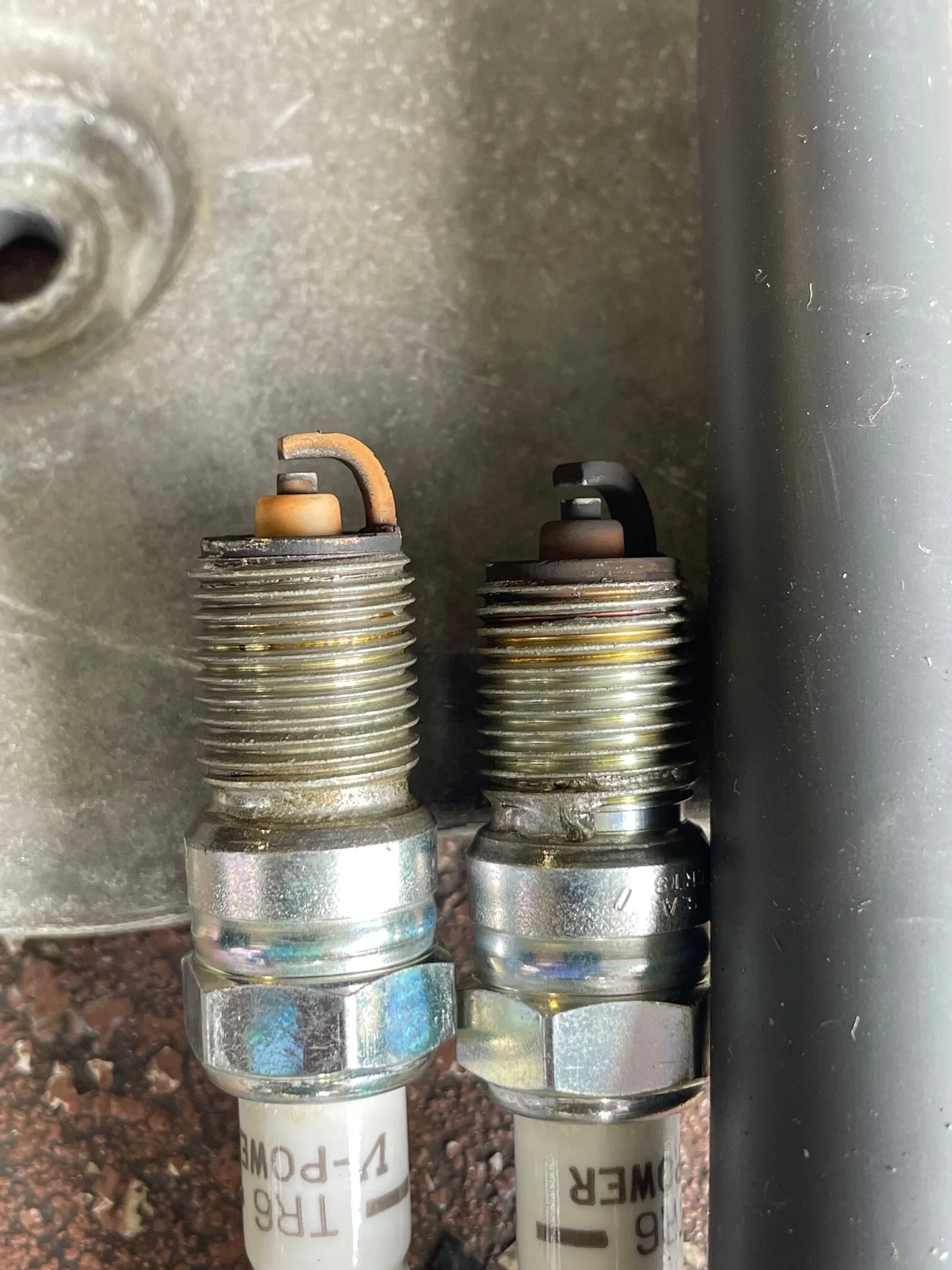

- checked out bank 2 spark plugs gapped at 0.032 **THIS is where its a little interesting to me** (pics attached)
Cylinder 5,6,7 all looked like the plug on the left - Cylinder 8 is the dark plug on the right
I then replaced the spark plugs in bank 2, drove around, filled up some premium, put some seafoam in the tank and went to check them again.
So far cylinder 8 is looking more like the rest of the plugs in the bank. SES light remains.

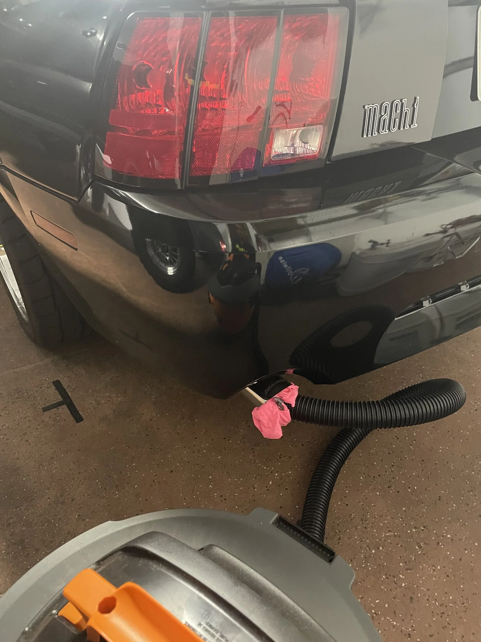

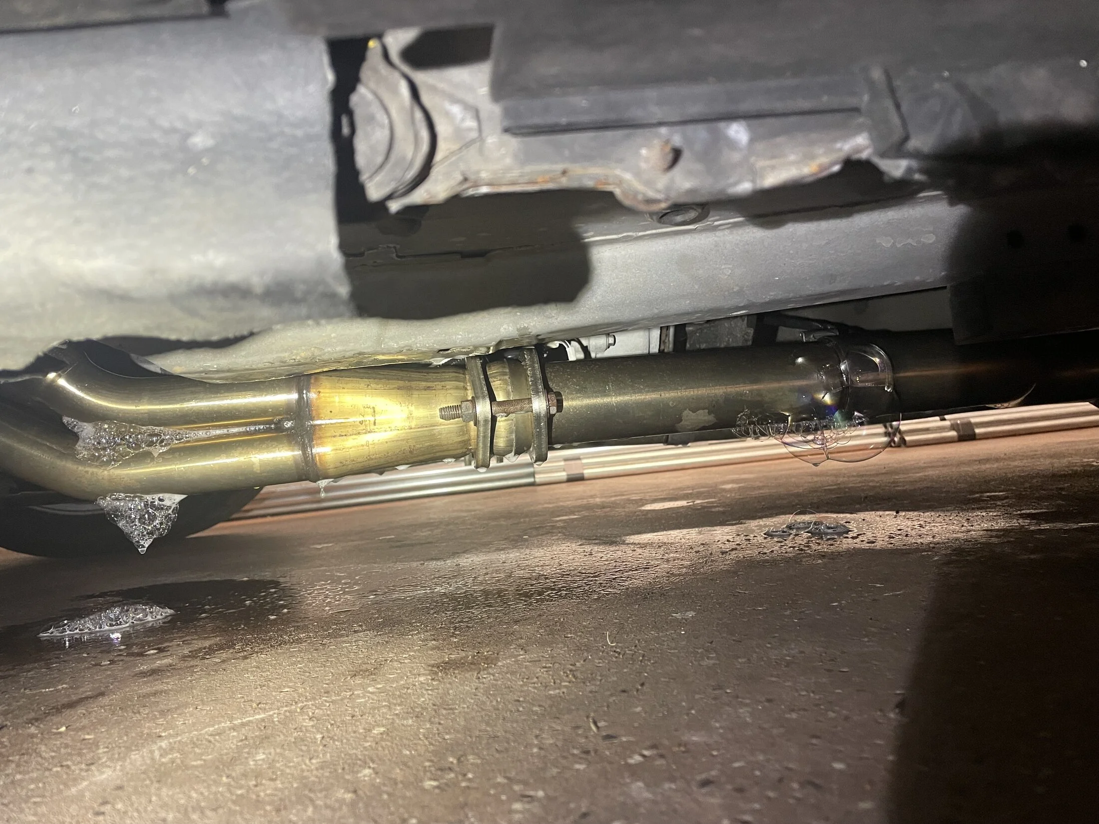

Tomorrow I’m going to smoke test the exhaust
I did the intake side today and it looked good
Only reason why I asked about a bad coil on plug is due to the first time I pulled the bank 2 plugs - during that time all had the same color except one. The picture is at the beginning of the thread. Looked like it wasn’t fully firing compared to cylinders 5,6,7

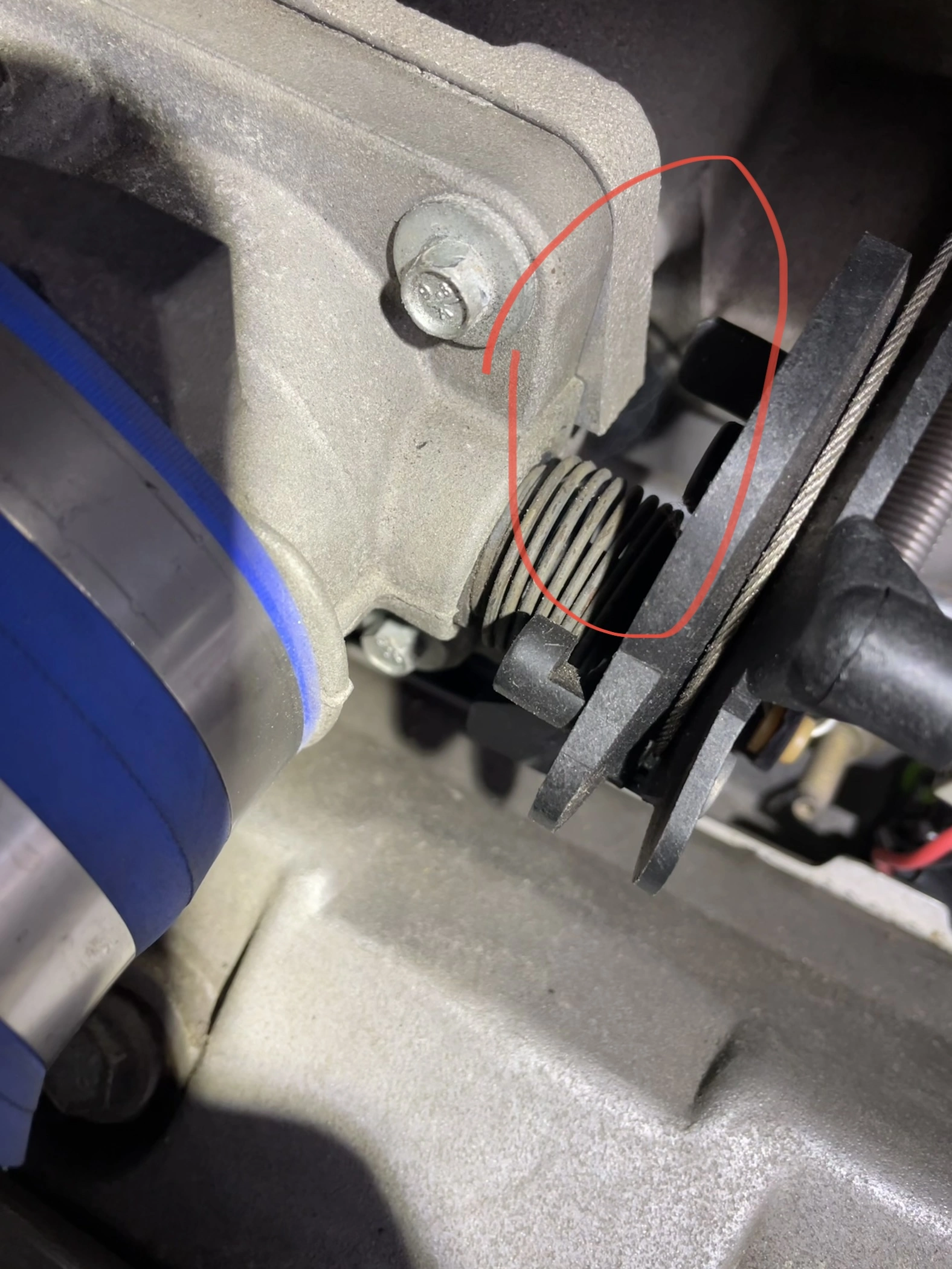

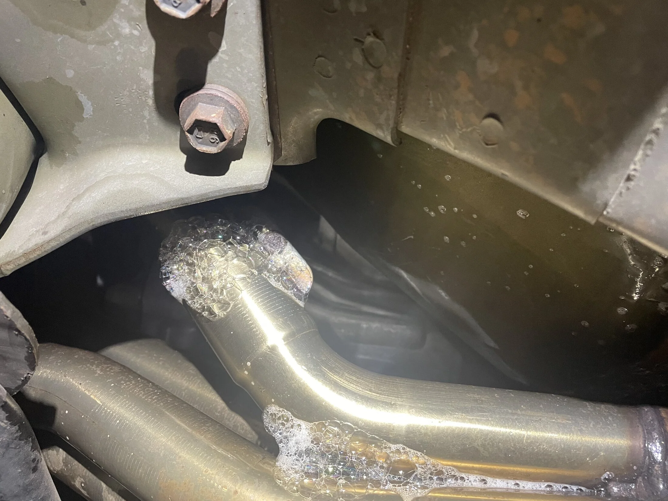

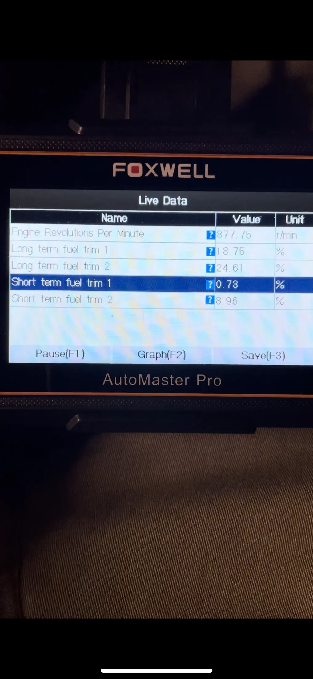

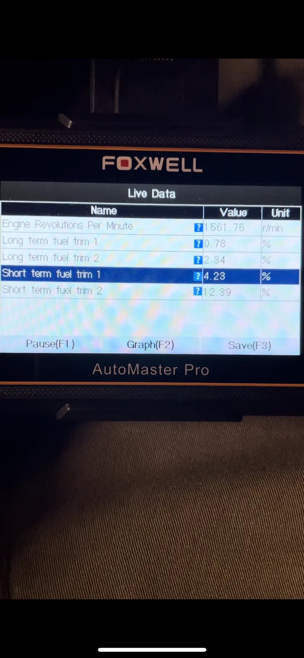

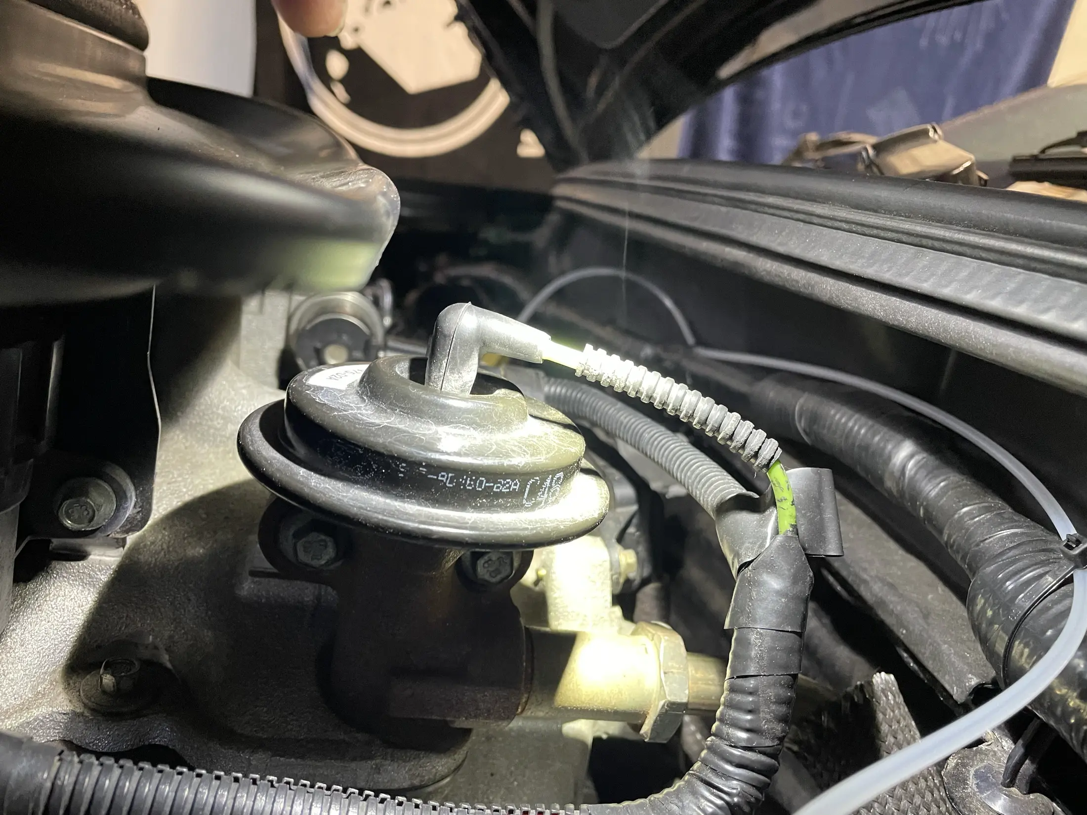

For anyone who's still following along...Something wasn't sitting right with me and since I had the intake side off the blower, I smoked it again to make sure everything was good (I bought my own smoke test off amazon) including the connections for the bypass that I couldn't see under the intake.

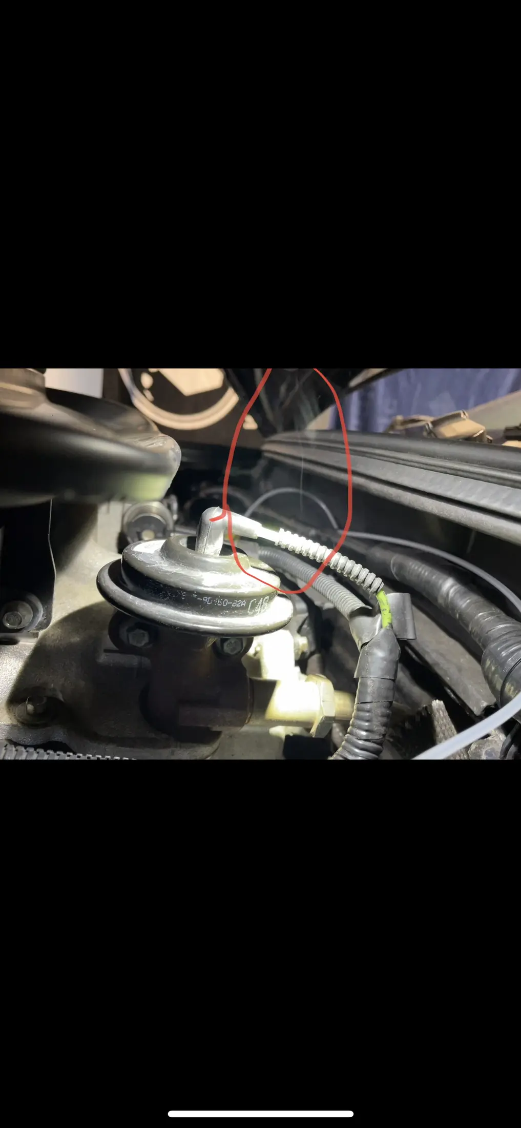

Well, I found a leak at the throttle body (tightened it down and that's good), and a small leak that comes from under the vents of the EGR. Now, the EGR ties right into bank2, so I think I found the true culprit along with many other things.
Does the EGR have to be motorcraft? Pics attached for @Noobz347 lol
Sorry the pics suck. But if I could post the Live Photos from phone you definitely can!
