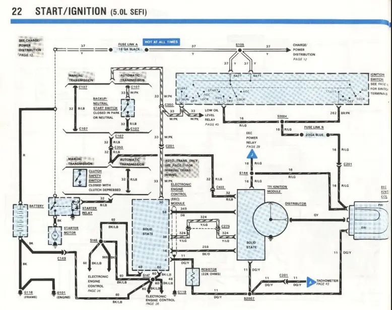

Most of the time a no crank problem can be traced to a bad connection or starter switch problem, the ignition switch is on the lower part of the steering column under the dash (not the key switch) and there are issues with the switch/wire connections going bad.
Thanks for the info. Just a quick question, would something on the starter make it so that the key won't turn over the car? Kinda new to Fords, learning a lot in the past couple months though.
No. The starter is isolated from the start circuit. It just sees power from the starter relay which triggers it to turn over.
The starter relay gets it's signal to close from the ignition switch, so if you aren't getting 12V on the red/blue wire at the relay, then you have an issue in the ignition switch, or the clutch switch or NSS is open. Is this a manual trans? If so, the failed clutch switch is common. Unplug and jump it out with a 5A blade fuse to check. I'd start by testing for 12V off the white/pink wire off the ignition switch when you turn thge key to start. If you have it there, but not at the red/light blue wire at the relay, you need to check the clutch switch and if the reverse harness on the T-5 is present and plugged in. (If the car is an AOD ill amend this statement)

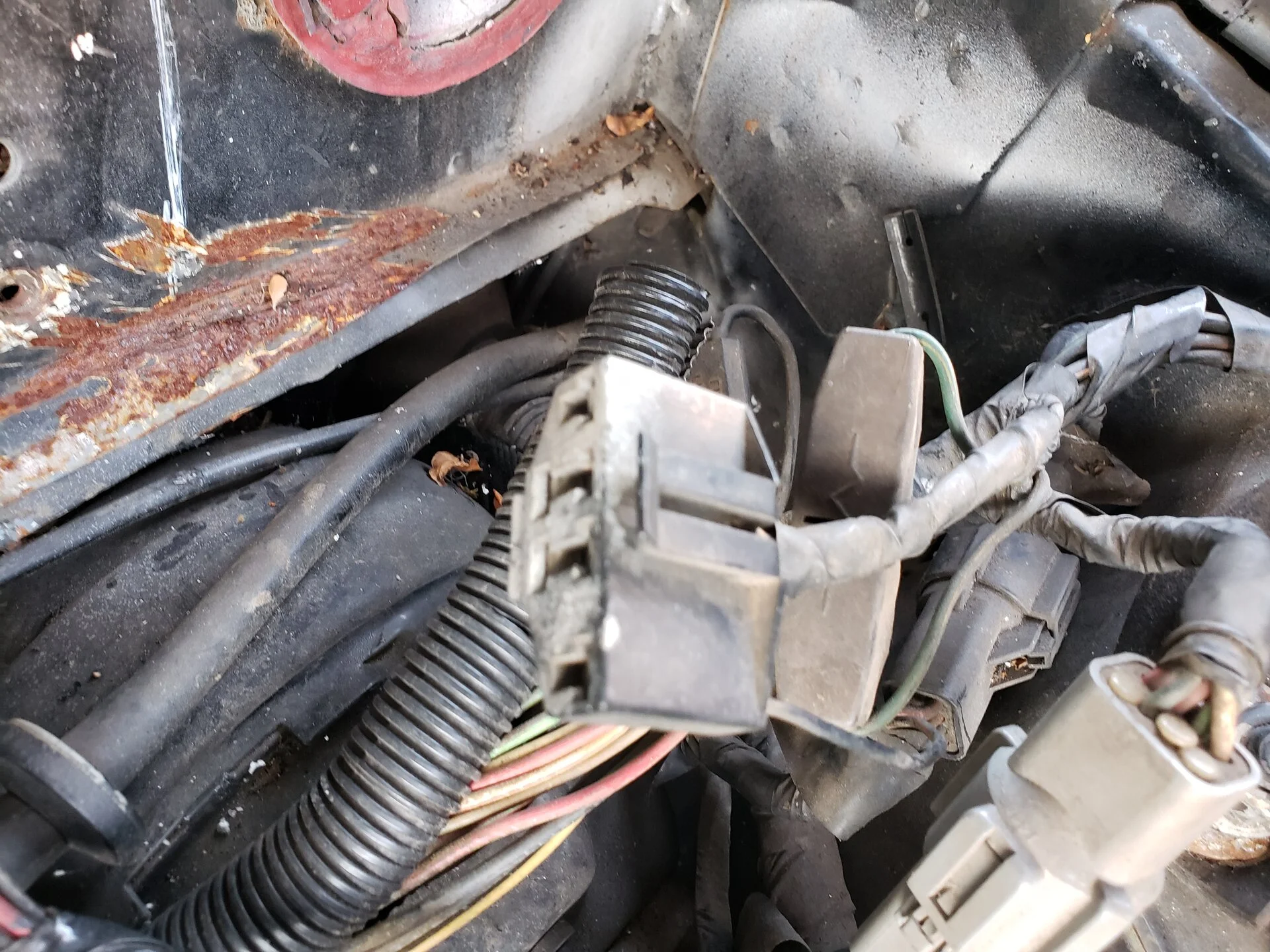

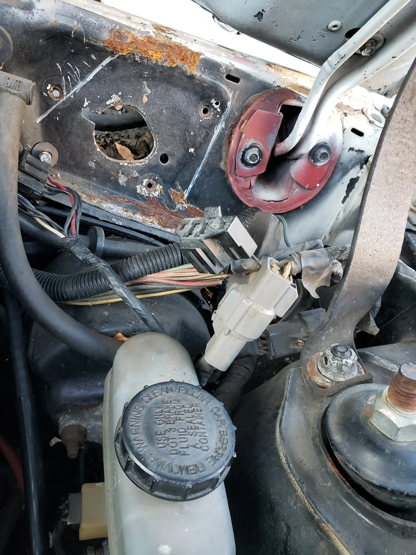

I tried turning over the car and it almost started to crank over with the key. Then nothing again. That same fuse blew again. It is an in line fuse on the wire from the starter solenoid to the starter. I read up on it a little and leaning towards a split in the wire or hole where moisture, oil or something is getting in and shorting it out. Can't get it up on jack stands until the weekend to look. Just wondering if anyone agree's.
