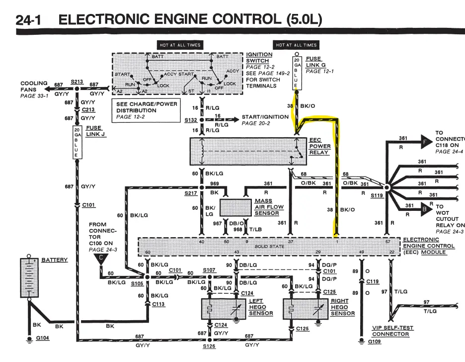

Code 15 is no Keep-Alive Memory power to pin 1. Any time you shut the car down it's essentially wiping the ECU's memory. So you won't get that code that keeps coming on while driving because it gets stored in the Continuous Memory, and that's being wiped for some reason.
Check voltage to PIN 1 on the ECU. It should always have power.
Pin 1 is fed from a fusibile link that supplies the EEC relay. It doesn't go through the relay. Really the only way this fails is if the wire goes bad or is cut or pulls out of the connector on the ECU relay.

This may help with figuring out what wires to back probe on the ECU harness. I stole this from one of jrichker’s posts.
Computer wiring harness connector, wire side
Computer wiring harness connector, computer side

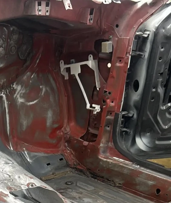

Also, picture of the ECU bracket and the ECU relay. I snagged this out of one of 95steedamustang’s posts.
Reactions: Noobz347, Mhalc1 and General karthief

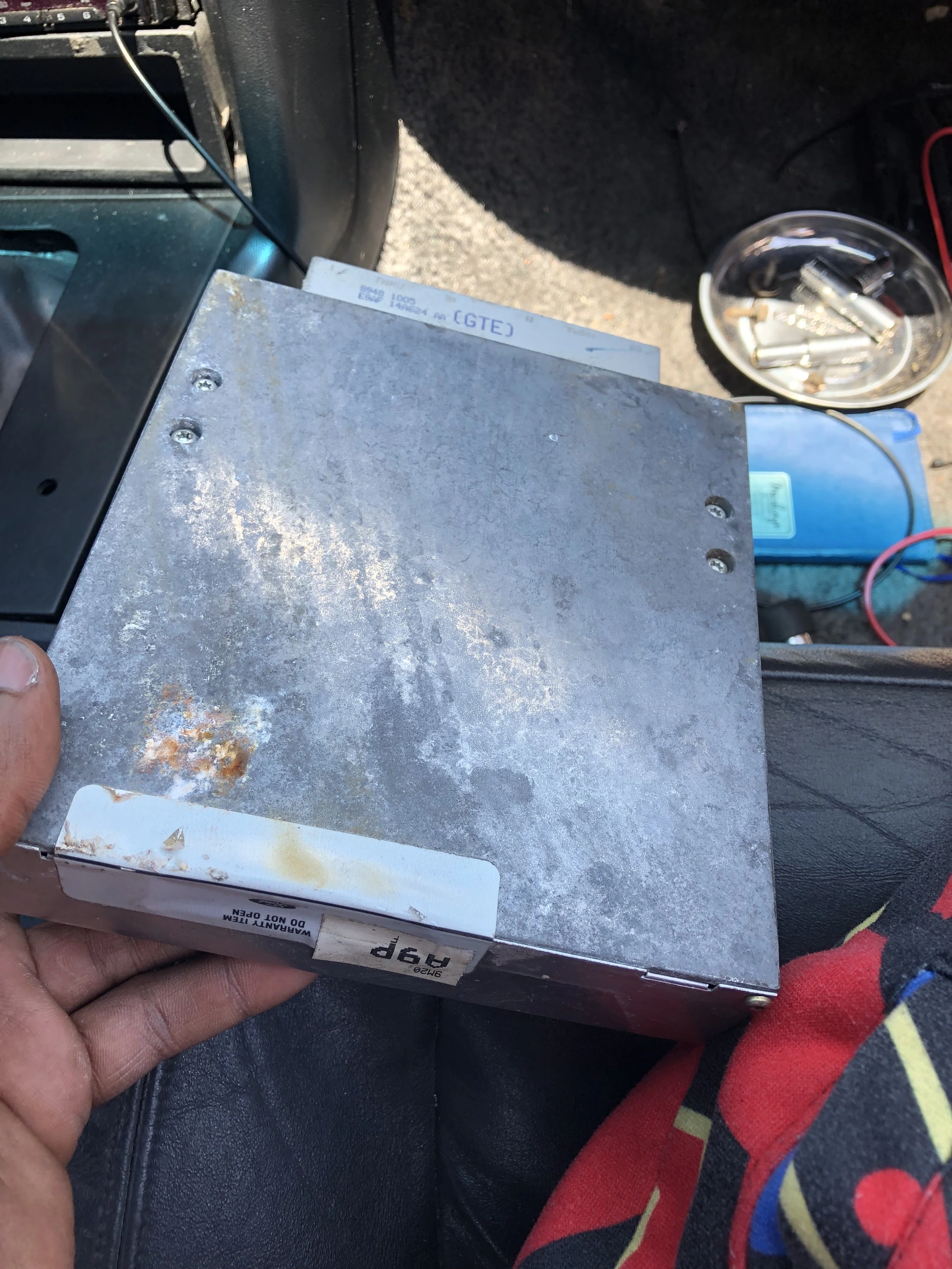

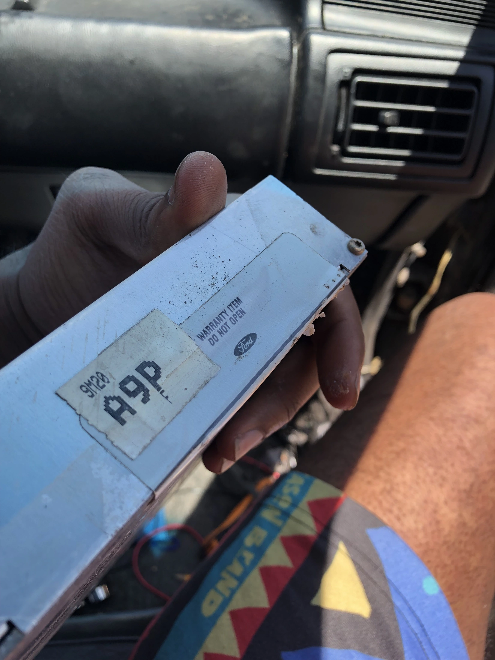

As an update I’m working on the mustang today, and ensured that the ecu does not have a chip… it in fact still has the warranty sticker still in tact. I am getting 12v to pin 1 from the connector. I believe the ecu needs servicing, it looks pretty bad, I think I will open it up and see if it’s something I can fix as the closest ecu dude is asking $350. I also need the foxbody for my daily driving during the week as my other car is down.

5-spd car with an auto A9P? You should take a peek at the o2 harness jumper and make sure it’s configured properly to match the auto ECU.

I just picked up an a3m ecu hopefully it will work plug and play… I will attempt to repair mine. It’s an auto ecu because I 5spd swapped my fox some years ago
