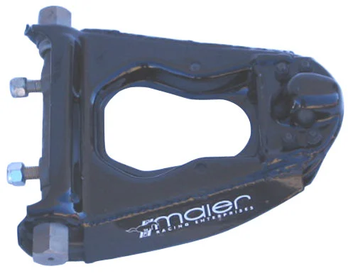

Front suspension, I'd go with TCP coilovers. By the time you pull together boxed upper and lower control arms, roller perches, and rod end strut rods, you're almost there price-wise anyway.

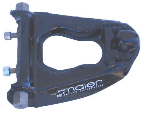

Second best, if you can weld, is to get some OE four-bolt UCA's and the Cobra Automotive brace plate and weld that on there. You need no ball joint pad realignment (Negative Wedge Kit) if you keep the Shelby drop to 1". But if you want to go to a 1.5" drop, you can cut the ball joint pad from the inboard side and bend it up ("up" meaning with reference to the ground), and weld a rectangle of sheet steel in the gap. Maier does this on its "realigned" UCA's, as you can kind of see in this pic:
You can also add the Maier bracing down the sides of the "A," as is seen in this pic.
There's also the Opentracker spring perch relocation idea, which gives your stock UCA some of the leverage advantage (i.e. that you can run softer springs) as a coil over:
Actually, what we all really need is for Opentracker to start selling his UCA with the bracing, the realigned ball joint pad, the multiple spring perch locations, the rollerized perch, correctly stiff springs, and correctly valved shocks.
Also if you're going homebrew don't forget to box the lower control arms, a la Maier Racing. But do not make the LCA's adjustable for length. Camber should only be adjusted with the eccentric. If you're worried that yours will slip, get the Eccentric Eliminator from Pro Motorsports.
The strut rods should be either the Street or Track units or the TCP.
I may be inclined to agree with you. What do you think about RRS for that matter?
I do have the equipment and ability to do this, but it falls under the "time is money" category. Not that I'm building this car to sell, but building it will take me away from working on cars that I am.
