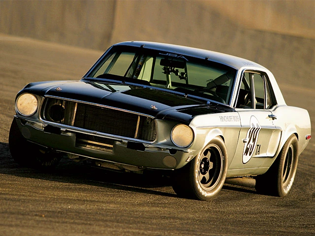

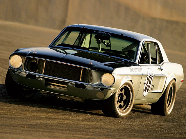

I absolutely agree, and a '67-'68 isn't cheaper, better, or more reliable. But it is a vintage Mustang, and that's what I like. I'm not building it to be the fastest or most optimal car on the track, but to be a kick-ass track car with the character only an early model can provide (IMHO).
Tell me this doesn't get your blood pumping:
