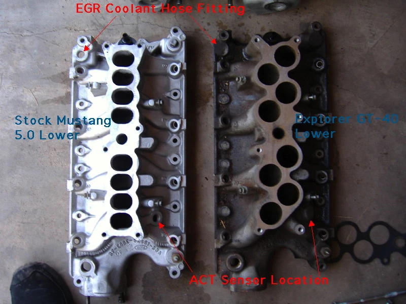

ACT is located in the #5 intake runner on fox bodies and in the Air inlet tube on SN 95's
ok I have an explorer intake on this thing I think., I know the engine has been swapped and for all I know it could be an explorer 5.0. The boss under the # 5 runner is not tapped and not drill. is there any other place I could look for this thing, a certain wire or different location. The upper intake system is in pretty rough shape on this thing, I have a nice used gt40 unit upper and lower from an explorer on the way. the manifold that I'm getting has the number # 5 drilled and tapped,but I don't even know if I have the sensor on this engine, or wiring harness. lol ... or maybe not..
Thanks
If they never tapped the #5 runnter then either the ACT is either in the rear lower passenger side return bung for the EGR coolant hose (assuming that is not connected and they tapped that pad in the intake) or the ACT sensor is laying on/under the upper intake. If you look at the explorer intake on the right, notice it is not tapped for the ACT in #5 and the EGR coolant line not tapped.

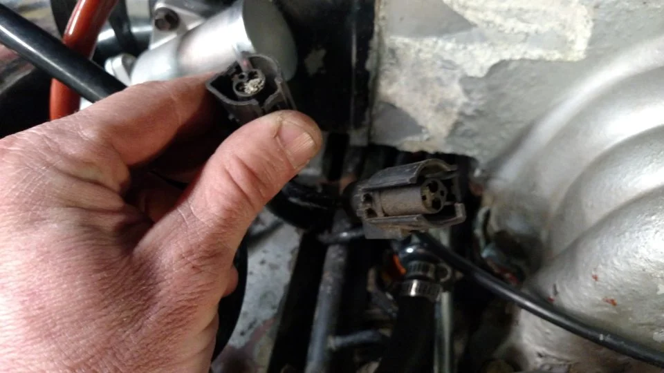

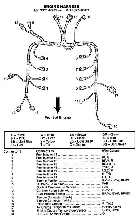

Look for the plug #17 off the driver side injector harness

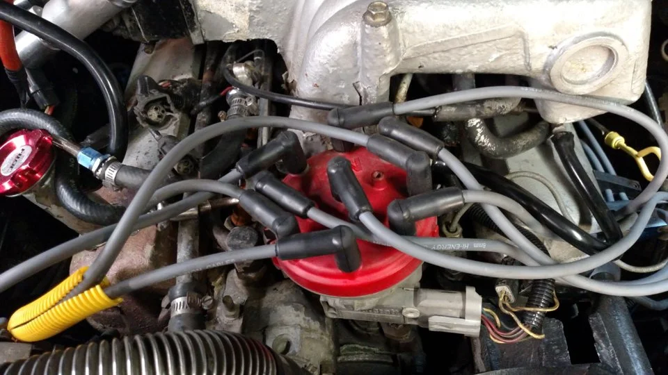

Also in not sure if this is a HO motor, is there a way to tell?. It looks like my plug wires coincide with the non HO diagram. But I may be mistaking, I just want to give all the information I can to get the problem resolved.

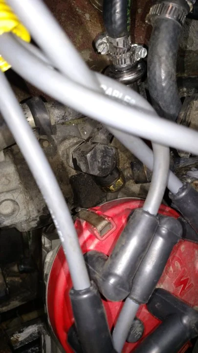

Pic of distributer if it helps..lol
Also 2nd pic I'm holding my ECT plug, what's the one next to it?..
Thanks.

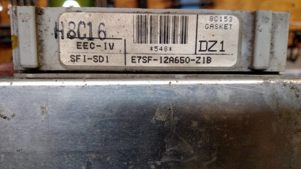

I am waiting to repair the ATC before I do anything else.its just weird that before I had the mishap the car ran decent, now its really bad...lol so just in case I do need a computer I want to be prepared, would a 87/88 5 speed work? I posted a pic of my computer for reference above...
