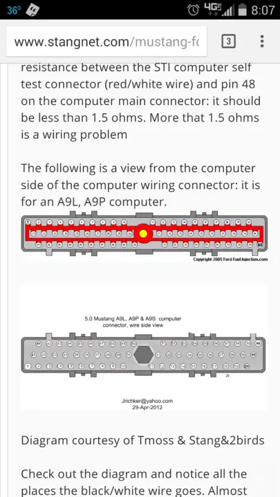

It should be about 5 spots from the side of the eec connector.
I sent a pic of the wire I think it is, but it doesn't coincide with the wiring diagram that I got above from another member. am i overlooking something, I must not have the pin in the right place to test. I'm getting frustrated ,lol
appreciate all your help, tell me if it's me being an idiot. any other steps so I can take?. Lol
There should be one wire that still has 12v. That will be number 1. Drop down to the bottom row. Then go 5 over. That should be 45.
Ok, so on the diagram its #45, bottom row 5th from the left right?
If so,I'll try again tomorrow..:)

Yes, the signal wire should not change colors! LoL! Ask all the questions you need. The better you understand, the better you're results will be! And the faster you will learn!
Ok. Thank you. I will test again tomorrow and report back after work. If I can't get a ohm reading on the signal (green/black stripe) what's my next approach?
Then you would fix or replace the wire. Depends on what you find.
Ok, on my brake i tested the map sensor resistance at the green/black wire ( I keep my car and work on it in my garage at work ;) ). I was on the rong pin on my computer harness. I am getting 0.02 ohms from my green/black wire from my map sensor harness to pin #45 on the computer harness.
Could the map sensor be bad?

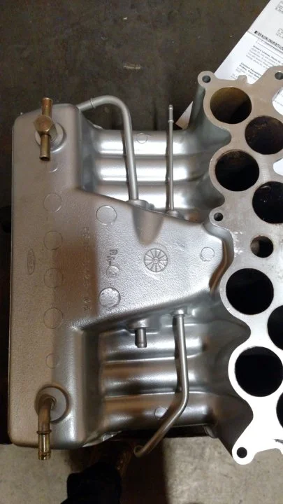

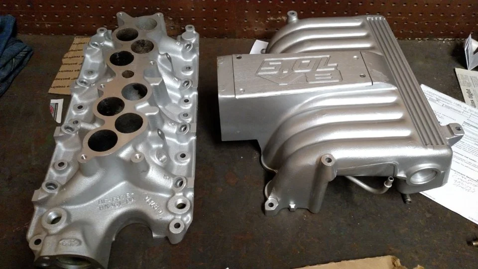

Where exactly do all the vacume or whatever lines go? I don't trust the previous owners hafe ass job and want to get it right the first time, lol.
