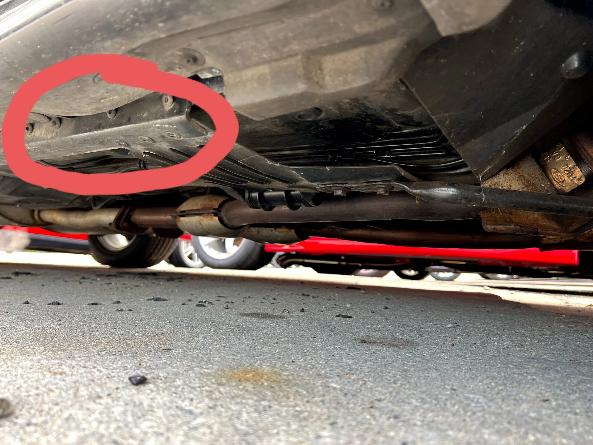

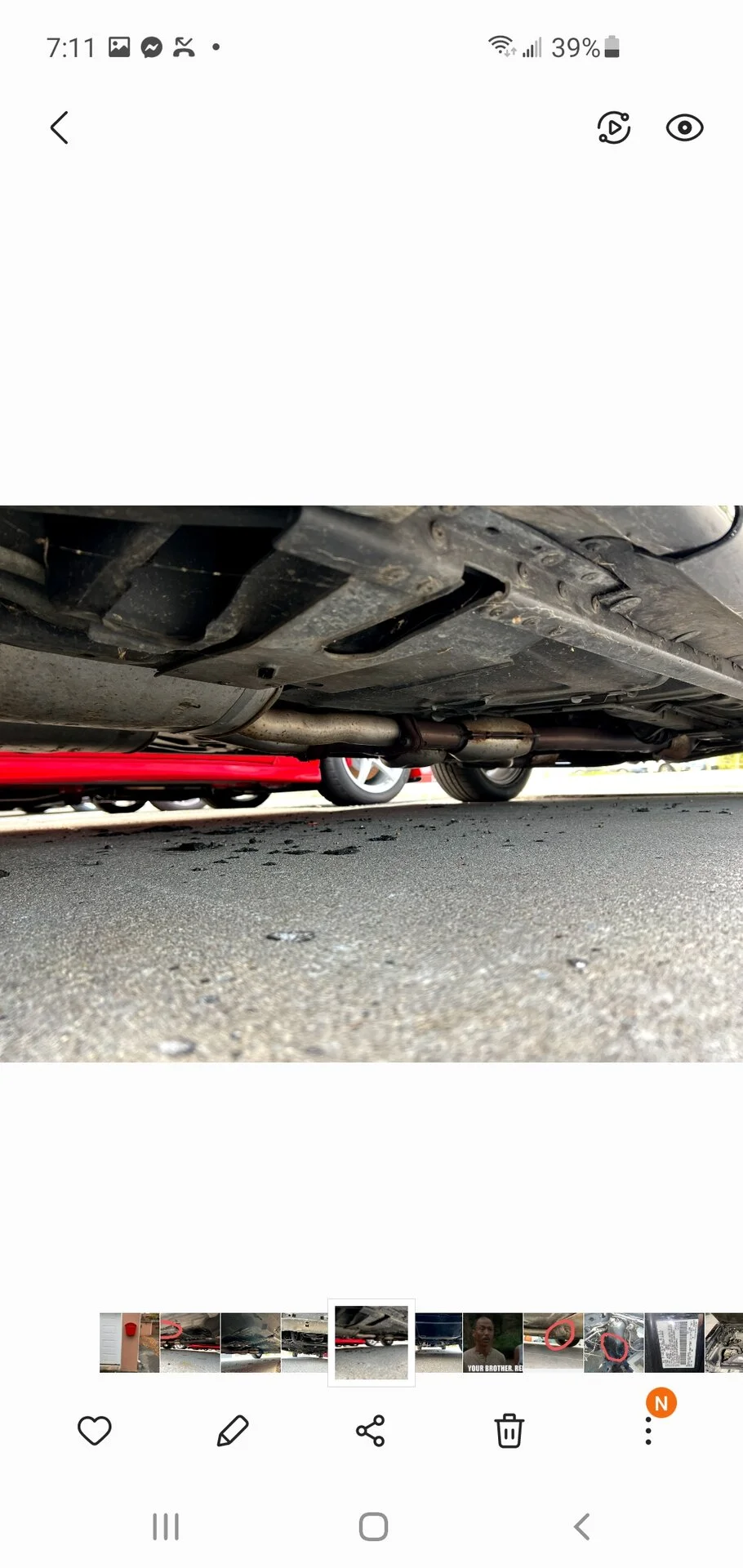

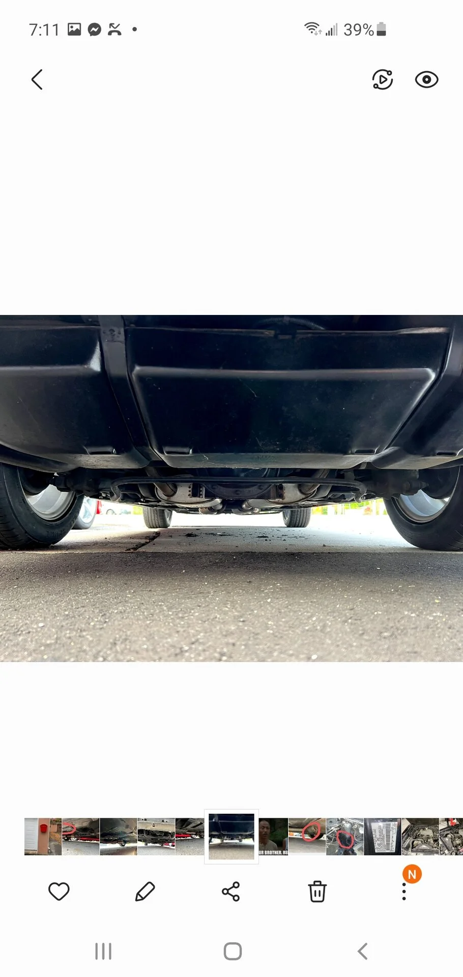

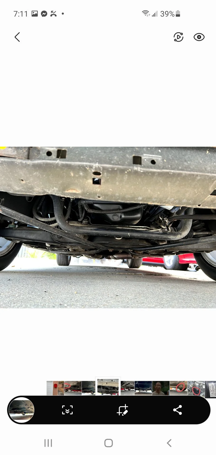

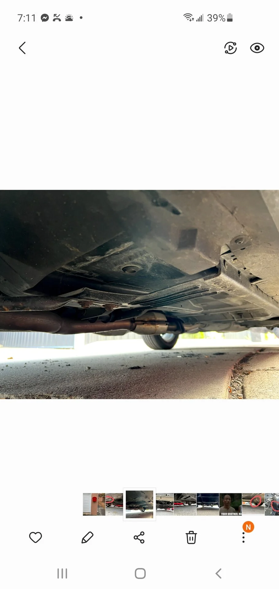

Im looking to buy a low milage (26000 miles) 93 gt vert. The seller sent me pics of the undercarriage, what do you think? Anything out of the ordinary?
Take a look at the black metal frame, i circled an area in red. Is this normal for it to have all these black rivet spots?
My 91 vert does not have this.
Thxs for the help!

Those rivets are twisted a little and loose. Either someone tried jacking it up from the brace or something hit it. It's not a hard thing to fix. Doesn't look like anything major happened there.
It's been a long time since I've seen a lower core support look that good. It's missing the air deflector though. LMR sells them.
