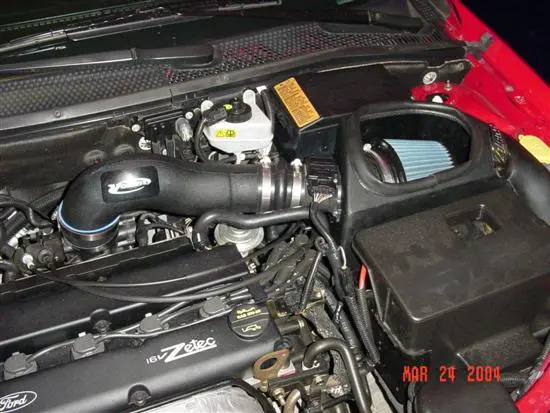

I have used quite a few different CAI setups on my 99 including several custom versions, but what I have always really wanted and couldn’t have is a high performance "Plastic" CAI kit, but no vendor has ever made one to fit the 99-01 Cobra’s, and very few if any for other model years. Seems logical that Ford made it's stock CAI out of plastic to reduce heat absorption so why are all other vendors making theirs out of metal, ceramic coated or not? (dunno) Anyhow, I happened across Volant Performance website (http://www.volantperformance.com ) and noticed they had a kit listed for 96-01 Cobra/Bullitt (#19946C). Questioning this since these two engines are very different I called to discuss. At the time the tech support was confident it would fit according to their designs. I purchased it and it doesn’t fit a 99-01 Cobra. It was designed for the Bullitt or 96-98 Cobra which has an angled throttle body inlet and intake and they were not aware of the design change for 99-01. After discussing the situation with them they very nicely offered to develop a new CAI kit for the 99-01 Cobra’s. Being the experimental and squeaky wheel I am, I should be the first official customer to take delivery of the final product. The bad news is it will take a couple months to get to production. I still have the incorrect delivered kit here and I would like to say it is very nicely made, in fact the best CAI I have ever seen for our Cobra’s (yes the WMS is nice also, but metal). It looks like they put some real thought into producing a kit that flows more cold air and reduces heat absorption while maintaining a great look and fit like stock at a decent price. The following link is a picture of the GT version which is similar (but different). I have seen a few threads throughout the boards asking about this product, but apparently I was the first to try it and bring this to their attention so I just wanted to share in case others are interested. When I do get the final product delivered and installed, rest assured you’ll get the scoop on it. For now, don’t buy the advertised kit for 99-01 regardless of who tells you it’ll fit, because it won’t. And in good faith I appreciate the fact they are going to make an effort to develop a correct product for the 99-01 group which tends to get less attention than other model year Cobras in the after market world. As I have seen a million times, if a good product is offered to Cobra owners, it’ll sell itself in droves when word spreads about it.
The one in that picture looks nice but did they say anything about one that will just have an open air element to reduce costs? Thanks for taking the time to get them on making a product for us 99-01 owners.
They didnt mention however I suppose it's possible, but that would defeat the concept of "cold air". I know you can install the "boxed" kit without the box but that doesnt help on saving $$. They did mention trying to incorporate a larger air filter. To early to tell, they are only now in earliest stages. I am suppose to get updates from them as they progress. They are suppose to have a 99 Cobra and a Mach 1 in this week to begin design and fit for each.

Yes, material and visually it is similar to the stock airbox without a doubt, but it is designed to flow more air than the stock airbox, as is the duct from the MAF to TB. That is the name of game. More air and keep it cool. Everything else is not relative regarding a CAI.
missouri_guy197,
The filter is not huge, but it is no smaller than the filter you get with a DenseCharger, WMS, MAC, etc kit that goes into the fender. In fact any kit that goes into the fender is limited because the filter can be only so big to fit into the fender. The filter in the kit I received does not have a front inlet like a S&B PowerStack filter, only side like most. You can use any aftermarket MAF you want as long as it's designed to fit the same as the stock MAF (flange). For instance I use a Pro-M 87 bullet which I have used with the stock box, WMS elbow, home made straight into the engine compartment, and I plan on using it with this. In fact it's at Pro-M right now being recalibrated for this configuration as I write this. Oh, BTW, during my conversation with Volant they mentioned adding a larger filter for the Cobra version. Also filter size doesnt always mean it flows more, and sometimes too much flow is too much depending on whether or not the engine is setup to handle it.

The air filter this Bullit kit came with is a AFE universal big mouth filter. I emailed AFE for the CFM of this filter. Granted this isnt the correct kit for the 99-01 Cobra's so it probably wont apply when the correct kit is made, but gives a good reference point. I was able to fit my S&B Power Stack = 1272 CFM into the air box, so that would be more than enough air flow :rlaugh: I may end up doing some experimenting with this kit minus their PP and use my own. I have some good ideas now after thinking about this and examining the kit for a week :banana:
Volant claims their air boxes and ducts are made from a material called "X-Link Polyethylene" to insulate from conducting much less heat than metal systems. Well, again my curiousity got the best of me.....I positioned a hair dryer on high and pointed it towards the airbox on the side that would normally be closest to the engine when installed. Over the course of several minutes I took several temperature readings using my Raytek AutoPro (automotive laser thermometer) on both the outside and inside of the airbox at the exact same spots directly where the hair dryer was pointed. The inside point was a constant 40F cooler than the outside point. Considering the material is only like 1/4" thick (if that) I think 40F is a significant difference.

OK, got the one month update today from Volant. They got a 99 Cobra test car in with a STB installed (dont know which brand STB) and got a design fitted. Appears the lightning owners buy the Volant kits but had to drill extra holes in the airbox to allow more air to enter the box as the engine sucked up the airbox air quicker than it could replenish from the opening into the fender. So Volant is making the 99-01 Cobra airbox much larger with a larger filter. For the filter; instead of the old 3.5" diameter inlet x 6" length for the GT/Bullitt and older Cobra, they are using a 4" inlet diameter with a 7" length and a better flowing material. The duct from the MAF to TB will also loose one of the 90 degree bends found in the stock duct to straighten the path out some. This kit will also fit the Mach 1 and will have an optional piece available to attach the shaker scoop for additonal air like the stock Mach 1. I was told they would send me the filter CFM as soon as they decided exactly which filter they would use. The ETA for this product is mid June as of right now. Could be sooner or could be later.
