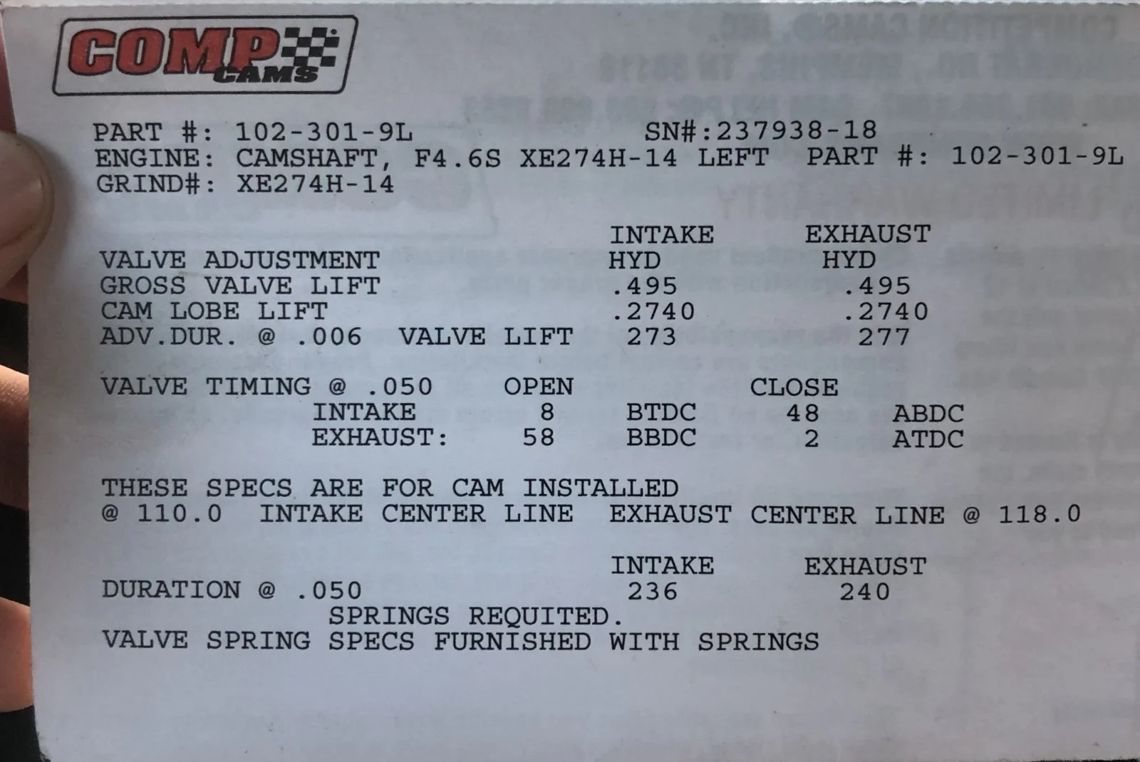

Hey thanks for the reply. Apologies for delayed response (work kinda owns my life/free time) Yeah we’re doing SCT with the prp software. I’m well aware this is pretty much rocket science for me right now but I’m eager to learn! I was told by the seller that it needed bigger injectors and that’s something I’ve been exploring, I think I found some 80lb injectors on summit racing, I’m gonna go with those, the MAF is stock as far as I know. I read into that, looks like it’s a good idea to grab an SCT big air MAF.
As far as compression ratio, I’m not sure what the compression ratio is but I’ll be running 93 octane. The cams are comp cams, car came with a specs card *attached* . Honestly have no idea what those numbers mean *nervous laugh*. I finally got my tuner communicating with the computer so I’ll be doing some data logging after work today. Just wanna see how the engine is doing with this, I guess “base” tune. I’ll share that datalog later today
