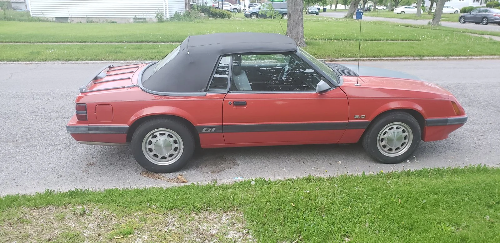

Hi I am new here, I have an 86 convertible gt. it's a dog when it comes to get up and go. so I was thinking of doing a nice engine build on it. starting with a dart block the biger bore cant remember if it's the 4.135 or somthing. that way I can use the 337 stroker crank and biger pistons so it comes out the the 347 stroker with out the long throw of the rods. also thinking of trick flow heads. now the reason for being here is I have no idea about fuel injection or injectors ect. I am all right with putting a carburetor motor build together but this is new territory to me. I called the shop that I will have do the build BRT performance. bill did my 496 strocker for my 1967 442. He asked what i was looking at doing and what kind of HP i was looking to get out of it. well i wouldn't mind maybe going with a pro charger or somthing that didn't cost as much. since I wont be running a lot of boost any way. sorry for the long intro and if I got any of the info wrong. I guess I am looking for some good ideas and direction.

That car you pictured is obviously dead stock, right down to the 10 hole wheels...why are you just now deciding to dump money in it? Did you just buy it?
With 20 k to spend, there are so many cars out there that have twice that or more invested in them that can be bought for less than you'll ever be able to build it for.
