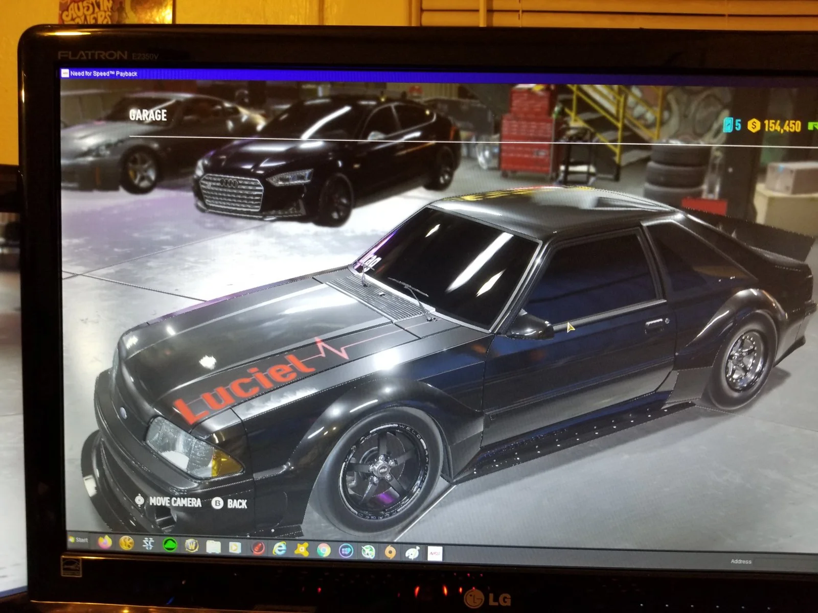

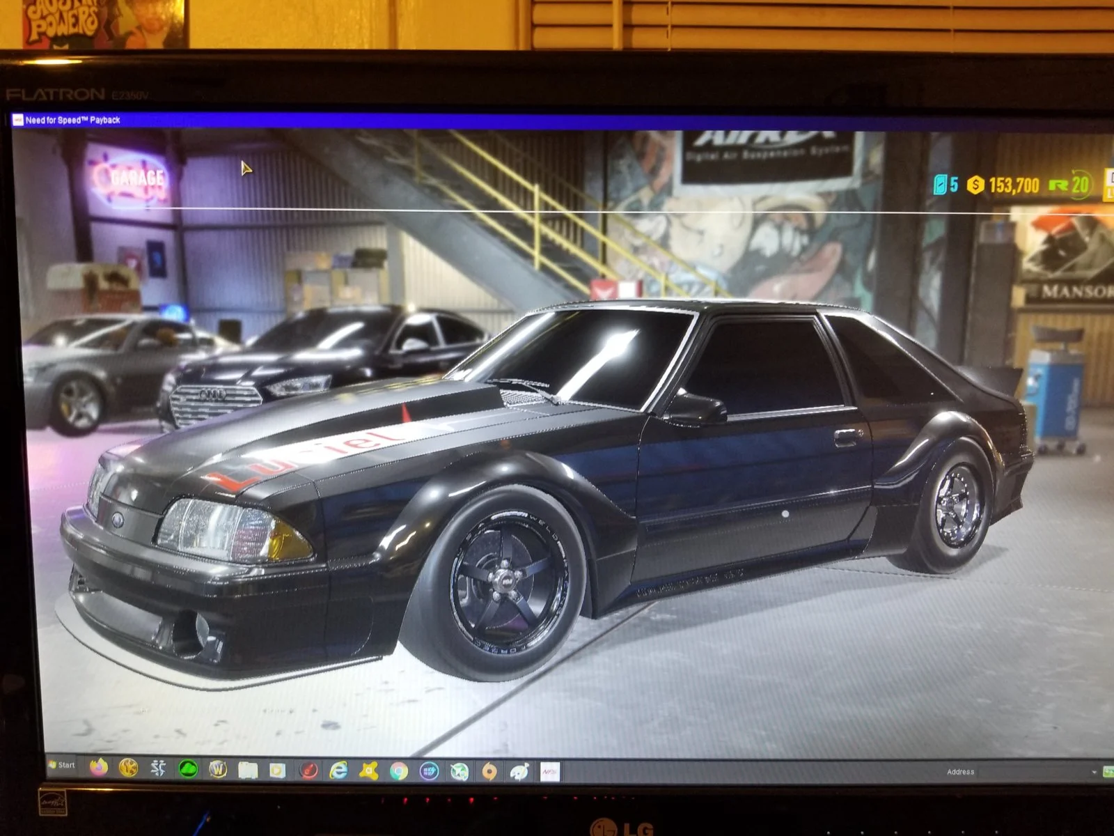

I forgot to add I'm planning on doing an Air Ride for this build.
I know many fox owners hate that but I live in NJ and do not want to kill my underbelly, but still want to ride low...
With that said, clearance shouldn't be an issue.
