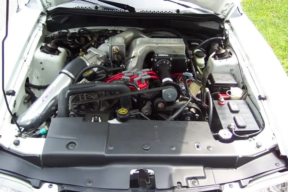

copy the anderson n/a powerpipe design
What does it do in the fender? Does it drop down or what? Got any pics from inside the fender?
