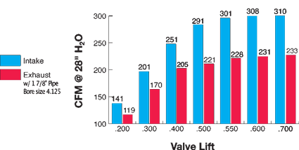

Well i just put a bid on a set of new 205's... If i win they will be shipped for 1500.. Anybody else feel free to bid, this is one of those if i win well good but if lose, its probalby better off deals.
I know some of you said these aren't big enough but for the price i will live with it. They have to be better then those twisted wedge heads on it now. 2.08 intake valves and 1.60 exhaust. max lift of .670

If i win this auction my new plans are to sell the TFS R intake, injectors, TB, MAF, and fuel rails and buy a 351 spyder intake to go on it. I need to find out if the ports will match up in size with the 205 heads... Also plan on running about 6500-7000 rpms... Im really starting to get into this now.
