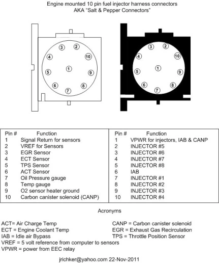

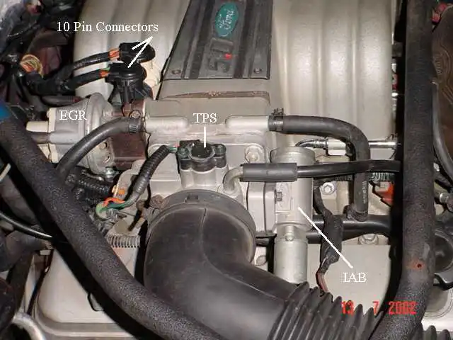

See the graphic for the location of the 10 pin connectors:
See the graphic for the 10 pin connector circuit layout.
The injector power pin is the VPWR pin in the black 10 pin connector. [/b]

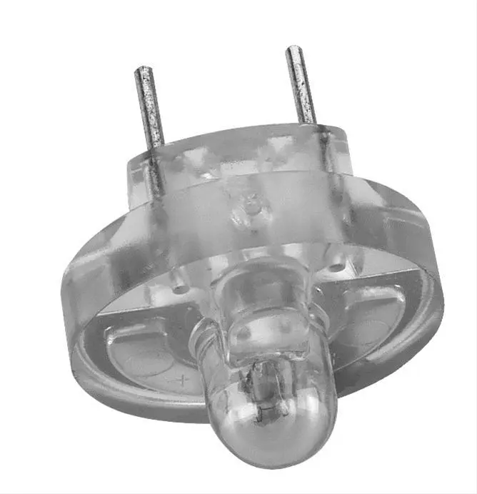

2.) Get a noid light from AutoZone or other auto parts store, or even better a set of them.
This one is from http://www.summitracing.com/parts/oes-25142?seid=srese1&gclid=CMXk7M6dmM0CFdgOgQodGUMHWQ and costs about $6.
3.) Use the noid light to determine that the injector pulses and isn’t stuck in the on position.
It you have a set of them install all of them and compare the pulse intensity. Install the noid lights, turn the ignition switch to Run and crank the engine. A light that doesn’t pulse and stays on has a short to ground in the computer side of the circuit. That can be either a wiring fault or a failed computer.

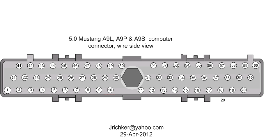

If this is the case, remove the passenger side lick panel and disconnect the computer connector.
There is one 10 MM bolt holding it in place. Pull the connector all the way out of the computer so that you can see the computer side pins.
Disconnect all 8 fuel injector connectors from the injectors and leave them disconnected for steps 4-6.
Use the list from the graphic below to find the fuel injector pins for the injectors that didn’t turn the noid light off.

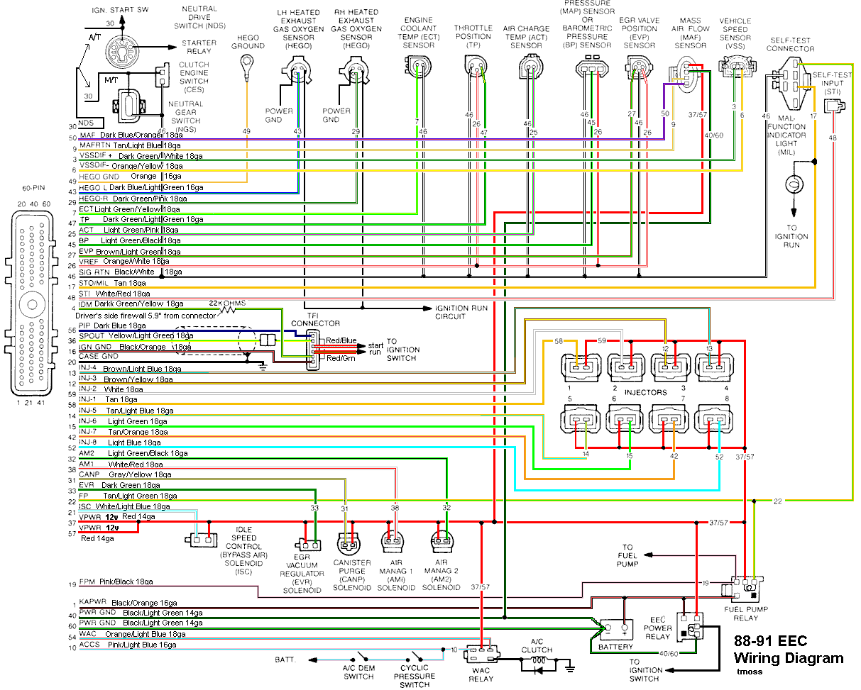

4.) Set the multimeter to low scale Ohms and measure between the computer ground located below the computer and the suspect fuel injector pins. You should see greater than 100 K Ohms resistance. If you see less than 100K Ohms, the wiring between the injector and the computer has an internal short to ground and needs service.
Check the harness and look for damage, kinks or frayed spots. A short to ground would result in an injector that never turned off.
5.) A single noid light that never turns on is either a wiring fault, or a failed computer. Either the injector has no DC power or the computer or wiring has failed and cannot switch the injector circuit to ground. Determine if the injector has power by using the multimeter to check for 12 volts on the red wire on the suspect injector connector. No 12 volts and you have a wiring fault.
If none of the noid lights flash and you have 12 volts at each injector, check to see that you have good spark. Before you even think about replacing the computer, see step 6.

Check the harness and look for damage, kinks or frayed spots. Check the 10 pin salt & pepper shaker connectors for bent pins, corrosion and damage.
Next check the fuel injector wiring for open circuits. Set the multimeter to low scale Ohms. Each fuel injector has a red wire (power) and a non-red wire (computer controlled ground).
Inside the car, take a short piece of 14 gauge bare wire and jumper it to the ground below the computer. Use the computer wiring diagram and select one of the injectors. The recommended procedure is to start with cylinder #1 and test each injector in numerical sequence 1,2,3, etc. Then stick the ground wire into the computer wiring harness socket for the injector you want to test. Don’t forget to move the ground inside the car each time you test a different injector.
Under the hood, set the multimeter to low ohms and ground one of the test leads to the engine block. Then measure the resistance between the non-red fuel injector wire in the fuel injector connector and the meter ground on the engine block. You should see less than 1 Ohm. More than that means a bad connection or bad wiring.
The 10 pin connectors are the first place to look for problems when it fails the above test.
Engine side testing Unplug the black 10 pin connector from its' mating half. Use the 10 pin connector diagram in this tech note to locate the injector you are currently testing. Measure the resistance between the non-red injector wire and the injector pin on the engine mounted side of the fuel injector harness; you should see 1 Ohm or less. More than that indicates a broken wire or bad connection.
Body side testing Use the 10 pin connector diagram in this tech note to locate the injector you are currently testing. Again, the black connector that is connected to the car body side of the wiring harness is the one to use for this test. Make sure that you test the injector pin for the wire side of the computer wiring harness pin that you grounded. Ground one lead of the multimeter on the engine block and check the resistance; you should see 1 Ohm or less. Test all 8 injectors in numerical sequence, and move the grounding wire at the computer wiring harness inside the car each time you test a different injector.
6.) Use an ohmmeter set on the low resistance scale and measure the resistance of each injector across the two contacts inside the injector electrical connector. You should see between 11-16 ohms. More or less than that is a bad injector. Next, measure between either one of the contacts and the metal on the injector body. You should see greater than 100,000 ohms. Don’t hold the metal probe tips with your bare hands when you make this measurement; It will give incorrect results if you do.
