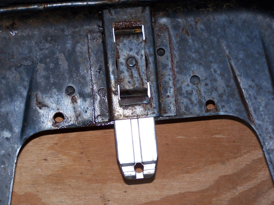

Ho do you remove the head rest's on a GT

is this from an LX. Mine dosn't slide up and down. Do I go from the back side of the seat or the front.

Well I just tried again and I cannot get thees dam things off
It sounds like you are doing about as well as I did on the first side. Are you using a screwdriver up the back side of the seat? That's how I had to do it and I couldnt feel what was supposed to move since it was seized. I got my hand up there to feel things out (up the seatback guys. :D ) and then I knew where to put the screwdriver.

Roland69 said:
I'm about to scrap this whole idea and through theese dam halo's out
Dont give up - I was frustrated too. I dont consider myself inept but I was humbled by the one side (side two took 30 seconds - I kid you not!).
I go them. I didn't know I had to reach up and towards the front of the seat. I was tryin to find the clip on the back side of the seat lol. Yea the 2nd one took less than a minnute. The halo's look way better than the huge GT ones
