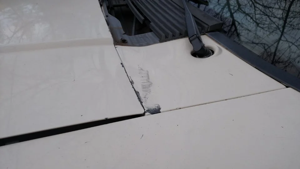

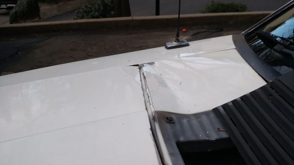

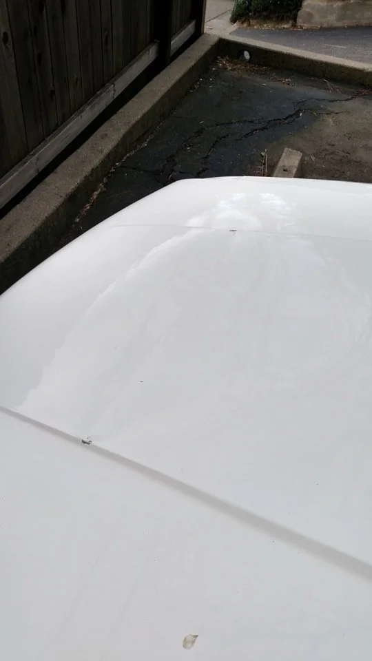

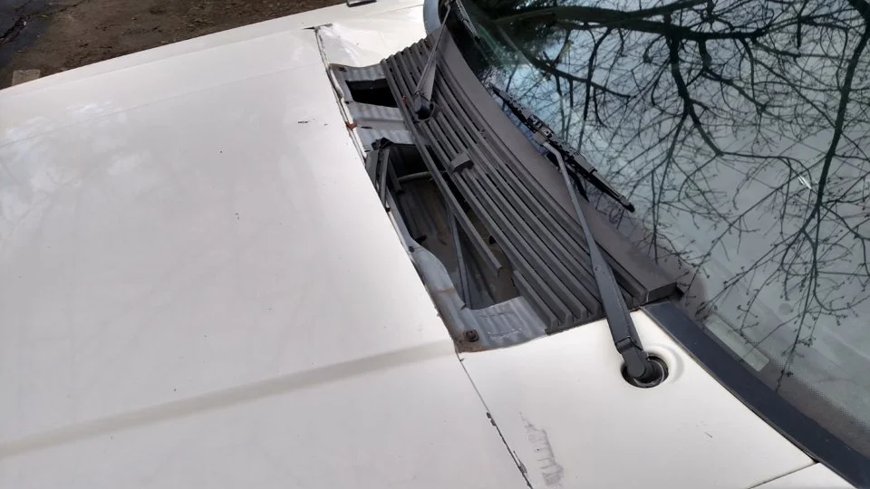

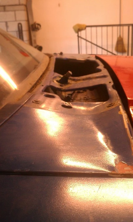

Here is the sadness

Oh yeah, that's gonna need surgery

A good body shop can fix it with a stud puller and some body work skimming. A cowl hood would've done more damage. No reason to replace the whole cowl. That top sheet metal actually goes behind the windshield where it spot welds to lower portion. Its way more involved to replace the whole cowl. A good body man could fix it and paint the upper cowl. Sucks man but at least you didn't crash when it flew up.

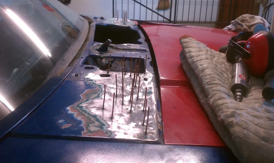

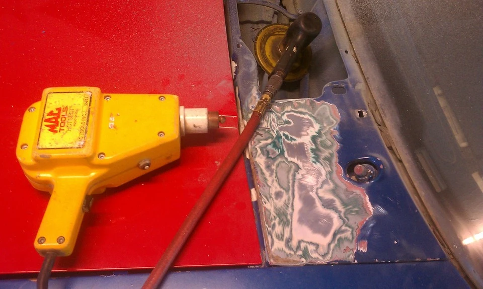

No cutting or welding needed. I'll dig up some pics that shows what's needed like @90sickfox said about a puller. I had the same damage on my old T-top 5.0

Here you go. Just sand the area down to the metal, use a stud welder to weld the studs on in the deepest parts of the dent, do only a few at a time, use a slide puller gently to pull the dents up, weld more studs as necessary until surface is mostly flat. The rest is smoothed with a hammer and dolly. The very center part where the wiper is poking out of can easily be pulled up by hand.
