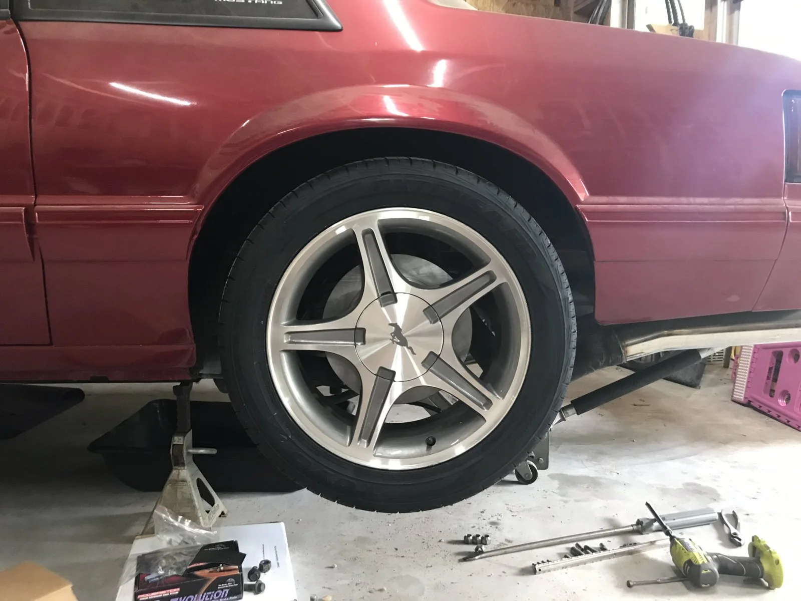

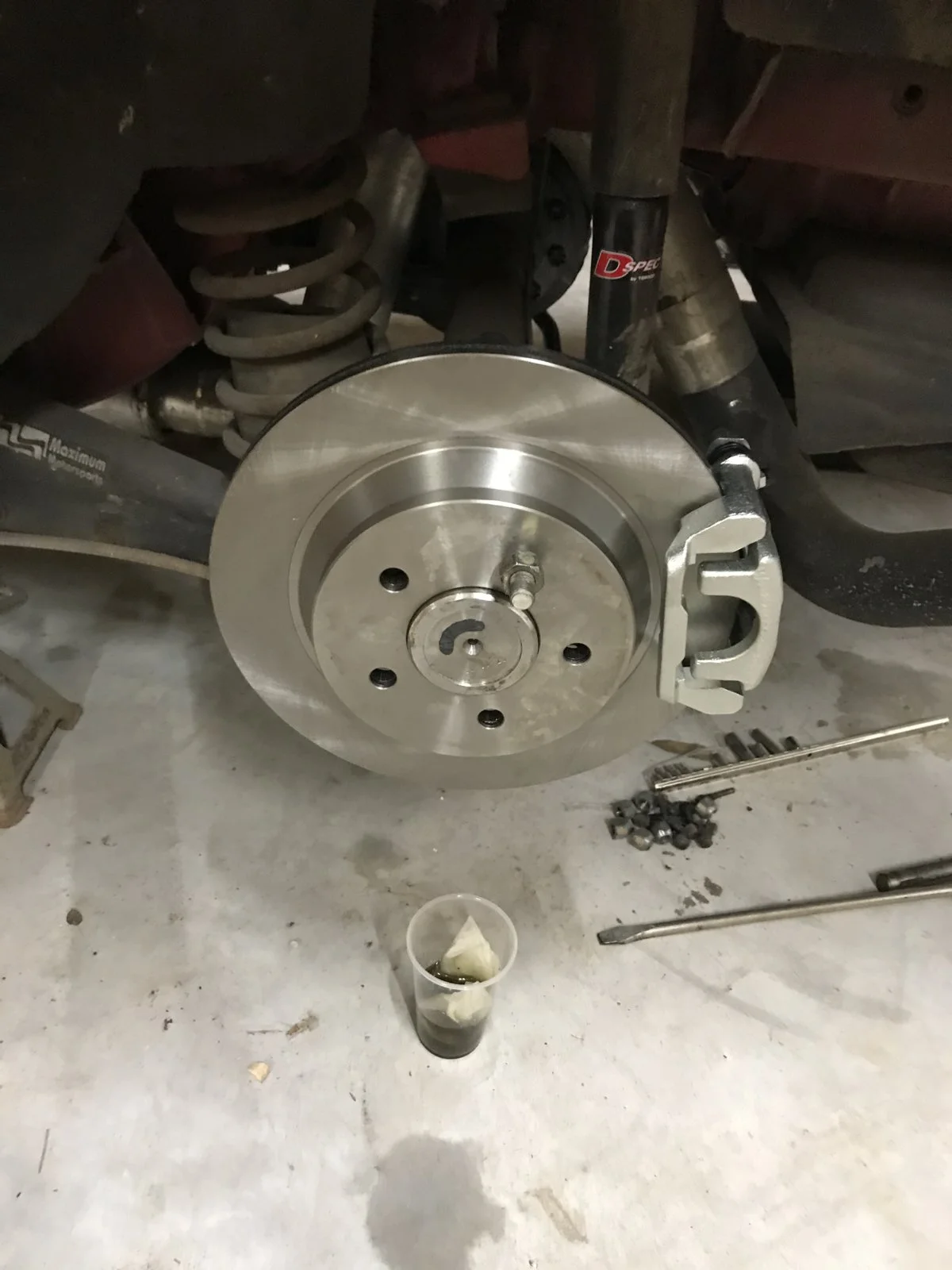

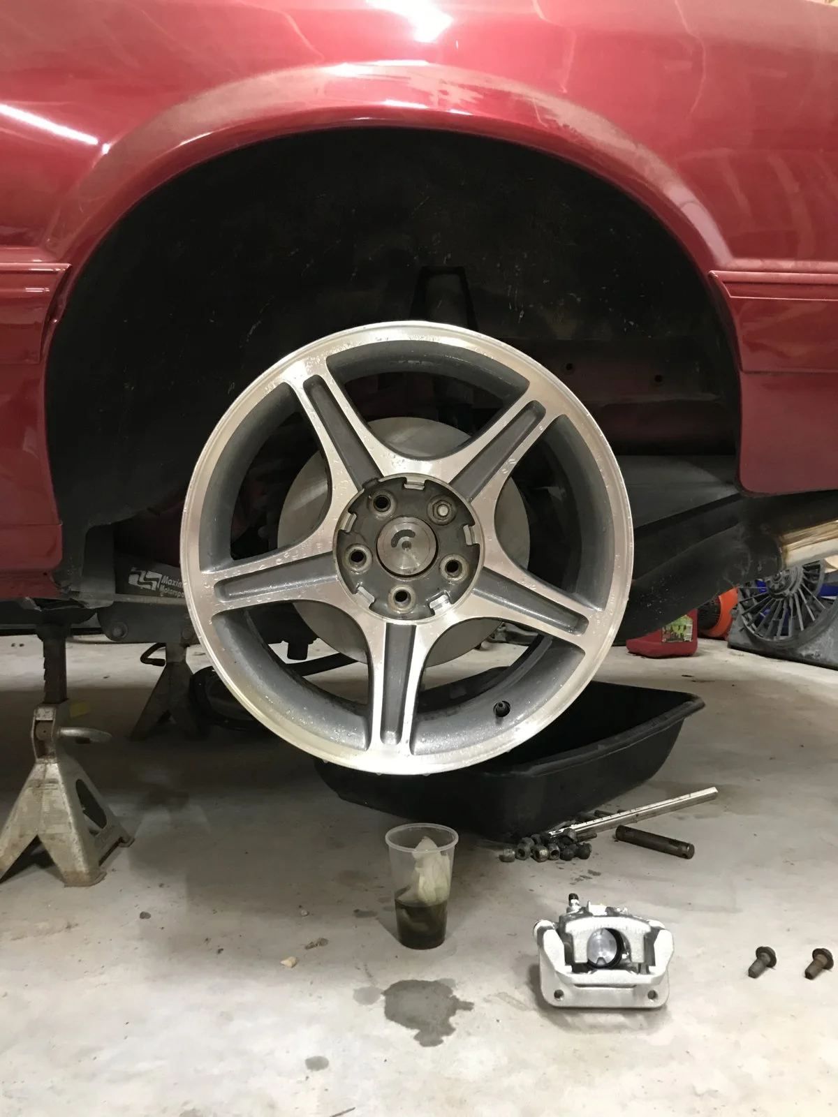

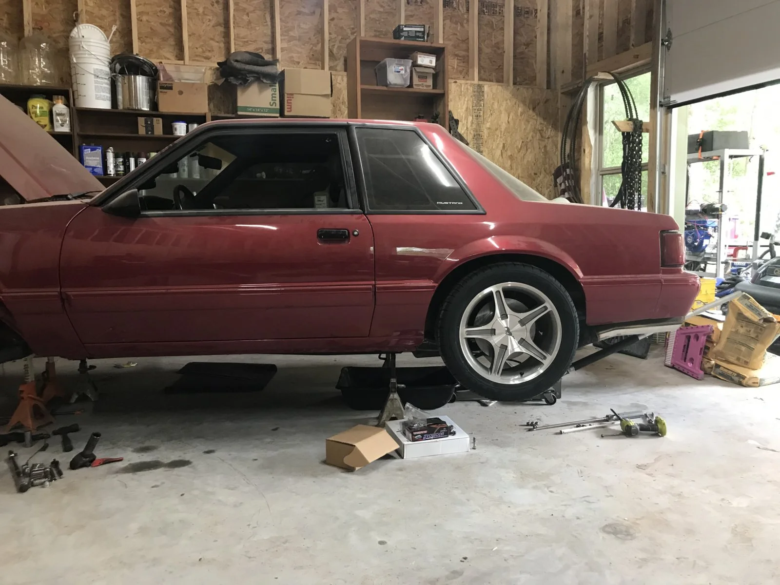

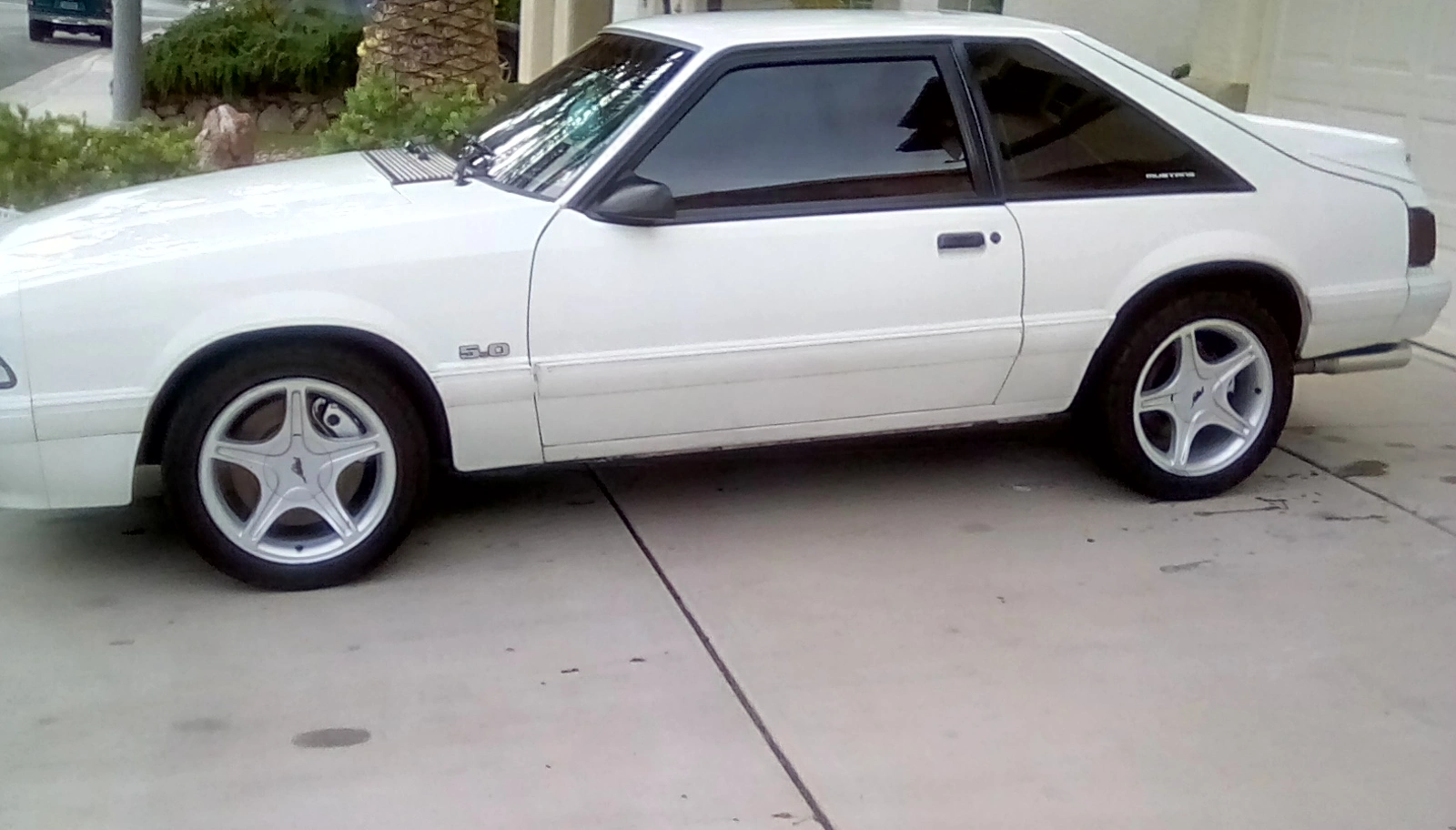

hoopty5.0 said:
It's happening again.
A moment of weakness and I broke my self imposed rule of "one project at a time".
The car has been collecting dust waiting on a clutch. As such, I've been getting the classic car itch and have been in FO mode at work cruising classifieds for 6-7 hours. In the midst of all that, I still desire to upgrade the fox's rolling gear, and I finally found a set of wheels that fit several criteria:
- Cheap
- 5 lug
- quasi-uncommon on a fox
- free of rash
So, I listed the wheels/tires off the fox for $300 expecting to give them away for $150. Within 5 minutes, I had 3 cash offers for full price and they were gone. Whoops.
So anyway, I make an offer at $180 for these ultra-clean 35th anniversary wheels and the dude accepted:
So now, I've got to convert to 5 lug. I think I'm going to initially poor boy it and buy the 5 lug kit with drums from LMR for $260 and some Mark VII discs for the front - just to keep it off the jacks and driving. The woodwork side hustle is getting busy and that means $$$ coming in.
sometimes you gotta go cheap,if it gets you going.I needed 17 inch rims to get mine rolling after cobra brake upgrade,I found rims/tires for 350 and offered $200 he accepted and...

Apr 18, 2020
#523
  • Apr 18, 2020
  • #523
When I first spotted those on a fox mustang I was kinda like ehhh, but they are growing on me.

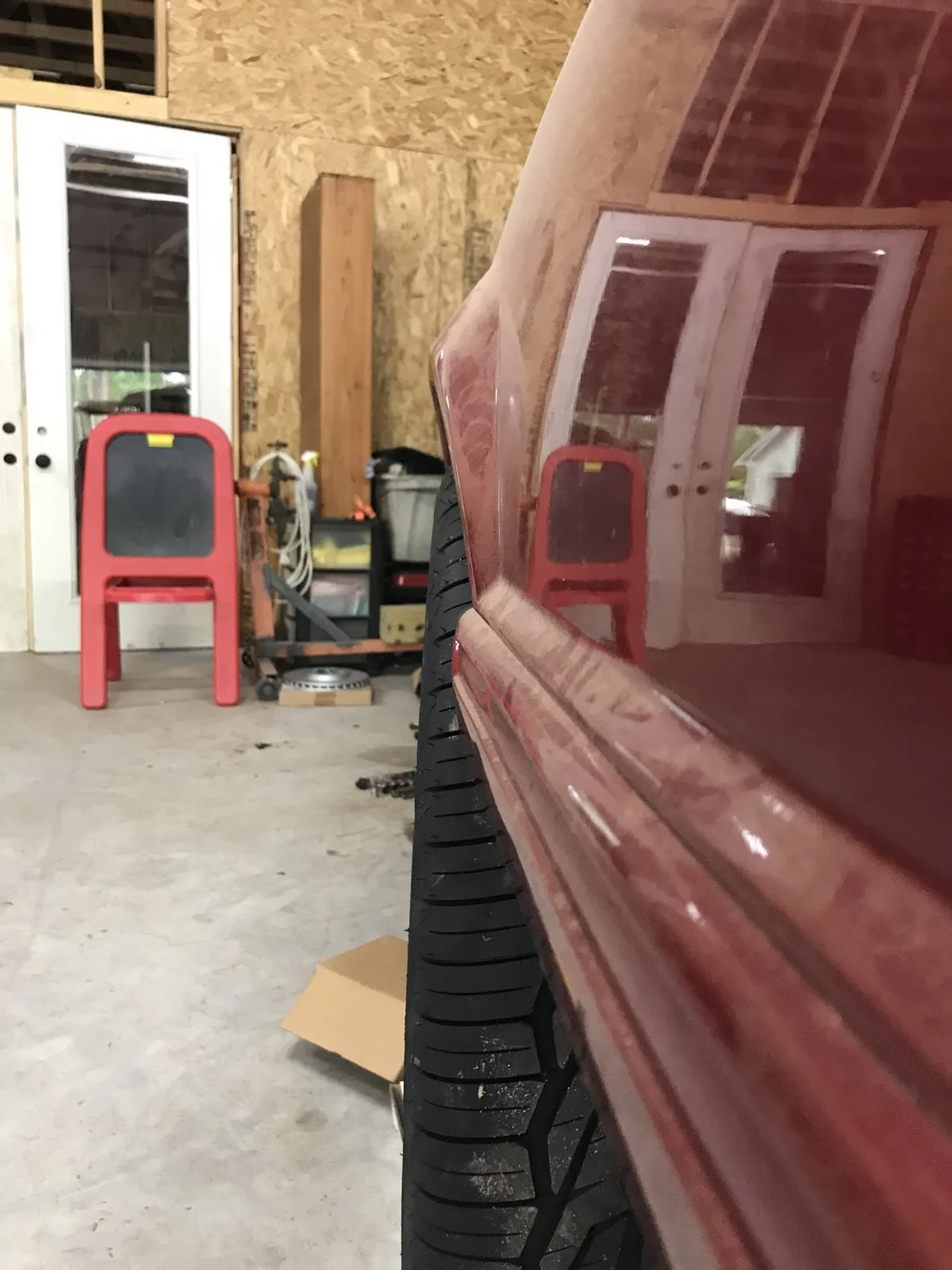

@Mustang5L5 _ I have a quest for you, should you choose to accept it. Figure out how to get the fkn dust seals out of the caliper. I can't find anyone online taking these particular calipers apart. I'm on the verge of damaging one of them so I left it alone.

Mustang5L5 said:
Ill see what I can find

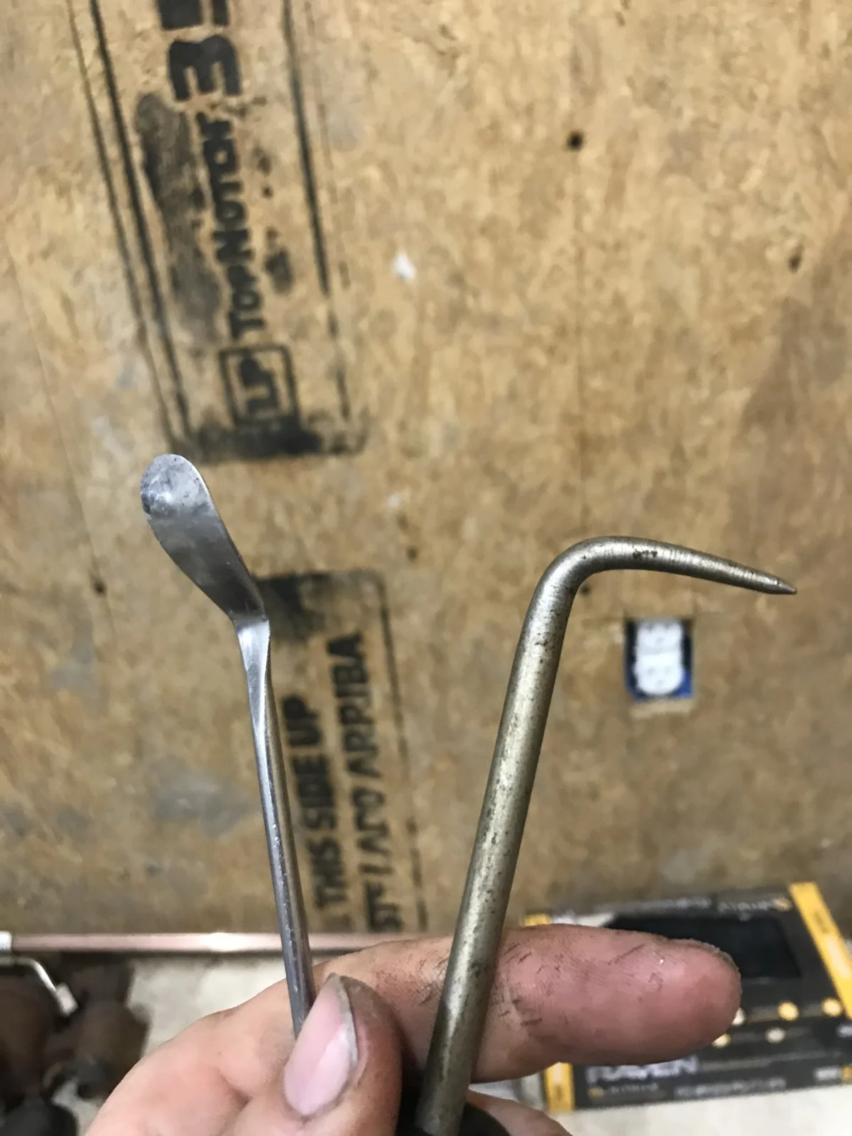

After many attempts, i finally got it. You’ll need these.

Mustang5L5 said:
What in the tarnation
first you blow the pistons out with compressed air.
Second, take the spatula and dig the seals out from the outermost edge of the rubber
Third, take the pic and dig out the O ring.

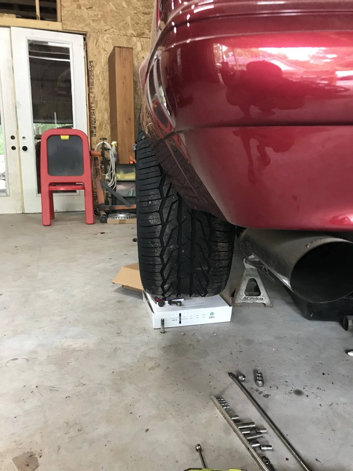

CarMichael Angelo said:
What’s with the VW tires on your car? Where’d you get those skinny ass tires anyway..Chuckies chick-n-peen discount tire emporium?
They’re 275s you crazy honky. I guess just the angle or the donkey dck 3” tail pipes making them look small

Mustang5L5
Mod Dude
Feb 18, 2001
43,309
18,018
224
Massachusetts
Apr 22, 2020
#540
  • Apr 22, 2020
  • #540
Nice looking wheel combo.
You seem to be missing those piston pushing thingys that make the car stop.
Reactions: TOOLOW91 and hoopty5.0
