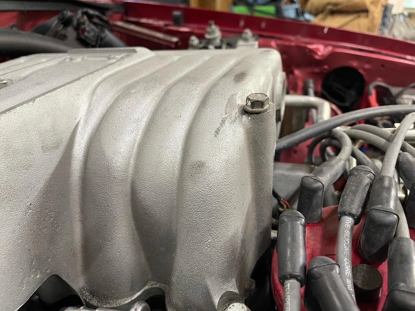

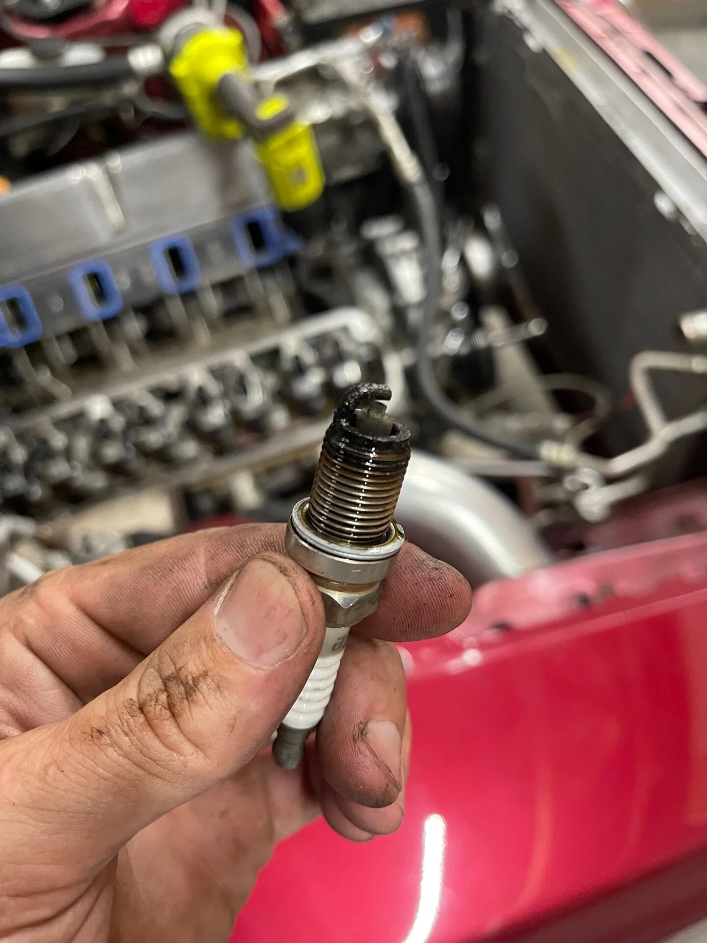

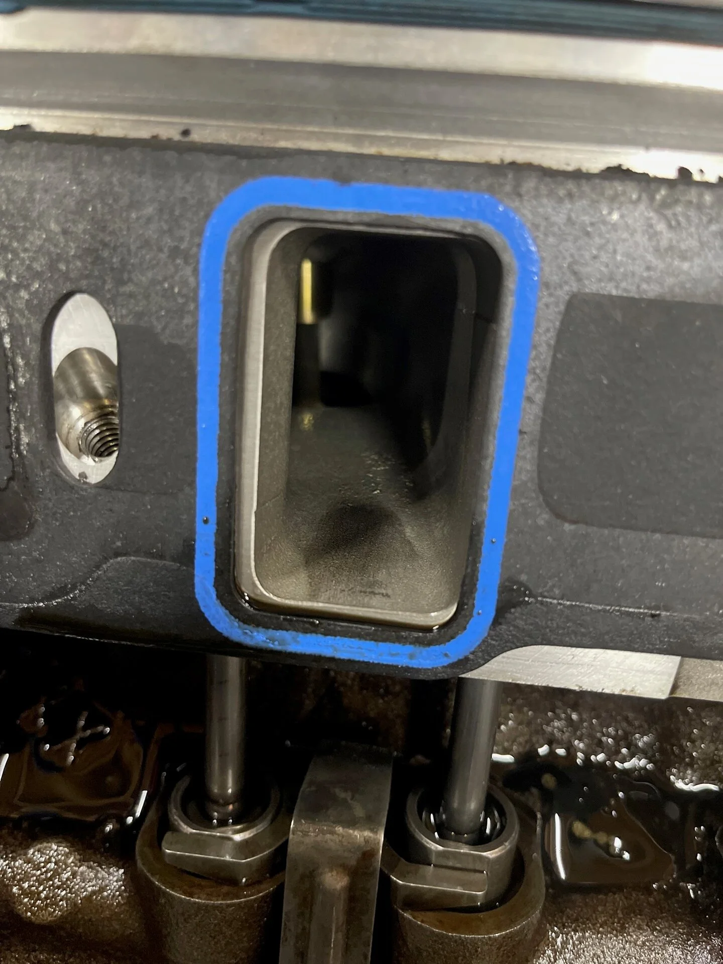

Well, I didnt realize it had been since February since I had updated, but the car was smoking pretty bad when driving. I probably have 100-ish miles on the car since the head swap and this past weekend a lifter started making noise so I pulled the motor apart last night. I was still pretty sure the seals in the turbo were bad and causing the oil burning/smoke, etc. Which, to be fair, was an illogical assumption since none of these issues were present before the swap.
Anyway, Here's what I noticed:
Notice the bottom of the intake port: oily! I think that the intake wasn't torqued down enough (side note - all the bolts were loose and I never re-torqued them after the initial install, whoops.) so oil was getting sucked in and causing all of my issues.

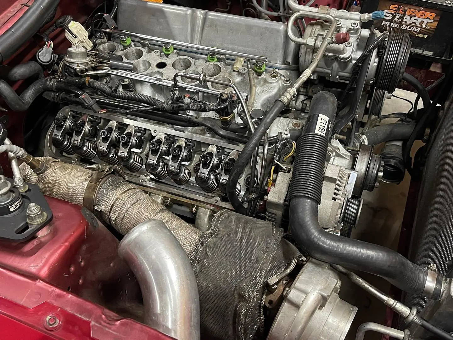

So on to the lifter making noise - Once the intake and valve cover were off, I noticed the #1 exhaust lifter wasnt pumped up. So, I figured that was my issue. For grins, I primed the motor with a drill and ran the sump dry within a couple of seconds. Mind you, the oil feed line for the turbo was open and draining directly into the drain line since I pulled the turbo off. But still, shouldnt run dry that fast. So, in the 100-ish miles I've driven the car it managed to burn a s--t load of oil. The flat lifter did pump back up, BTW.
So, I'm at the point now where I'm going to drain the oil, add new sauce, RTV the intake and torque it down, then re torque it down, and hope like hell that fixes all the issues, and that I didnt cause any other more serious damage. Never saw the oil pressure gauge move though.

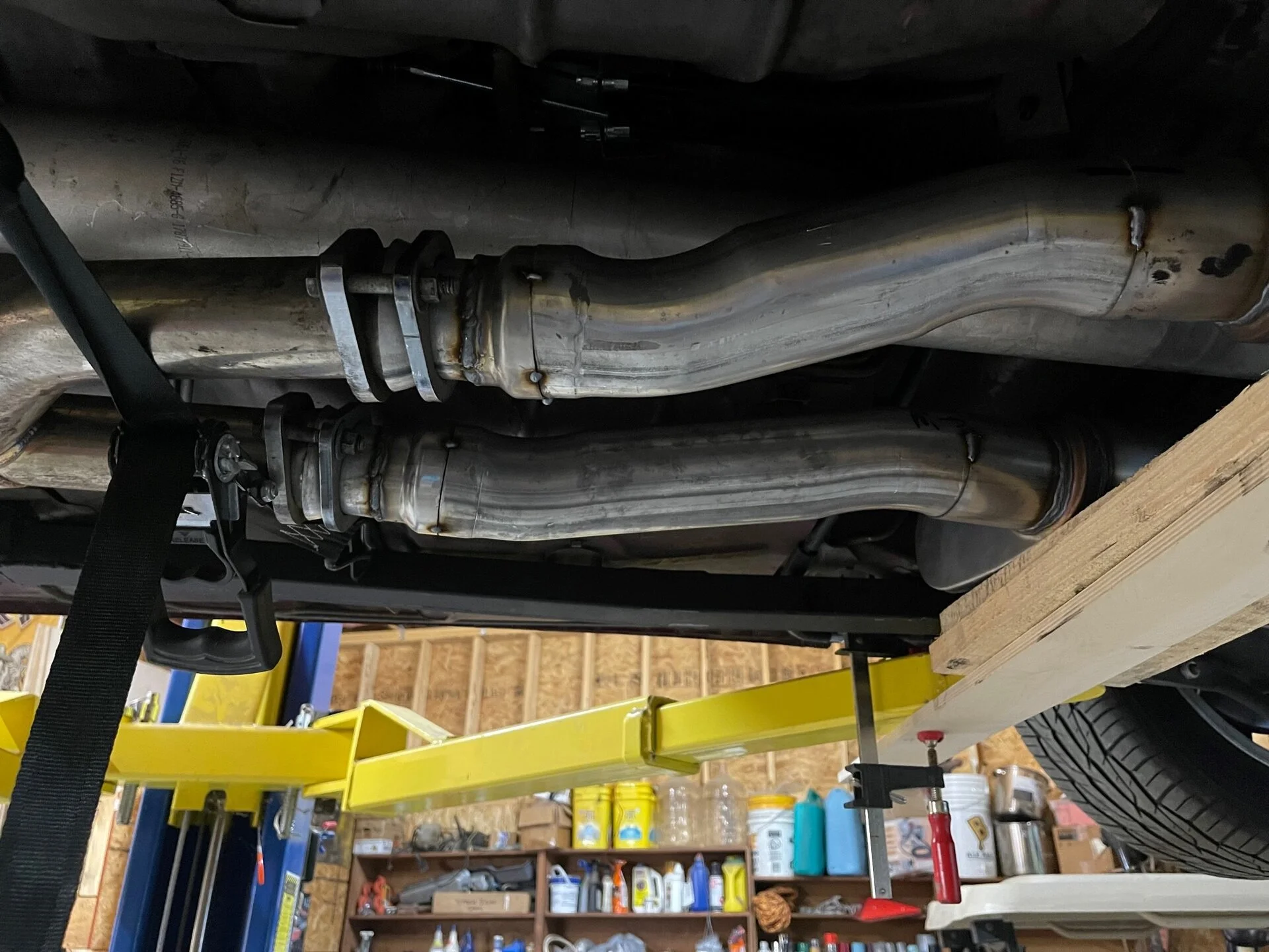

Outside of that, the car drives great. I made a new cat back using 3" flow tubes and 3" mufflers. Still really quiet but man, the loss of all the backpressure woke it up something crazy. SOTP feels like another 100 HP.
This is the only picture I have. And yes, I know 3" exhaust behind a 2.5" Y-pipe isn't very helpful but it's a done deal.

Made some headway on putting the motor back together. I swapped out a lifter that wouldn't stay pumped up. It was probably fine, but I really dont want to come back in the motor anytime soon.

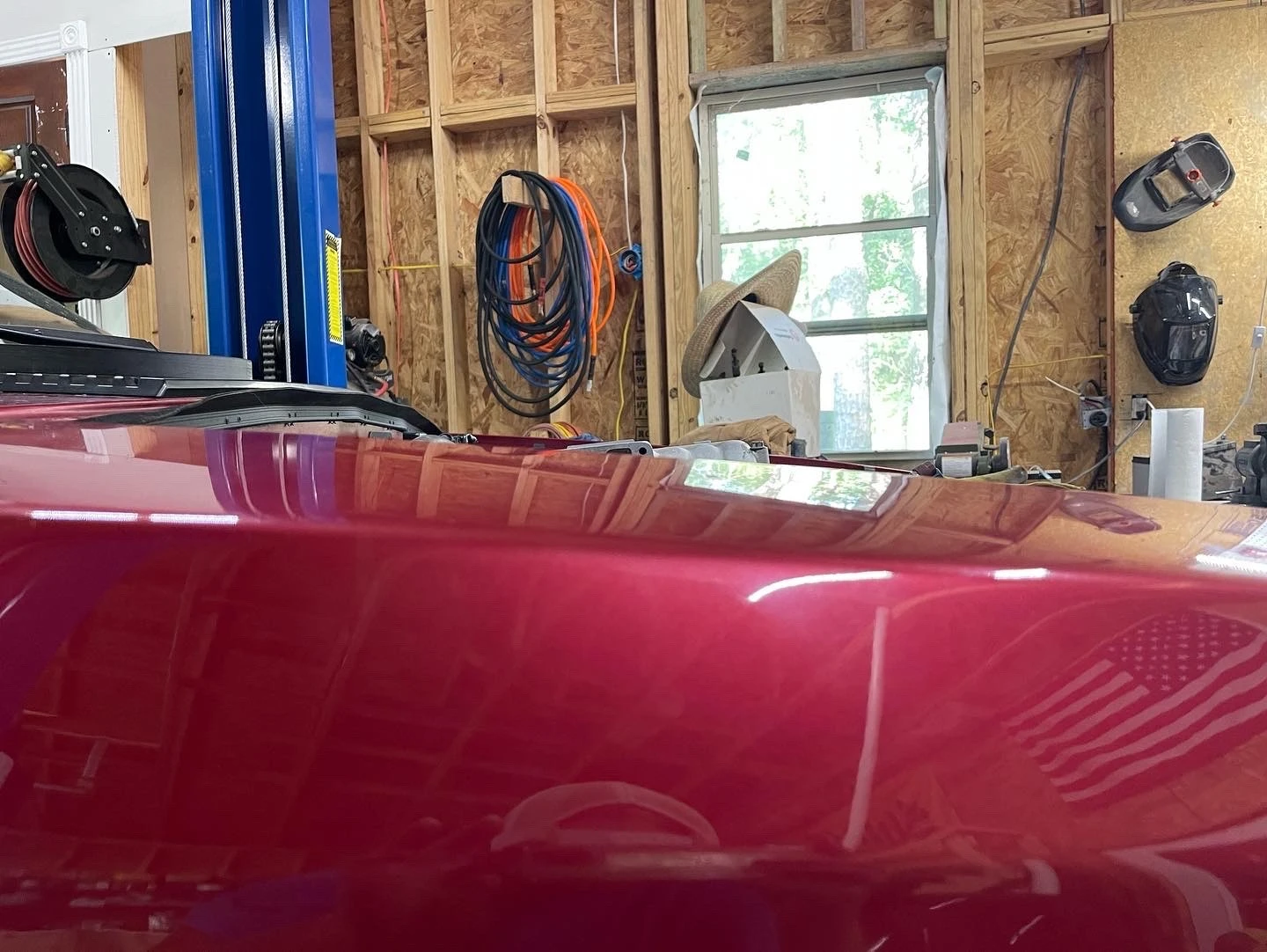

I found a 1/2" phenolic spacer on eBay for $40. I really only need like 1/4" or less. Check out how close it is:
The plenum on the far right is juuuuust hitting the valve cover. The spacer I got is synthetic so I may use some of my woodworking tools to shave it down and get all the clearance I can manage.

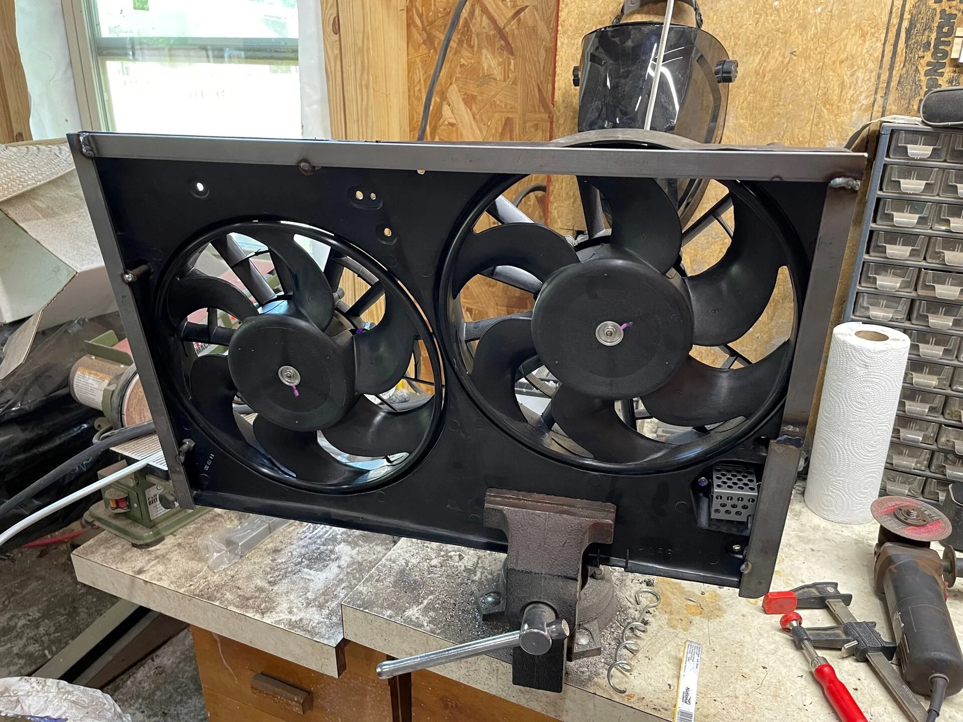

In the interim, I build a frame for the contour fans to mount to the radiator. Need to do some more welding and grindgin

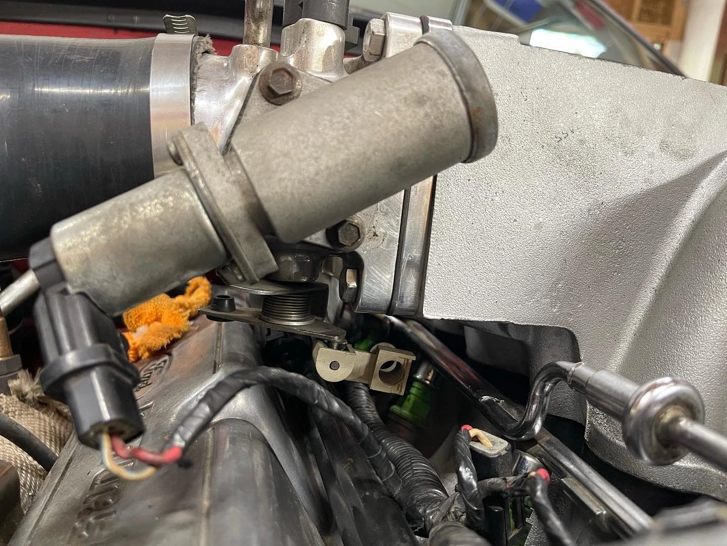

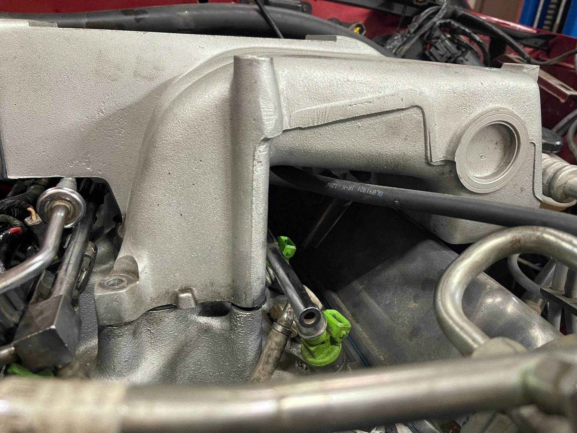

Yesterday, I picked up a 1/2" spacer from a guy in town. Between that and grinding down the intake boss for the front bolt, I think I've got the clearance I need for the hood.
Also, the throttle linkage has a mile of clearance, even though this picture makes it look close. Just a bad angle.
I also got the fans installed last night, Working through the last little bit of wiring. The alternator parts should be here this week sometime so I could potentially be back on the road this weekend.
