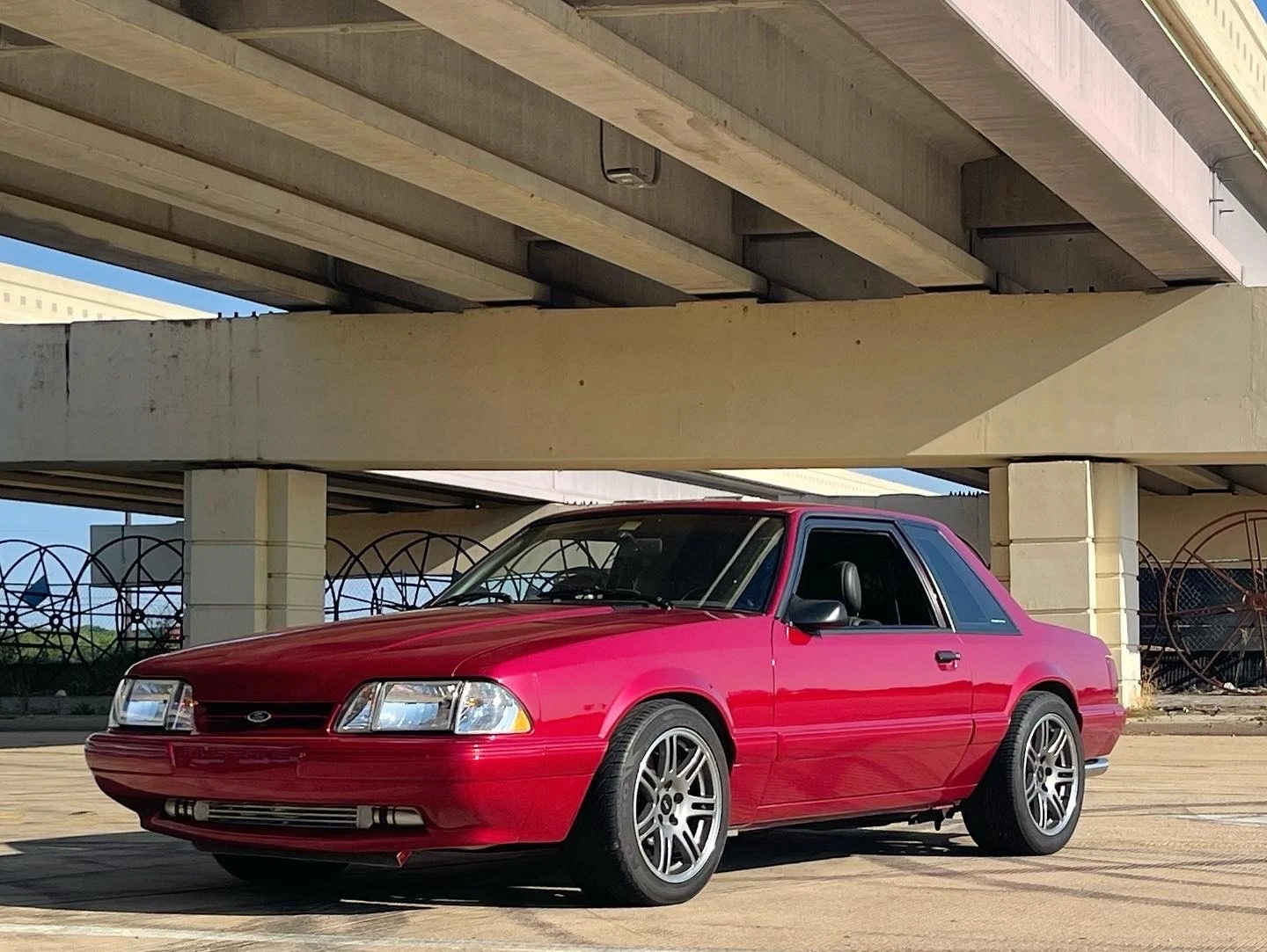

A lot happened this weekend. I guess I'll start from where I last updated - the alternator. I put the new one in and to my surprise, it was doing the same thing, with squealing so loud you couldn't stand to be near it. The only other thing that changed was the alternator bracket so I started looking pretty hard at that. After a lot of measuring and an outside opinion, I shaved an 1/8" off one of the spacers and that solved it.
After letting it run for a bit, it's still smoking. May be the same issue, may be bad valve seals, I dont know but it's going to stay like this for a bit. I'm not about to tear it down again, Just going to need to pay close attention to the oil level this time. It's not bad, but still noticeable.

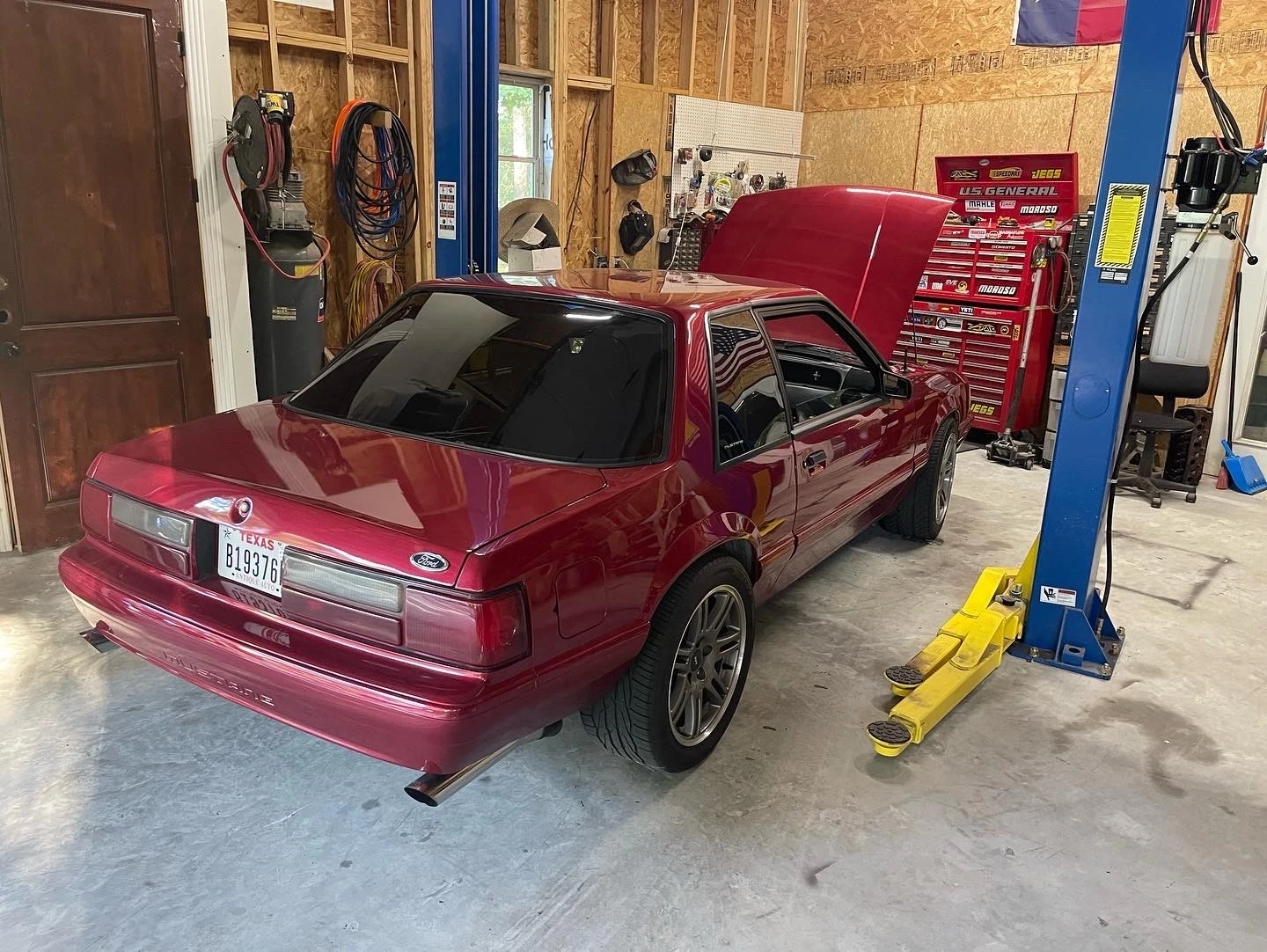

Next, I was able to get the hood back on it. The 1/2" spacer and shaving the bolt down did the trick. So, I decided to go off on a drive and see if it would stay cool with the new contour fans. And... it didn't. I've always thought the front air deflector somehow pushed air up into the radiator like a scoop, but that is incorrect. So, my scoop I made a while back is worthless, if not adding to the problem. The air dam creates a low pressure zone behind the radiator that basically creates a suction.
Also, the car was running pretty steady in the 200° range so I'm going to try a 160 degree T-stat. If it works too well, Ill go back to a 180 and see what that does. But the ultimate goal here is to get it to run cool enough to get the AC on at all times. So, all this is on order:

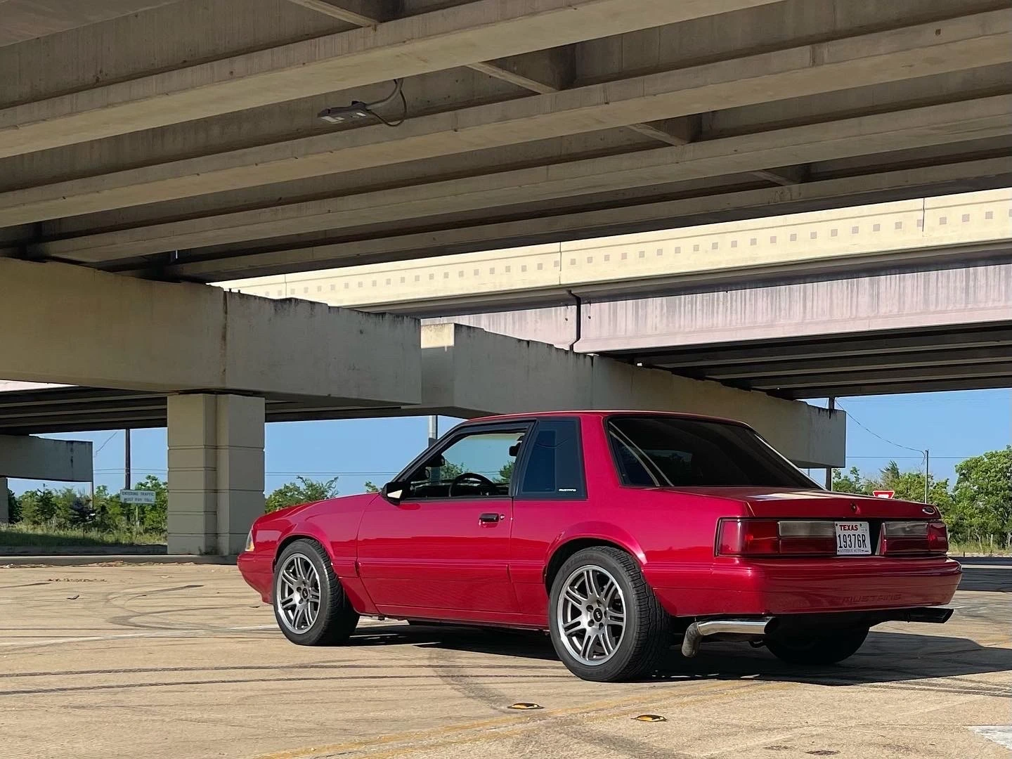

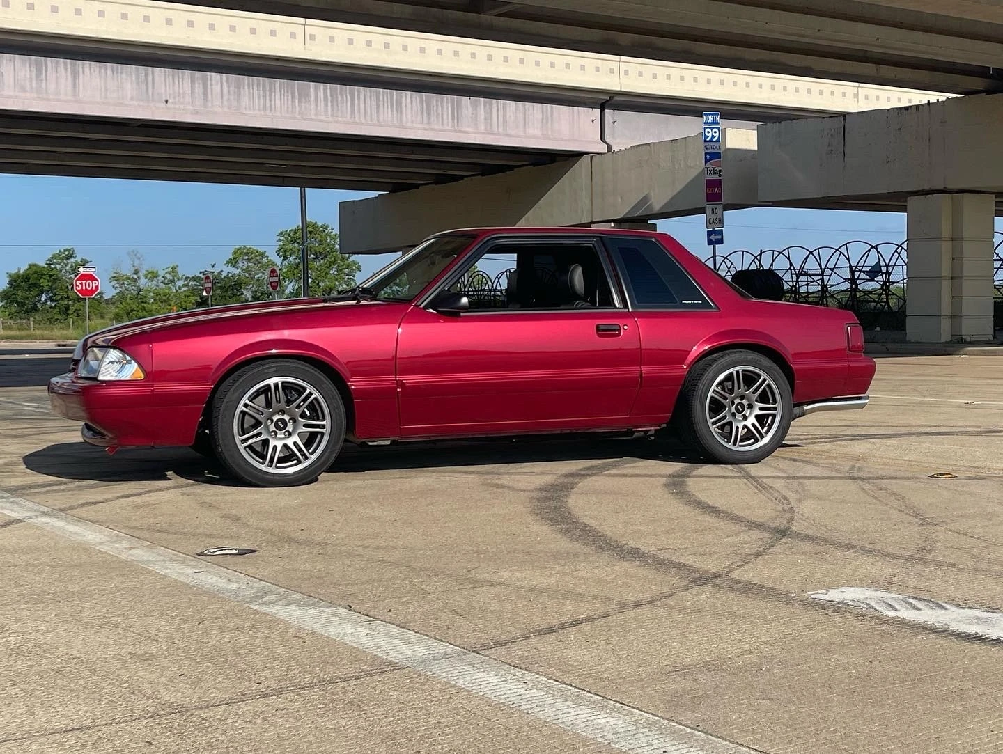

Finally, here's a few shots from the cruise around yesterday. I think I did about 70 miles. Finally, the tune needs more work. I've been messing with the cranking, idle, and AFRs and it's better than its ever been but I need someone to drive the car so I can dial in AFRs on the road a little easier. That will be the last step, I think.

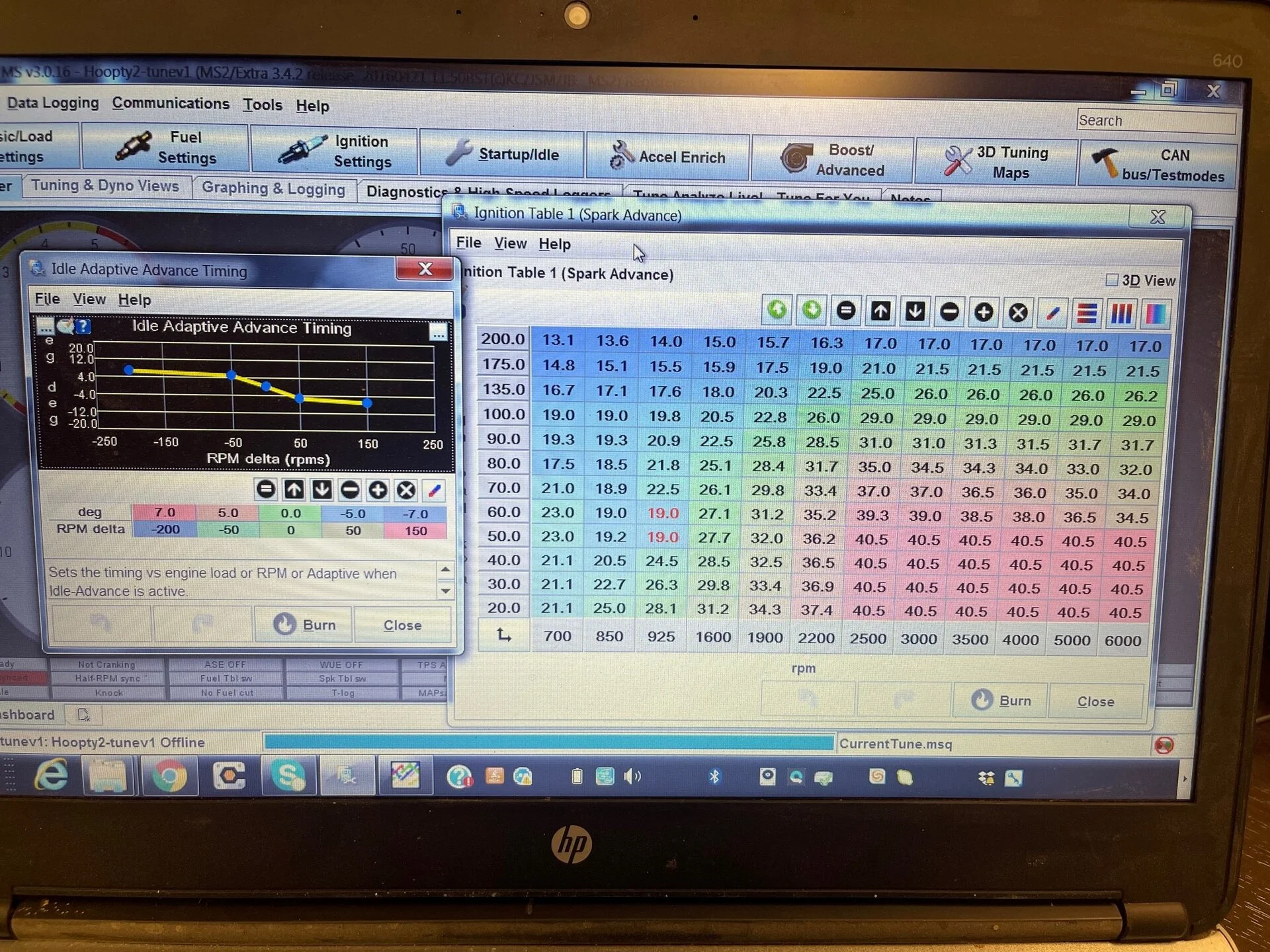

Having trouble getting my dinosaur tuning laptop on the wireless network, so I took a photo of the timing tables. Are you saying that thee two red 19 deg cells can/should be lower than that in conjunction with the adaptive timing table, which can be as much as 10 degrees?
I added the 925 rpm column yesterday to add more resolution to the idle area. I have the VE table for the idle area all set to the same value so the AFR stays steady.
Edit* It was set on use last value. I changed it and set the values to where my IAC testing has been showing closed. Ill go down later and see how it did.

pull 2* out of that timing table from 100 kpa up, its fine for when the car is cool but once fully soaked thats a bit aggressive.

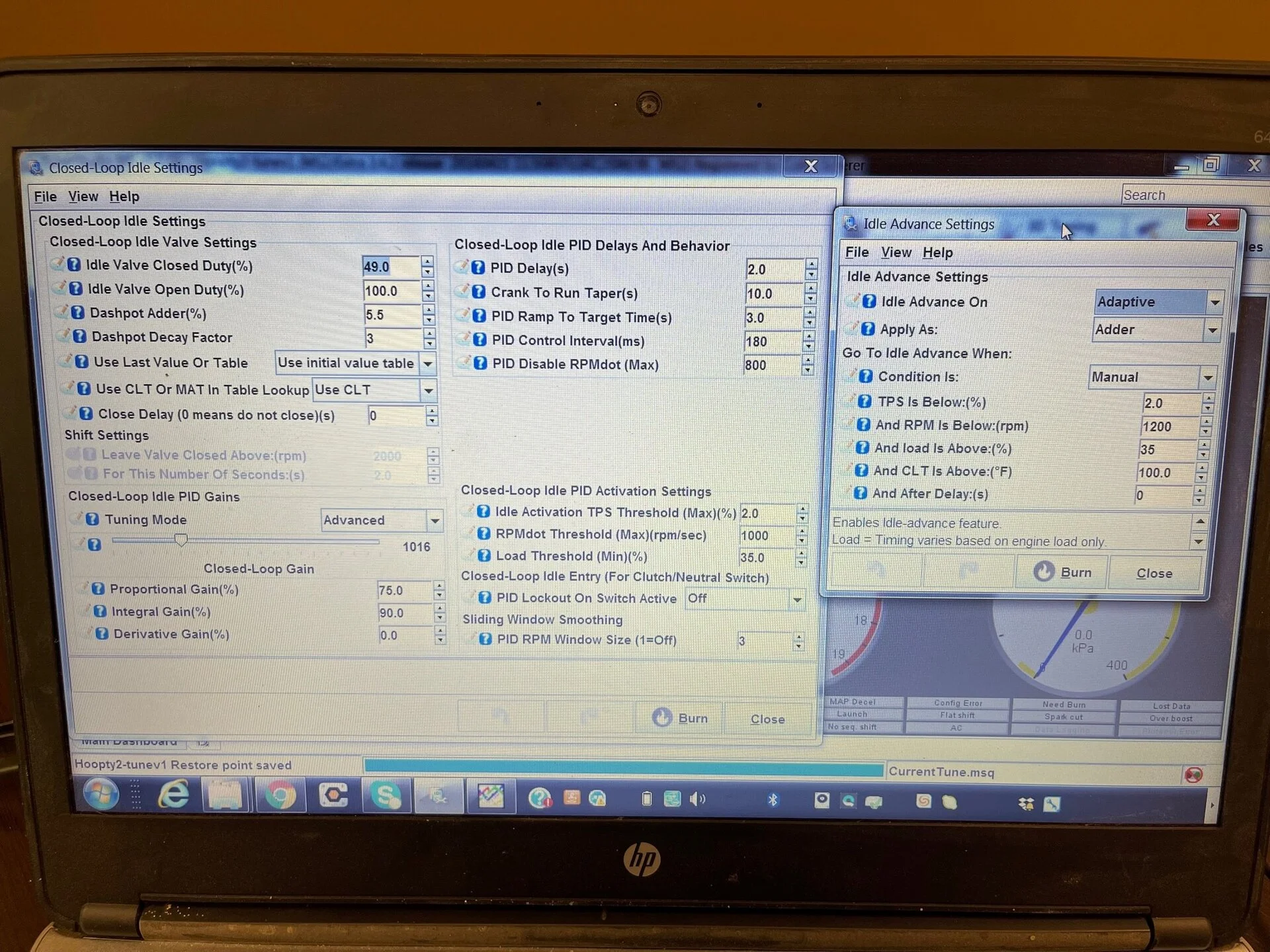

can you grab shots of the idle advance activation settings, and the closed loop idle settings.

@a91what - I just switched it to using the initial value table, so that's new. Also, the closed duty cycle is based on me testing it and that's the lowest threshold where no change happened

All your settings look reasonable to me.

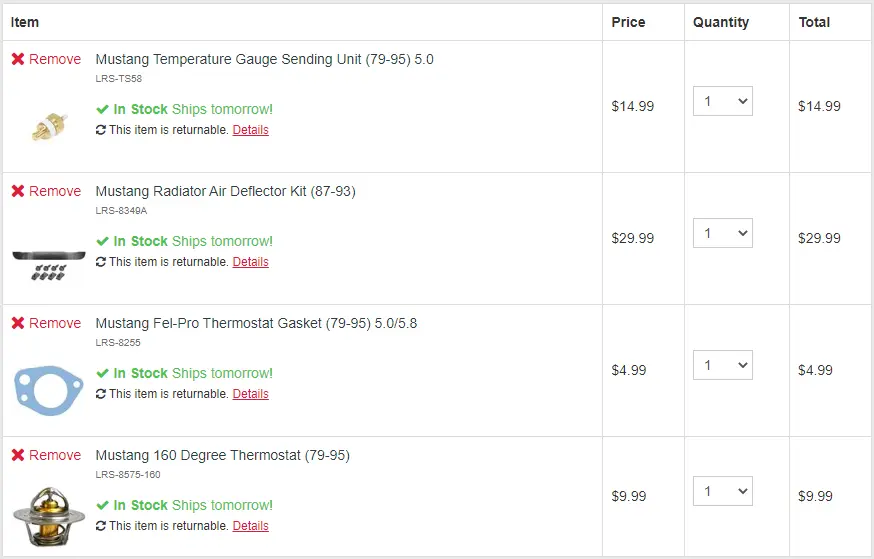

160 T-stat and air deflector was marginal help. Still running 200 down the freeway. I did some reading this morning and ended up sneaking out to the garage. I added a shield on the passenger side of the radiator to close in a gap and force air into the radiator. I also hacked my front bumper cover a little more than intended so it looks like Ill be buying one of those cobra inserts. Whoops.
Also, I'm going to dilute the coolant with distilled water and add some water wetter and see what all these changes net me. I'll be dumbfounded if none of this works.

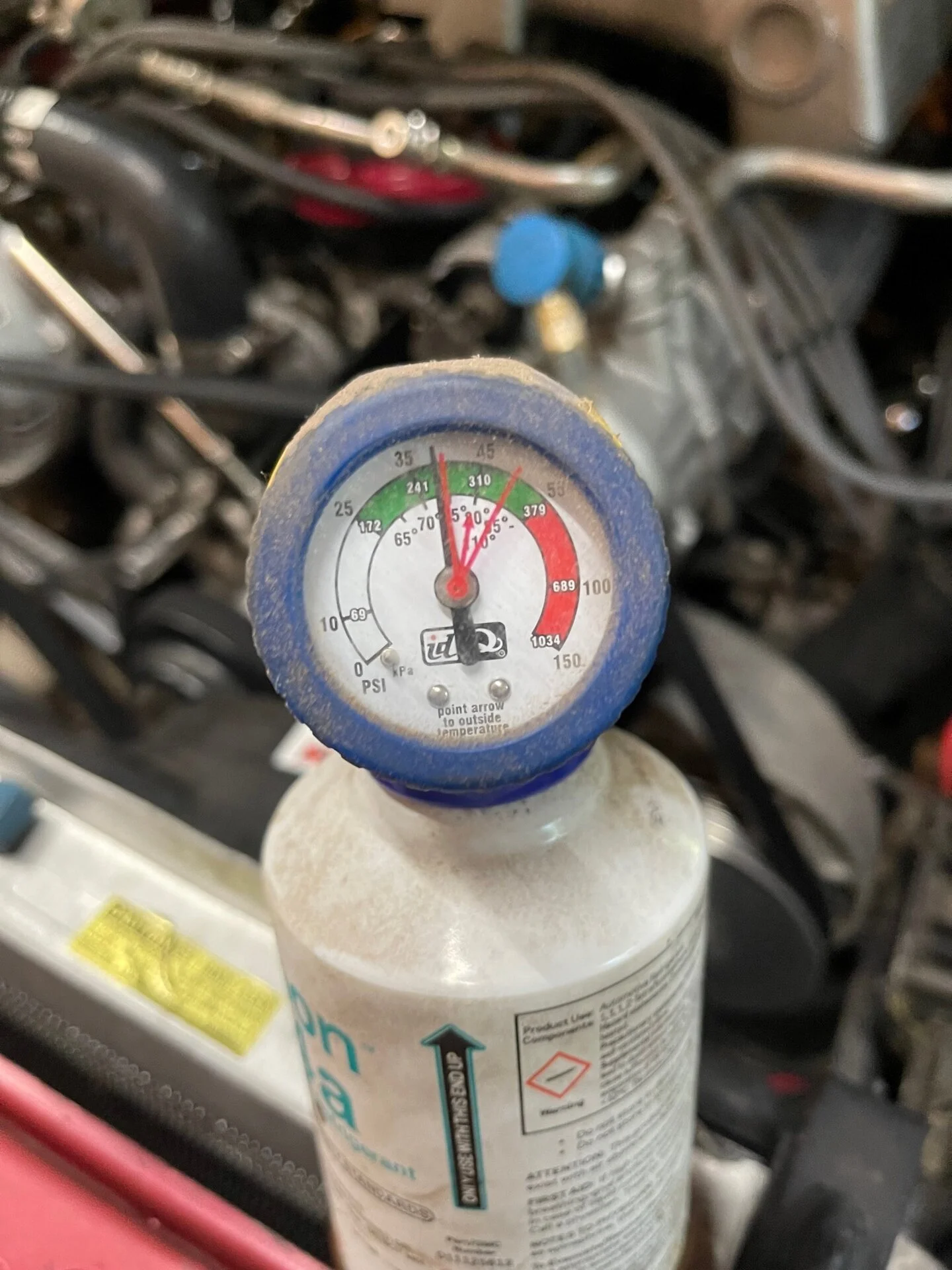

So, another dumb moment in the life of Collin.
I ordered the A/C line that has a hole in it. It's the one that goes from the condenser down along the frame rail to the firewall. I was talking to my buddy earlier (we work together and I called him about work stuff and naturally got off topic) about fixing my AC. Anyway, he asks if its still pressurized and I said kinda. Ended up throwing my auto parts store charge can on to check and it shows full charge. Fire the car up, turn the AC on and its blowing cold. Charge doesnt change much and seemingly wont take any more refrigerant.
Weird, right? I definitely saw bubbles coming out of the line. I will fix it, especially now that the hose has been ordered, but I assume the system had leaked down by now.

Put the can in warm water to raise its temp a bit and that should get it to flow a little more into the system.
You probably do have a leak. My guess is some of the oil is now sealing your leak but it will leak again.
Lots of ac shops will recover the 134 for free since they can sell it to a recycler. Evac it, fix the line, pull a nice vacuum and recharge.
