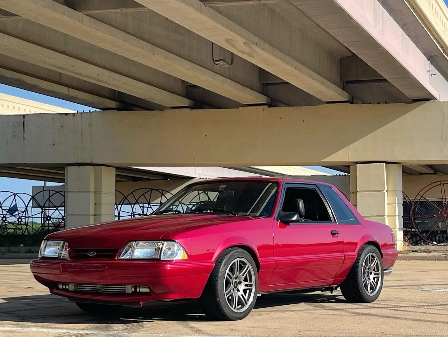

It wouldn't be long long term. I agree with all of what you said, especially the safety part. I drive to dallas/fort worth A LOT and its something I worry about. I'd really just need it until I could afford to replace the 250 in a year or so.
I had that Infiniti Q50 a few years ago and LOVED that car, but I had to sell my '94 F150 and the Q50 to get the 250, which I really have no regrets over. The beater car isnt off the table, but as far as the fox goes, the coyote would check a few boxes. I'm just over the turbo 302 and REALLY want a front sway bar back. It handles like my 250 without it and isnt fast enough to make up for the lack of handling. It has bluetooth and sound deadening, at least, hahaha
All great info here guys, I really appreciate it. I'm considering the yote swap, regardless of how often I drive it. I'm at a point in my life where turning wrenches isnt a luxury I have time for so reliability has become key.
I just ordered some MOOG tie rod ends off rock auto. I also ordered a fuel pressure reg and a fuel filter just to see if that cures the erratic AFRs. Ill update once I get everything on.
I drove it into town this weekend to grab lunch and it was spunky. Still wanna put the 12# spring in and see if itll hold together.

This weekend, I added a set of stock replacement tie rod ends and while I was under the car, stuffed the 12# spring back in the wastegate. It had been a while since I had driven the car and I forgot that it still needs a fresh set of plugs. The cars was still breaking up in boost, so maybe tonight Ill swap the plugs and drive it into the office tomorrow and see if its any better. If not Ill look at an MSD box or a better coil.
Still undecided on what to do with the car at this point. I always threaten to sell it and always chicken out. Still want a set of BC forged wheels something fierce. That's been on the wish list for years and has never changed so maybe it needs to happen finally.
You have to pull the boot, not the wire, duh.
I sold my Challenger and have sunk a hefty amount into a 363 build. Not going crazy with it, as I don't want it to snowball out of control, but come this Spring you'll see some of my itches being scratched. Staying N/A to avoid jack stands, after learning from all you guys on here.
Got the new plugs and wires in. Although they were sorely needed, it didnt fix the issue. The car is still pig rich up top, so undoubtedly that's not helping things. I forgot to take my laptop for datalogs otherwise I would have fixed it but I ran out of time.
I have a few other things to fix that Ive been putting off - alignment for starters. Cars probably going to sit for couple of months until things slow down. Work is crazy, the side hustle keeps me busy, deer season is starting, blah blah blah.
Still planning on ordering wheels too.
