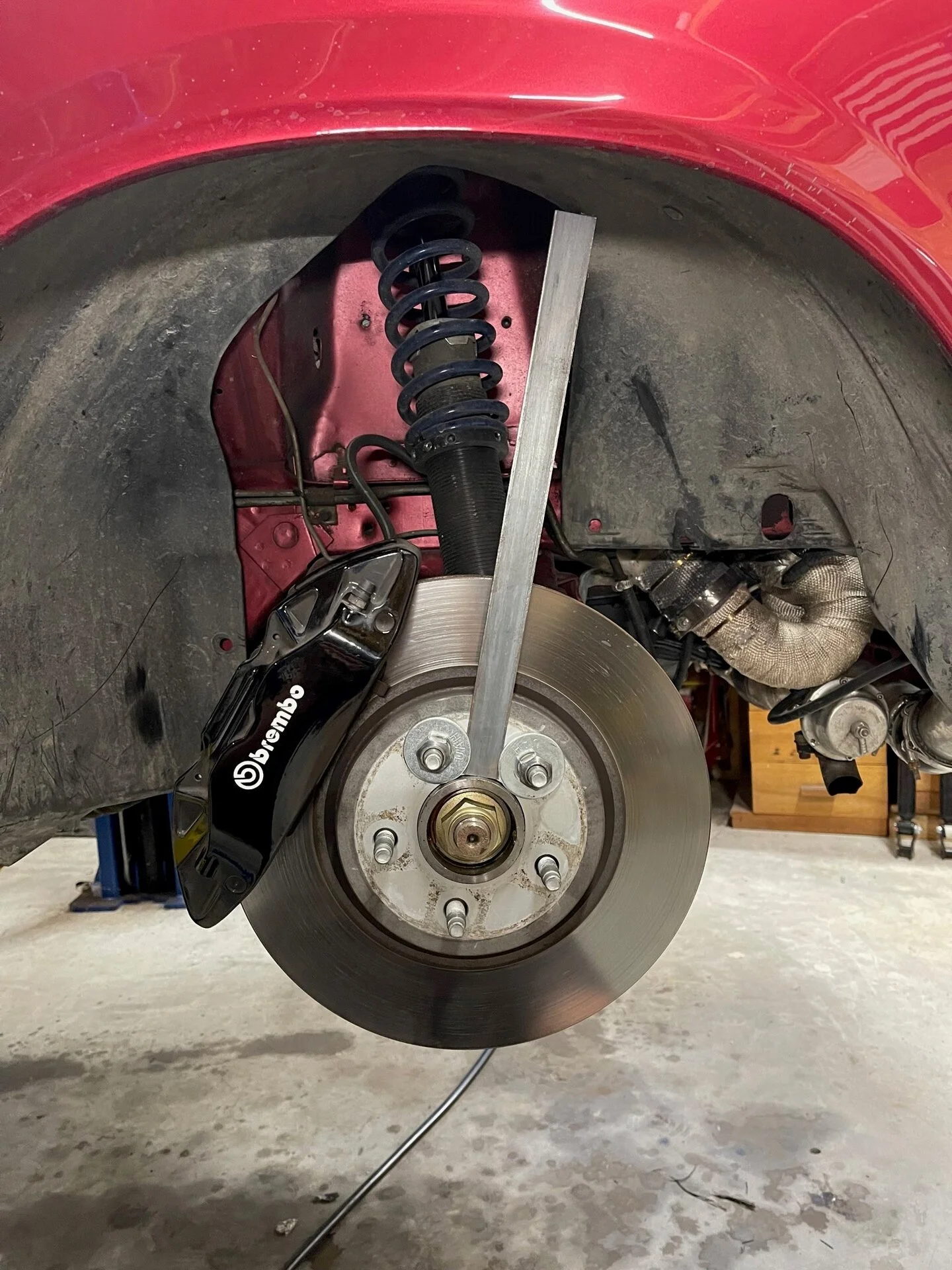

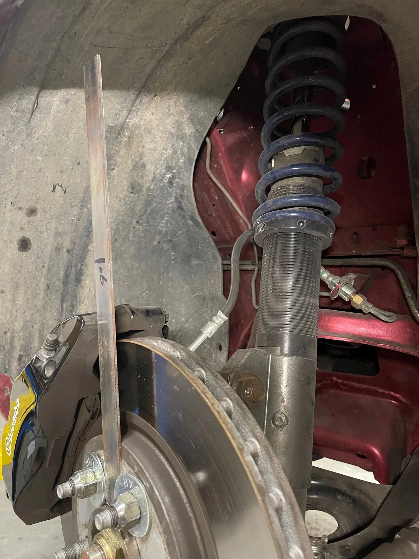

Have you all seen these things before?
I've seen a couple of different makers. Seems like it should work pretty well. Limps post reminded me of it.

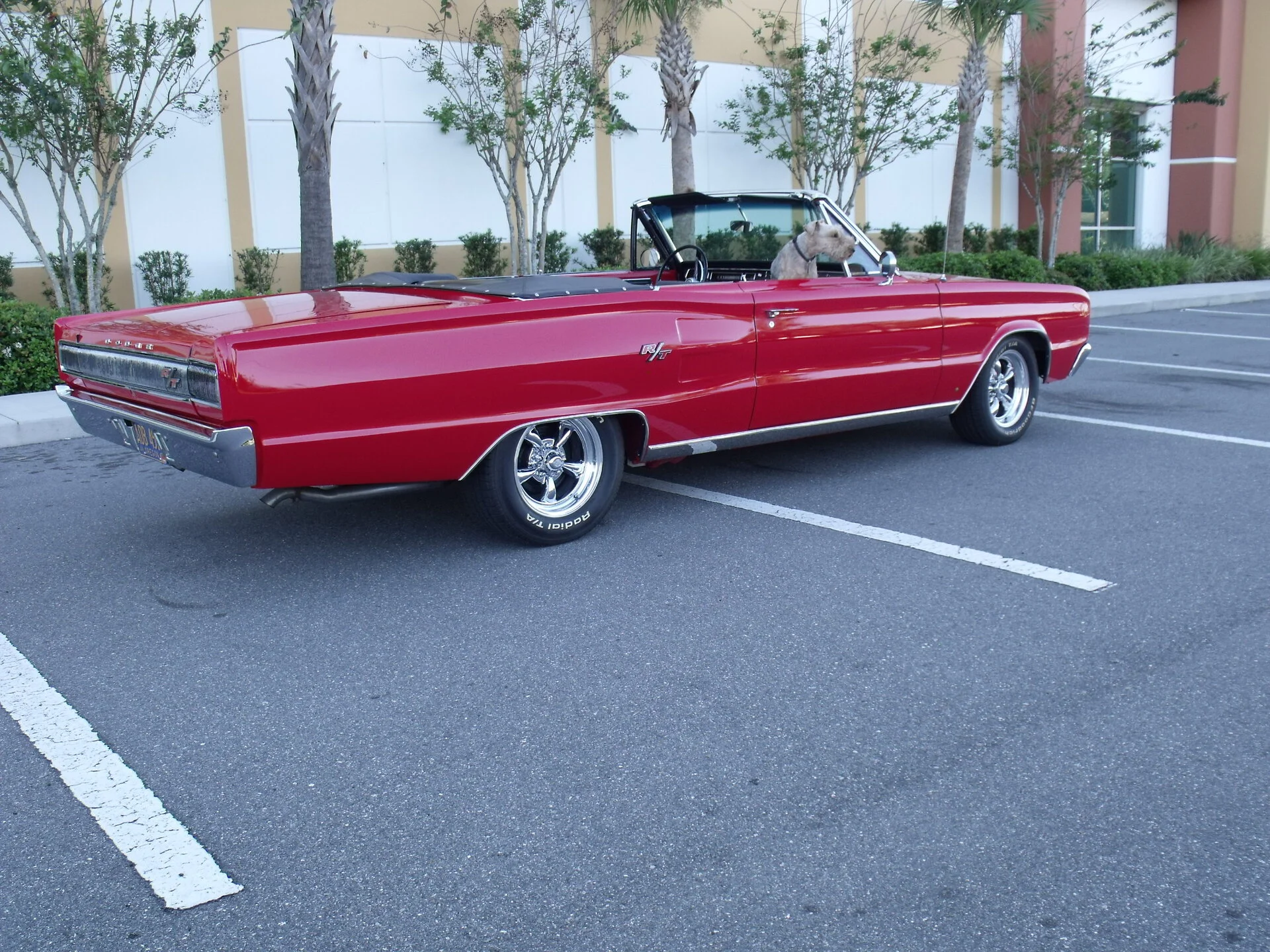

When I did mine, what I thought would work ( by measuring) did NOT work with that size wheel on it....
67 Dodge coronets have a very small rear wheel well that gets smaller as more of the tire fits into it.. So trying some different sizes wheels ( mostly different back spacing) saved me some money...
I SQUEEZED some 8" wheels into the rear of mine that I had to have made with a custom backspace... I always thought later I would have just stuck with 7" like I had on the front....
$1205 for the master kit. It's definitely the schniznit but I would have to go in with three other guys to even justify it being I do not have Dave Kindig money or build that many cars. I will say the mechanical engineer in me is screaming "Buy that MF'er!!!".
