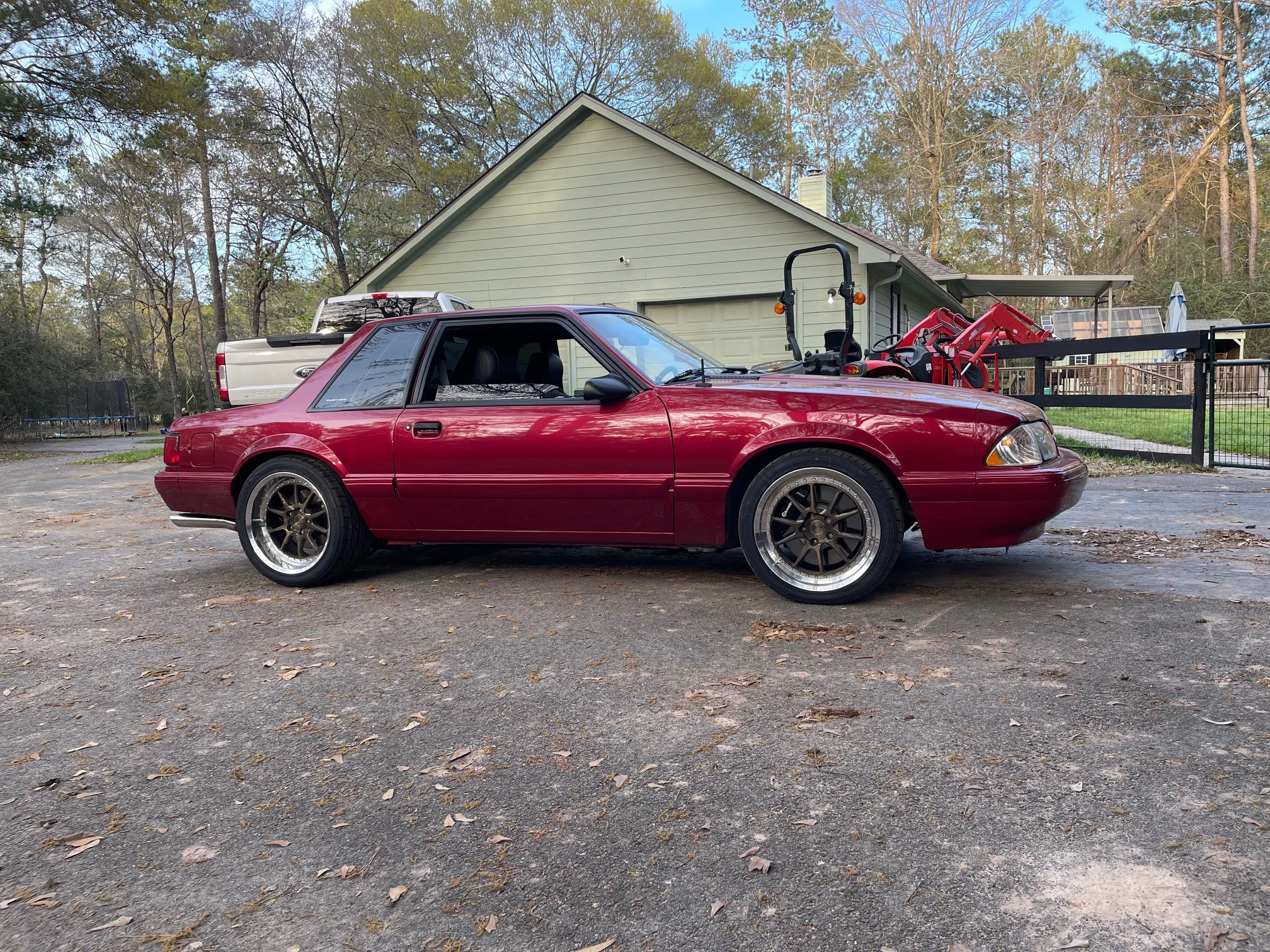

The $1000 question is did the wheel guys take responsibility for the F up or ???
Sorry, I missed this. Still working on that part. The sales guy said he forwarded all of my info to BC, and I believe him after the screenshots he sent during the process. I think it was an honest mistake somewhere, but I'm still looking for a little bit of help from them. Off the shelf wheels you'd expect something to not be 100% to your liking but custom ordered stuff should fir 100%
So you have measured these wheels and they are not built like the measurements you sent them? If that’s the case and if was me they would be going back on their dime and they would be making what I ordered. I understand that takes some patience and more time but like you said custom stuff should be 100% what you order.
Good luck and hopefully they come through as those wheels look great on your car.

Wheel update.
I've been messaging the guy I ordered the wheels through for the past few weeks/month and never really got anywhere. I've been too busy to really pursue it with any seriousness until today. I dug up the original email I sent to him with ALL of the measurements on it, sent it to the guy at BC forged and copied in the dude I ordered them through.
Within minutes, BC forged called me to talk about it, said they never received all the info I had sent to the guy. Had they seen that, something would have changed. At any rate, they're committed to making it right, one way or another.
So, this evening Im going to go test fit a fox-length axle in there and see how the wheel fits in the wheel tub. If the axles work, they're going to reimburse those costs. If not, they're going to look into ordering me new barrels with the correct offset.

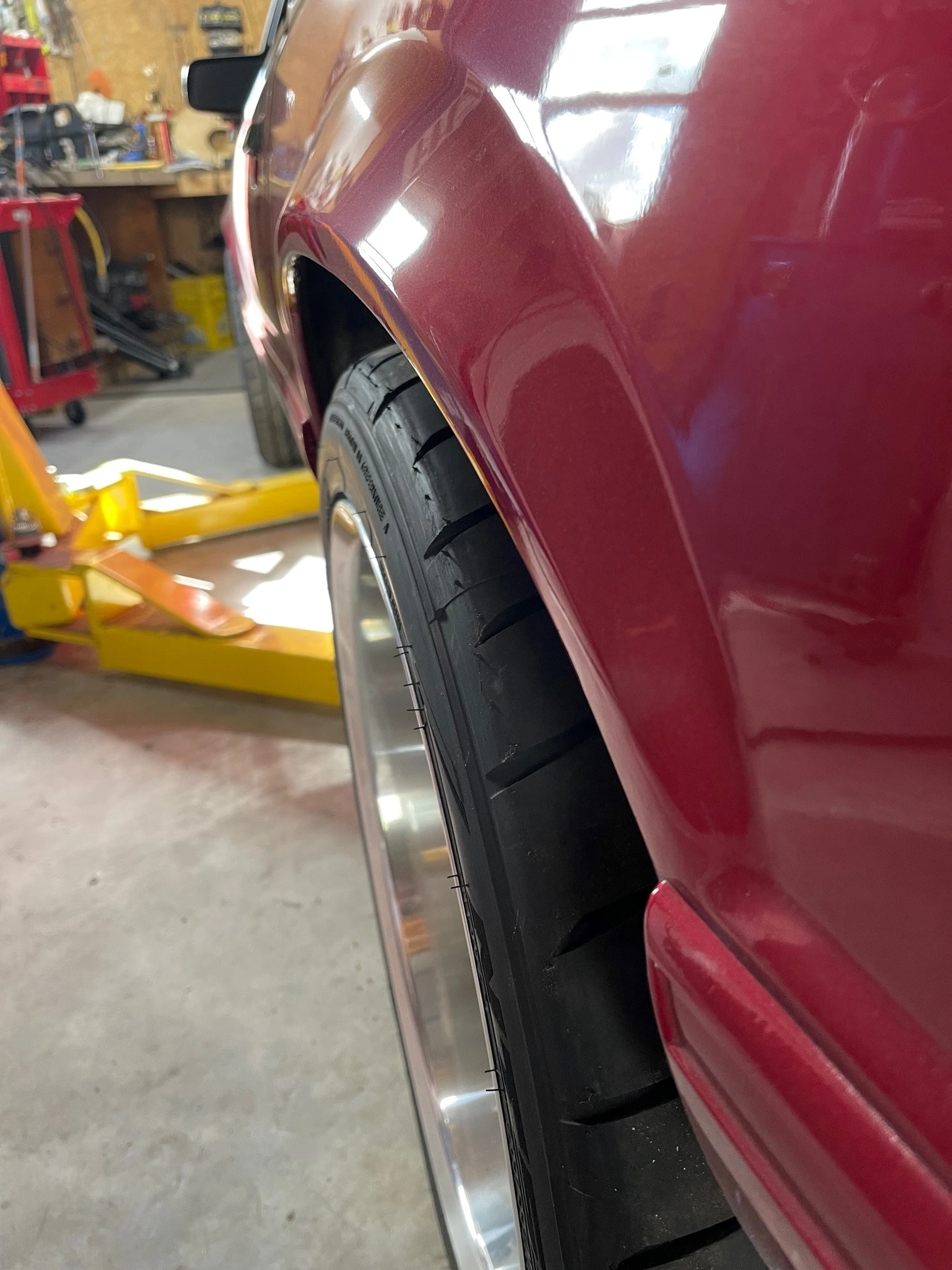

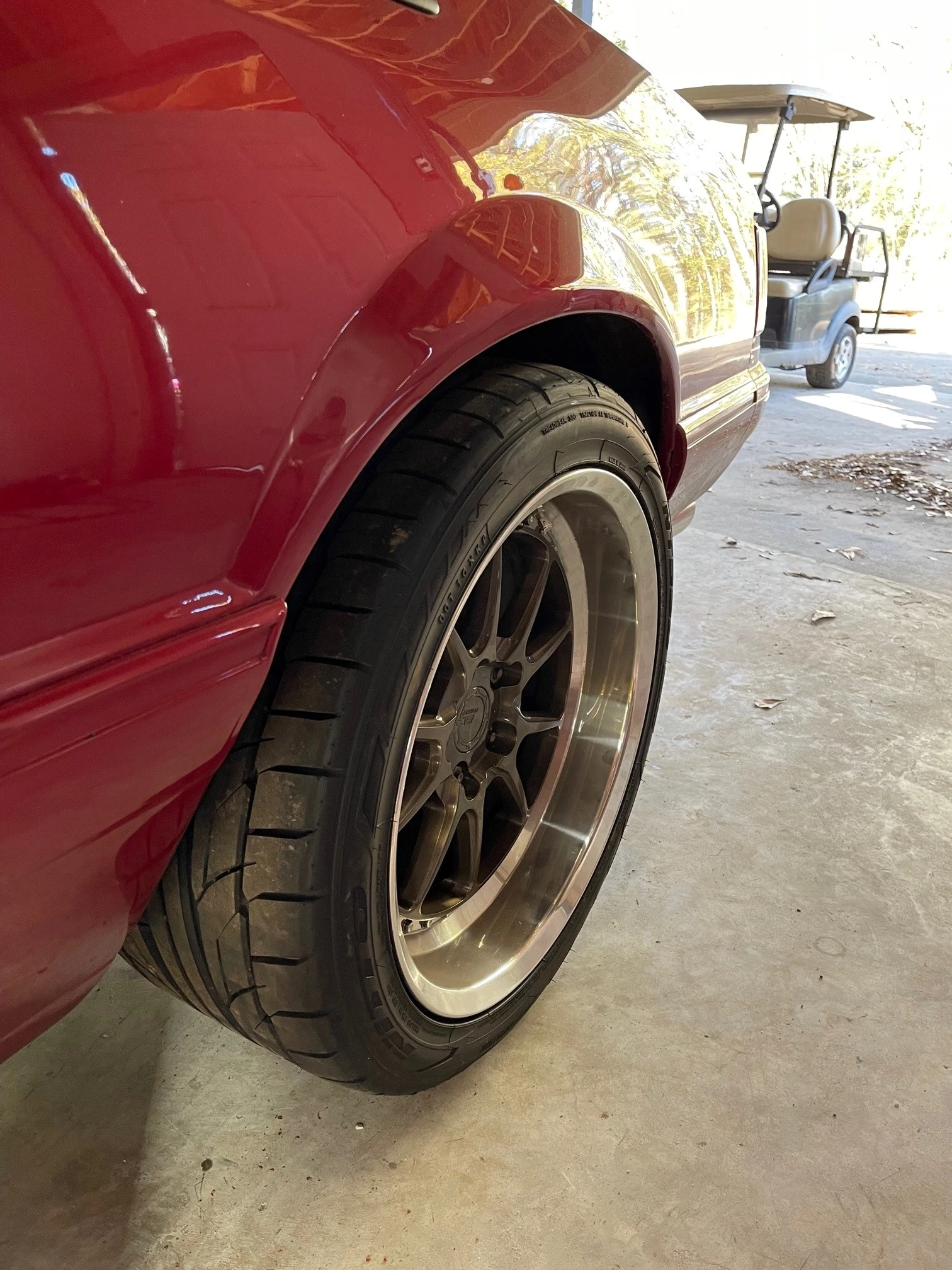

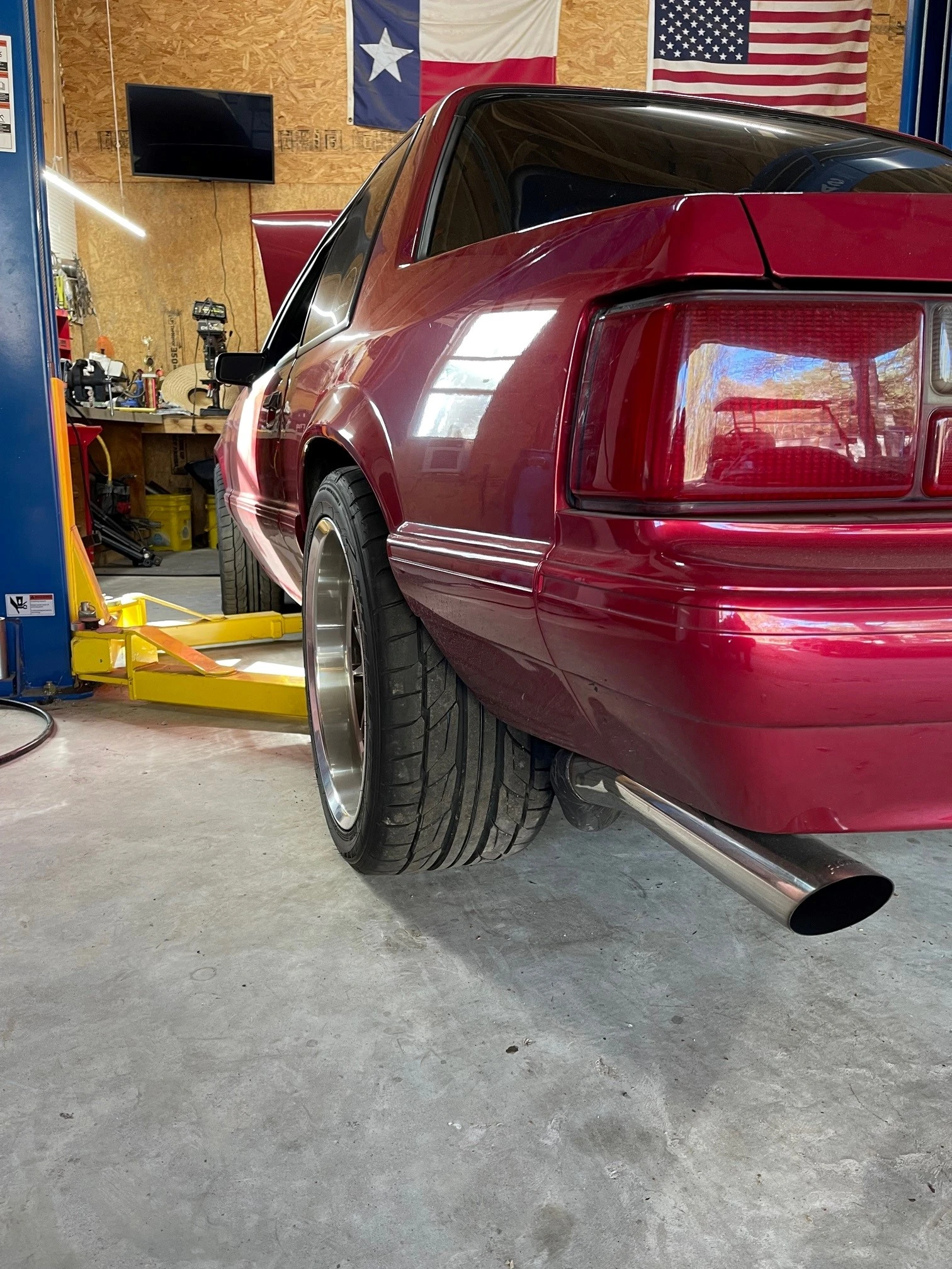

I'm impatient by nature and those of you who have been around a while are probably rolling your eyes. I went ahead and chopped the brackets and got it all back together. It's a million times better in both fitment and aesthetics.
