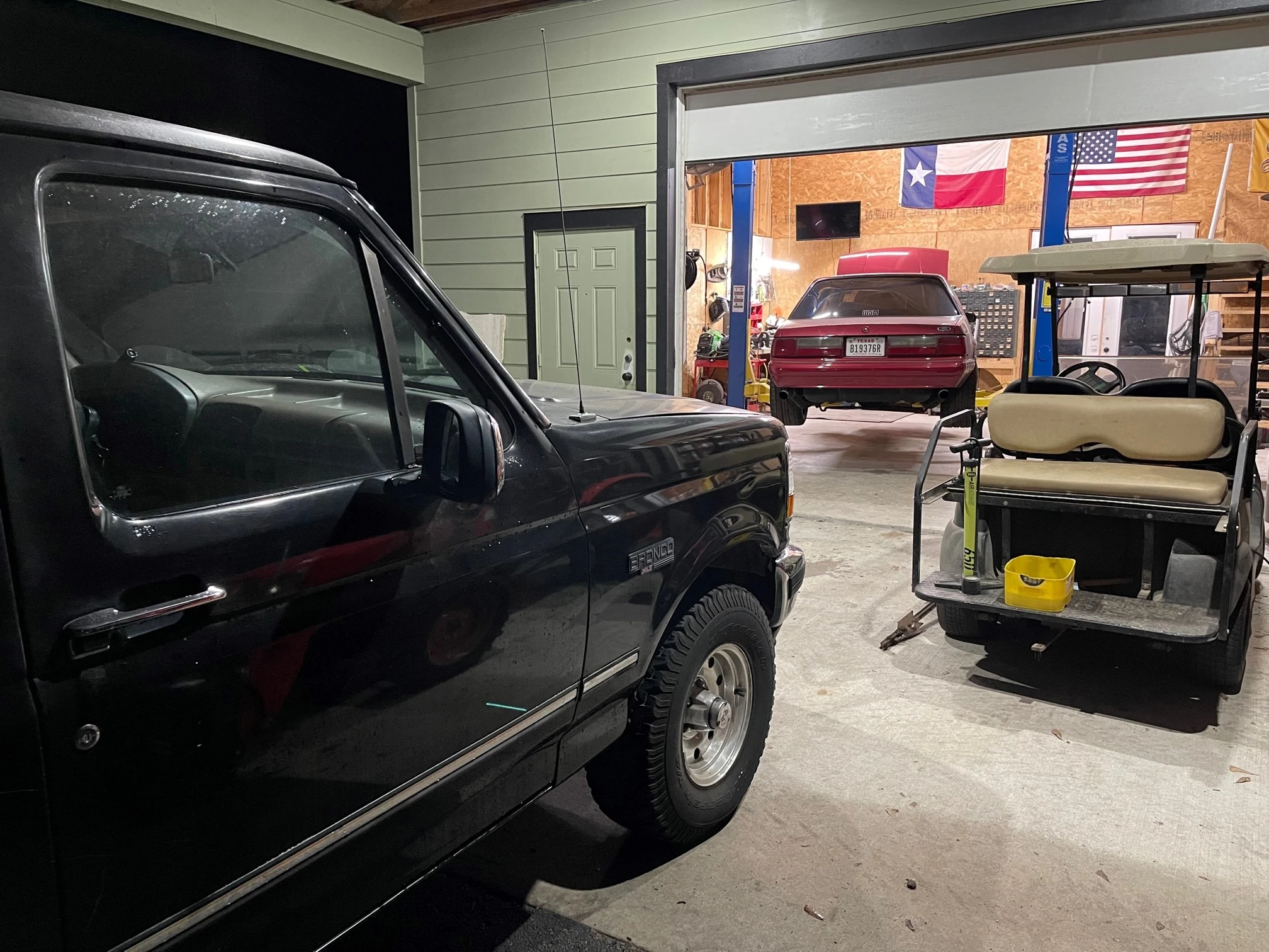

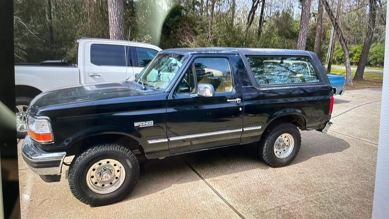

Anywho. Here's my purchase. '96 XLT, 351. It's got a pretty clean interior. I'm going to order some new upholstery for the seats. Motor has a noise, nobody can seem to figure out if its a rod or a valve train noise. Neighbor I got it from did all new lifters/pushrods/rockers and its still there. I dumped a bunch of lucas oil stabilizer in there and it helped some so my money is on rod knock. It leaks from every possible place and the undercarriage is a complete mess of oil and dirt grime.
I will fix it in the coming months and probably sell it. The bronco market is pretty hot right now!
I havent really driven much it yet, but it's 100% stock with the exception of a magnaflow muffler. I really really dig it!
