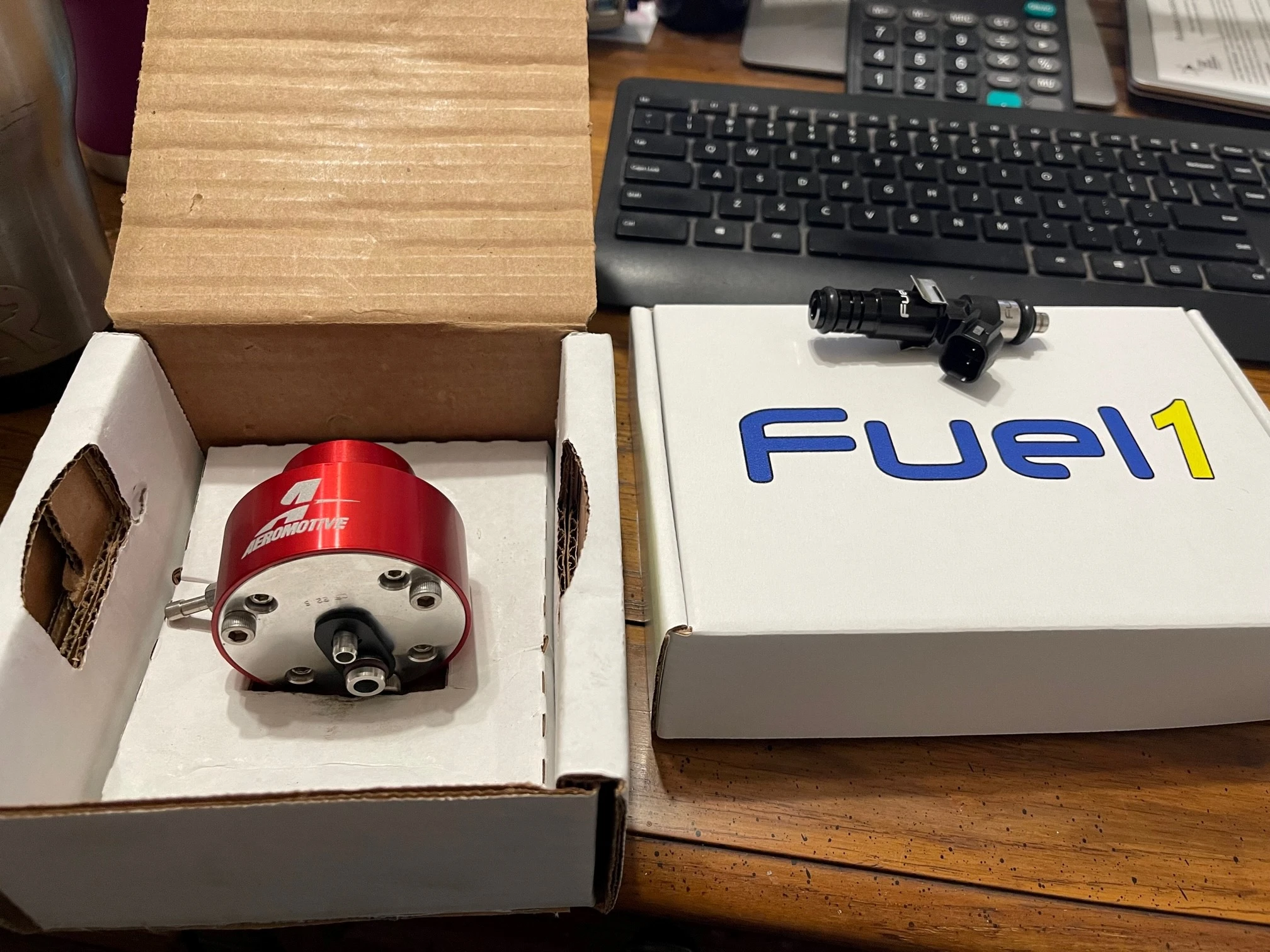

These are the injectors I got. Met the owner in person and talked with him for a while about his process and left feeling like I got the most bang for my buck. Brand new Bosch bodies, flow matched to within 1%. Also got the extensions and plug adapters for $454 OTD with the 30% off black friday sale.
I couldnt wait any longer (surprise, surprise) so I ordered a 340lph walbro and an Aeromotive adjustable regulator for the stock rails. We're going to push the stock lines and rails to the limit, I think.
Shoutout to @TOOLOW91 for all the advice lately. I appreciate you keeping me on the rails man. I forgot to ask you about a fuel filter. That's all stock as well. I assume that's ok to use?

Nice, so are those technically 80lb/hr or 70lb/hr as the numbers on the link show two different things? I will still need to get new injectors for my 4.6 at some point, likely some 60's will do for my target of 450-500hp.

I actually got 750cc injectors, they ran out of the 700s and havent updated the site yet. But yeah, they're close to a 75 #/hr

Got 2 out of 3 orders in, waiting on the fuel pump. Plus, I was supposed to get adapters for the plugs on the injectors so I need to track those down.

hoopty5.0 said:
F1-750 FORD COYOTE 5.0 MUSTANG GT (1987-2004)/ Cobra (1993-1998)
The F1-750 was designed to be an all fuel compatible injector, capable of very high flow rates. It is most often used to deliver E85 to boosted engines in extreme high horsepower applications and can also be used for those using gasoline. It features corrosion resistant internals making it...
fuel1labs.com
That’s what we do buddy ! In this case you’re sort of stuck on that end of it using what is there .
My biggest recommendation like I said is try to up the stock tank vent size or drill out what’s there . It helps tremendously with vapor lock and stuff
