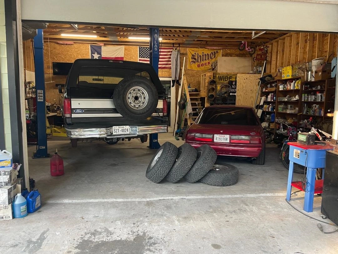

I cant work on it because the bronco is in lieutenant Dan mode waiting on new shoes at the moment. Also getting a set of leveling springs and some brake work. Got a CEL the other day on the way home from Oklahoma so I need to chase that down too.
On a lighter note, the bronco got almost 16 mpg on that trip, running 70-75 with a nasty air filter and a bad knock in the engine (goes away when warm) and a flat ass tire because of an old plug that decided to give out half way there.
