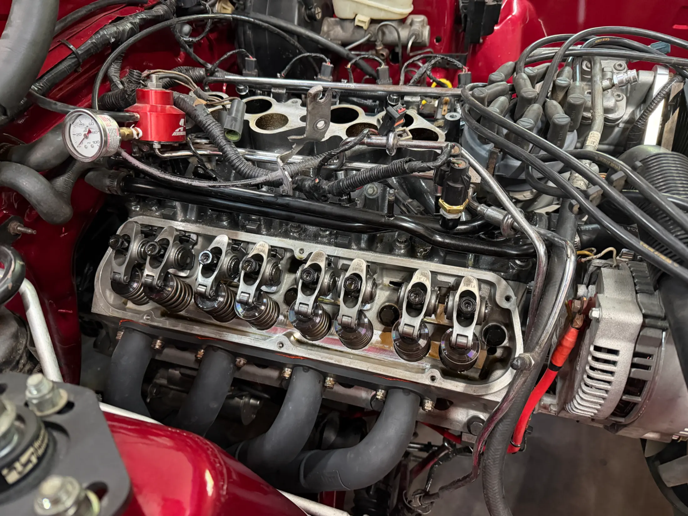

It Drives!
... That's the good news. Bad news is I have to pull the intake back off. Something is amiss under the intake and is drawing vacuum pretty good into the crank case. My guess is a misaligned intake gasket OR I didnt torque the intake down enough. Ill try and see about it this evening.
Couldnt get the idle dialed in and it smokes on decel so all that points to a gasket misalignment if I were to take a blind guess.
Otherwise, it drives REALLY well. Super smooth, very snappy throttle response. A lot quieter cruising than I expected. Overall I am thrilled.

Just a suggestion so take it with a grain of salt. I looked back on your pictures and noticed you are using bolts on the lower intake. Use studs instead and you will get a better torqued and it helps line gaskets up. Been running them for years and don’t have intake leak issues.

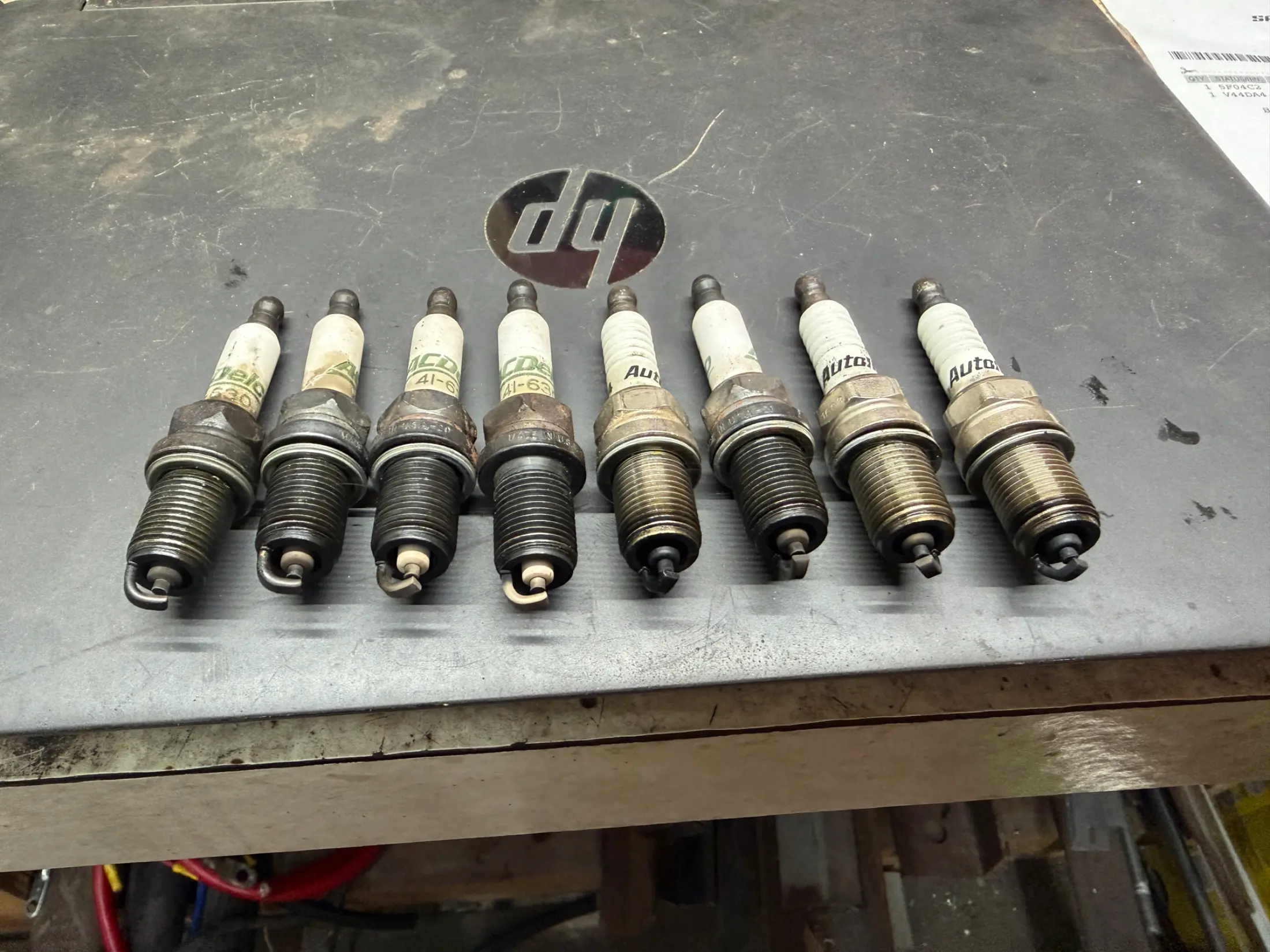

Lower intake wasn’t tight. Went down to 23 lb/ft. You can see where oil was getting sucked up into the intake and fouling the plugs. These were old plugs anyway.
So, new plugs going in, checking rockers, changing the oil. Hope that’s the last we see of it for a good, long while. Looking forward to a lot of road miles soon.

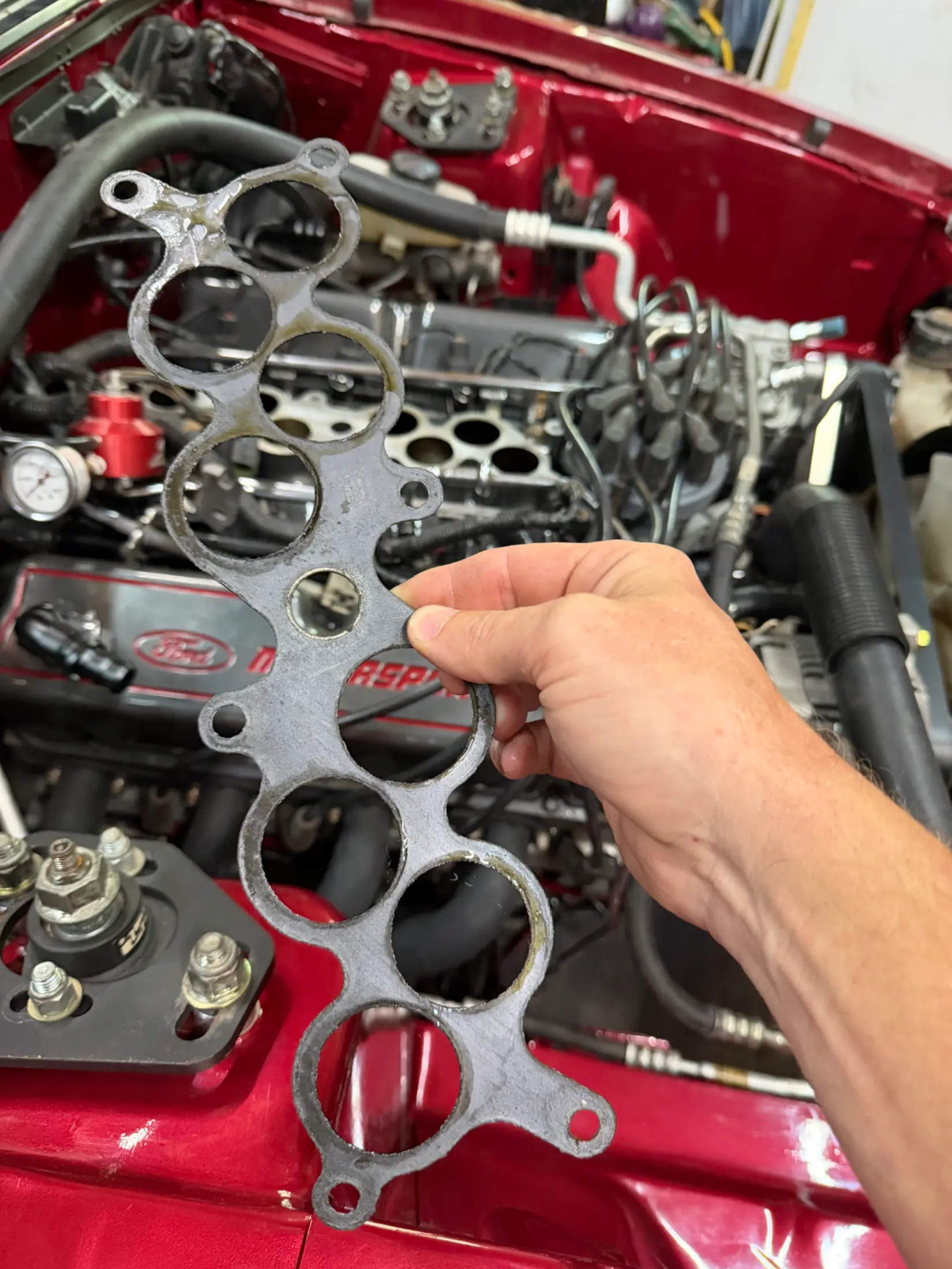

well I torqued the intake down yesterday, the bolts were not loose but it absolutely wasn't to spec, still heavy vacuum in the vents. Sooo that means I get to tear it all back apart and figure out what the deal is. I know they make some thick 1262 gaskets I may need to track down. I'm hoping its something simple and the intake wasnt milled to some weird angle.
Edit* I have pre-emptively ordered some 1262R-5 gaskets that are .120 thick just in case.

That’ll do it.

Yes sir that will definitely create a leak. You can tack the gaskets down with some 3M weather stripping adhesive. Two small dots (size of a pencil eraser) placed between 1&2 and 3&4. Cleans up with a razor blade and some brake cleaner.
