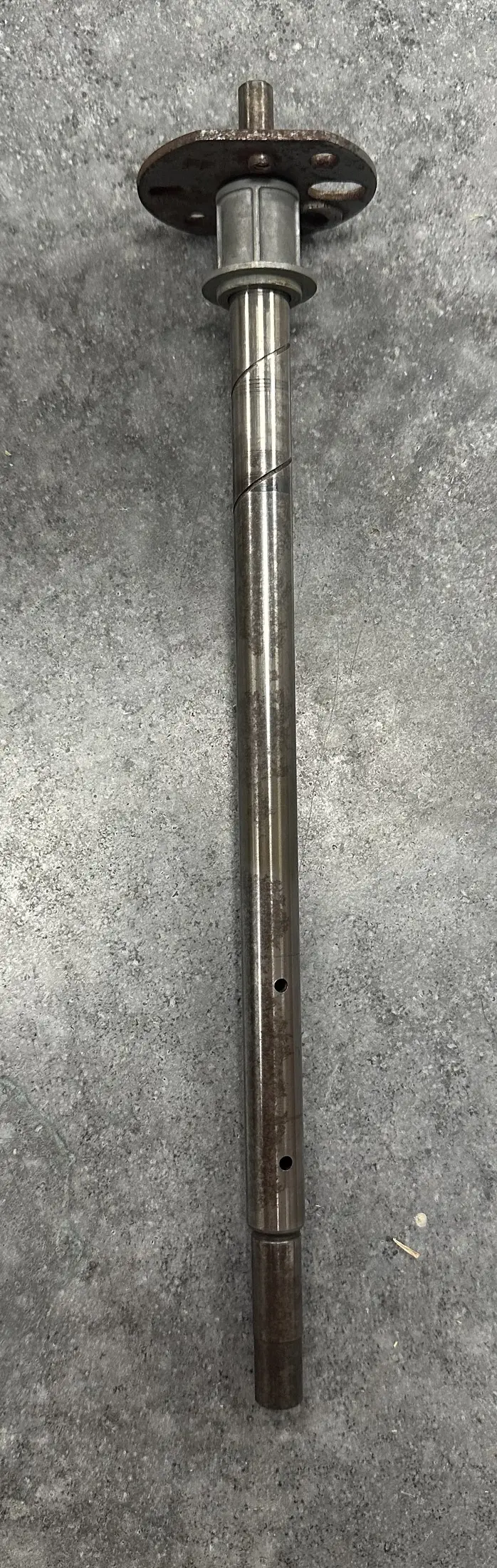

I also ordered parts to build a steering shaft. The one I found in my garage hits one of the primaries and sticks at inopportune times and is scary, LOL.

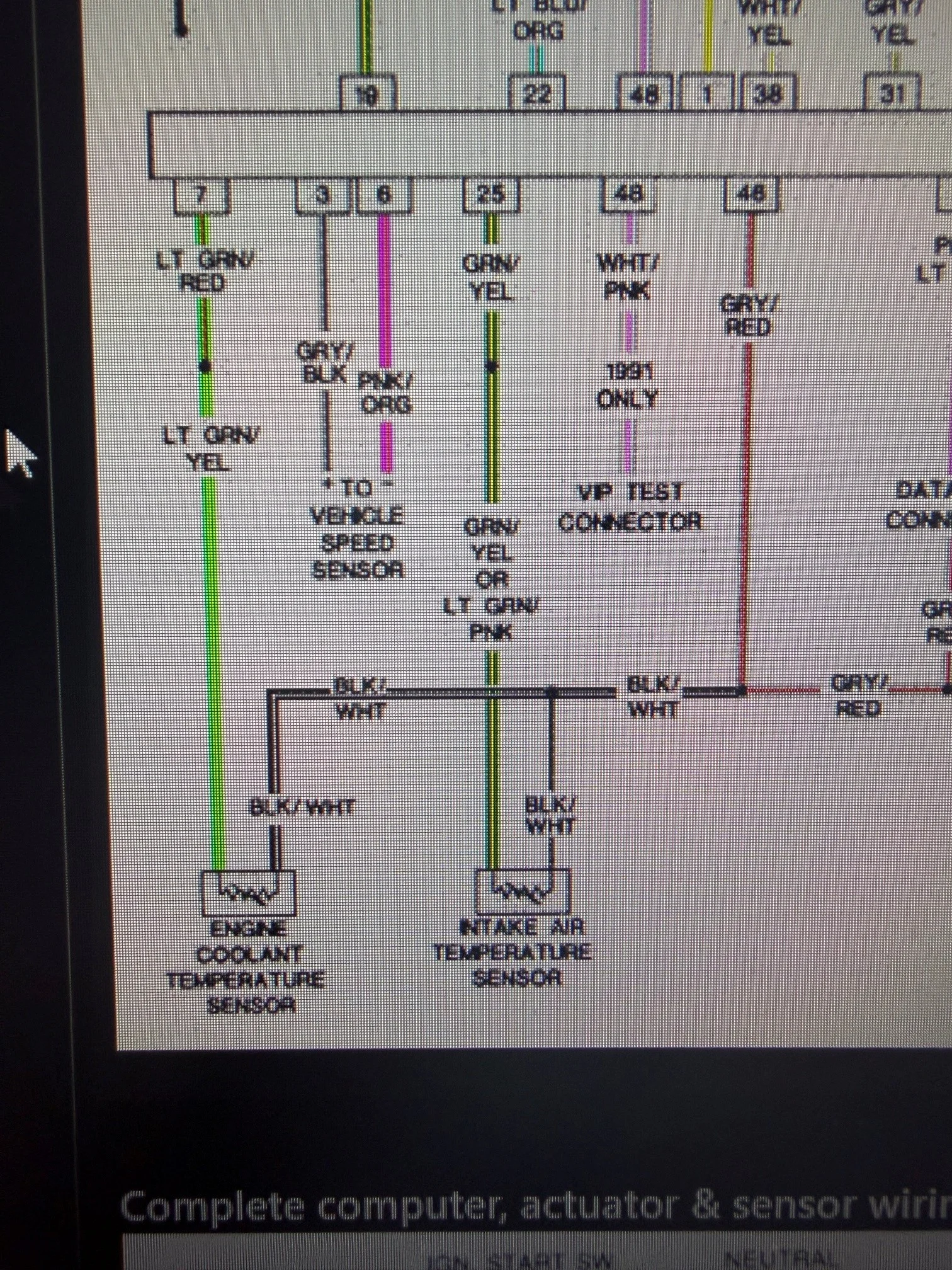

Man. Tough day trying to get the Mustang up and running. Temp sensor was on the fritz, ordered a new one. Still not right. After a bit of troubleshooting, it was a loose pin. Then had to re-scale the table because the temp values were all wrong. Put the engine back together, realize the upper intake isn’t seating because of a bolt being too high. Put a plug in, put the intake back on and start it. Runs ok for a few seconds then dies. Start it again, smell fuel. #5 fuel injector spraying fuel everywhere.

Still no luck on the car. Went ahead and ordered a new plug for the CLT sensor since the plug broke and the pins move around. But, something else is still wrong. I have the correct resistance values plugged into the software for the temp values but at room temp, its still reading 200 degrees. When you unplug it, the temp jumps around. Need to ohm out the wires next, I guess?

I’d unplug the ECU and check continuity on those wires. Almost like one is going to ground or they are touching somehow?

It's gotta be something like that. It does it even with the S&P shaker connections unplugged. The new plug comes today so Ill look at running new wires altogether.

I have decided that in the interest of time, I'm going to use a new connector and pigtail, new wire, and just run it all the way to the ECM connector and splice it in there. I dont have the interest in troubleshooting as much as I want to move on to other projects.

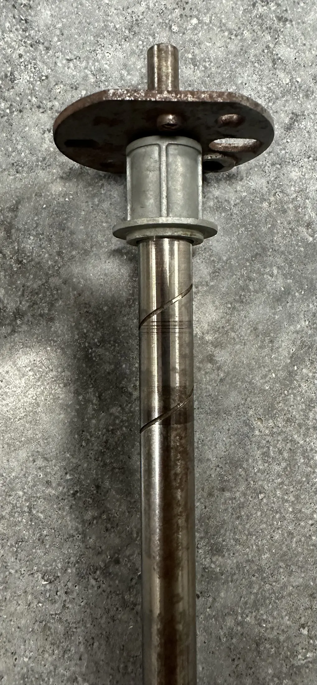

I have the parts to build a new steering shaft. Current gets caught on a primary at random times. Thats fun.

I re-did my steering shaft last night. Other one was hitting a primary and would randomly catch.

So I wired in a new ECT plug/pigtail and used new wire to bypass the harness. I cut and spliced into the LT GRN/RED wire at the 60 pin and then just tied into the BLK/WHT for pin 46 since so many other sensors tie into it. Same results.
I really think think the bias resistor in the A9L is bad. This is the old, OLD megasquirt that piggybacks into the stock ECM vs having the standalone unit.
