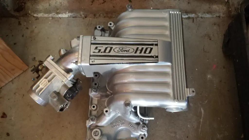

Why not put an explorer intake on instead? They look very similar to the stock 5.0 intake (especially if you use the 5.0 HO intake plate) , and the earlier models have the EGR so you can make it a factory install.
ignore the angled adapter. That's for 94-95 cars
Even if going for a truly OEM engine bay, an intake is not a permanent mod by any means. A few hours of work and you can have a stock intake back on the engine and would never really know it was ever removed. You might as well enjoy the power bump from the explorer intake over even a ported stocker. I believe the CFM numbers are about the same between the two. With stock GT4- heads, no need to even port the explorer lower really. But if you are planning a head change, I'd go with a ported explorer over a ported HO intake. The upper plenum is huge and has a lot of volume which translates to good torque, and the lower has more potential than the HO lower.

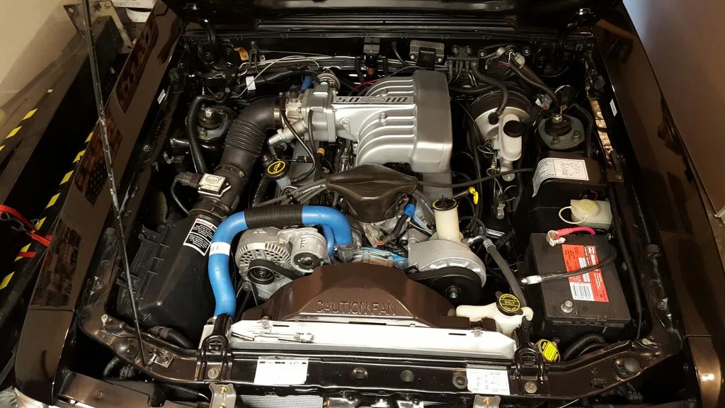

yeah... this is how it looks now (ok I put proper OE Ford black rad hoses now)
The Typhoon has been painted and I put a cut up 5.0 plate there to sort of make a weird OE look lol
Nice looking engine bay.
While you are at it, put the ac back.
This one came out of the factory without AC... But the previous owner put some dealership installed AC unit, hacked the HVAC box, used some weird compressor I've never seen before as well as brackets with no Ford part number. Looks like it came out of a Ford Econoline lol. I just put it back to the build sheet, no radio, no AC, no power anything. Just a cheap low-grade notch for some poor dude that couldn't afford a GT hatch back in 87 lol

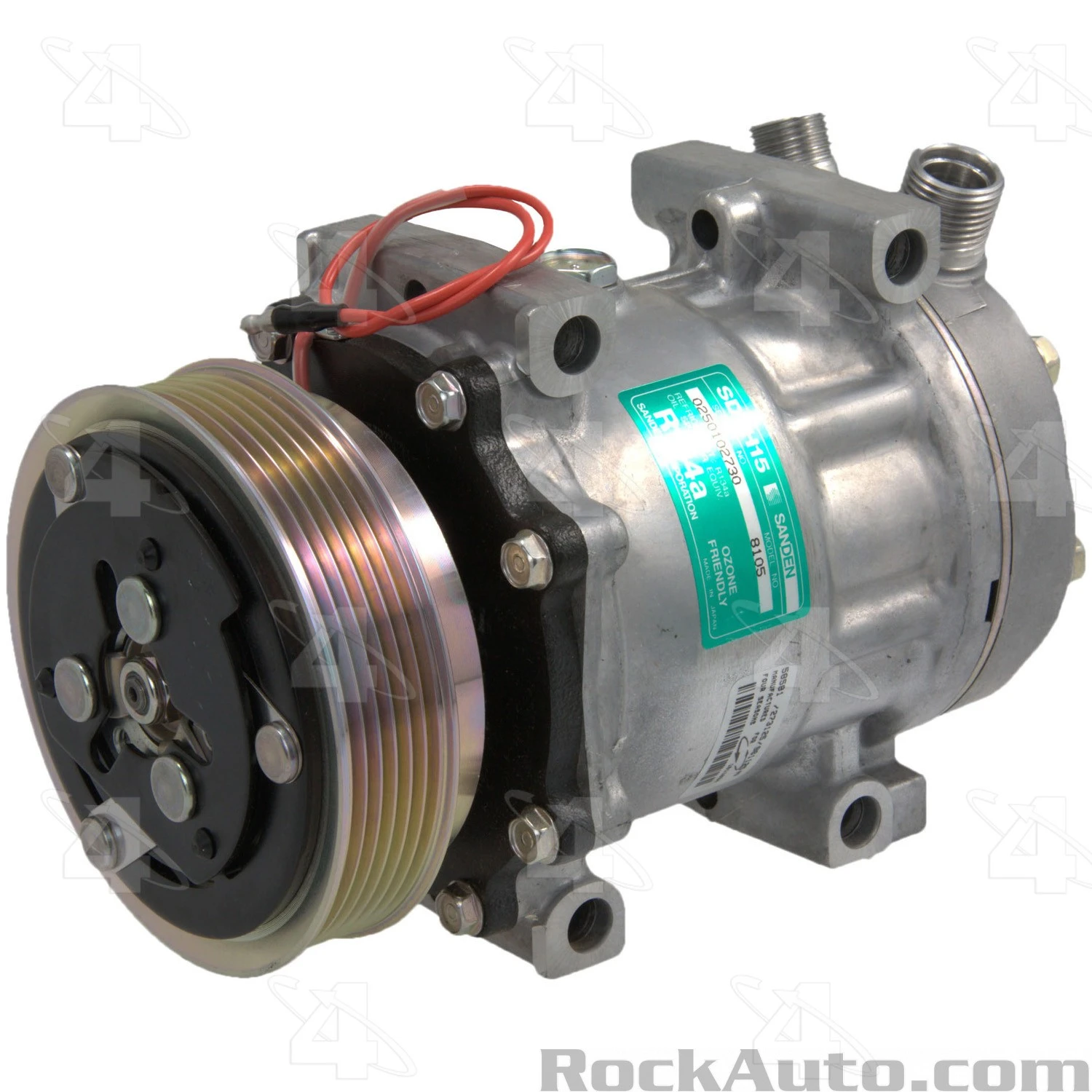

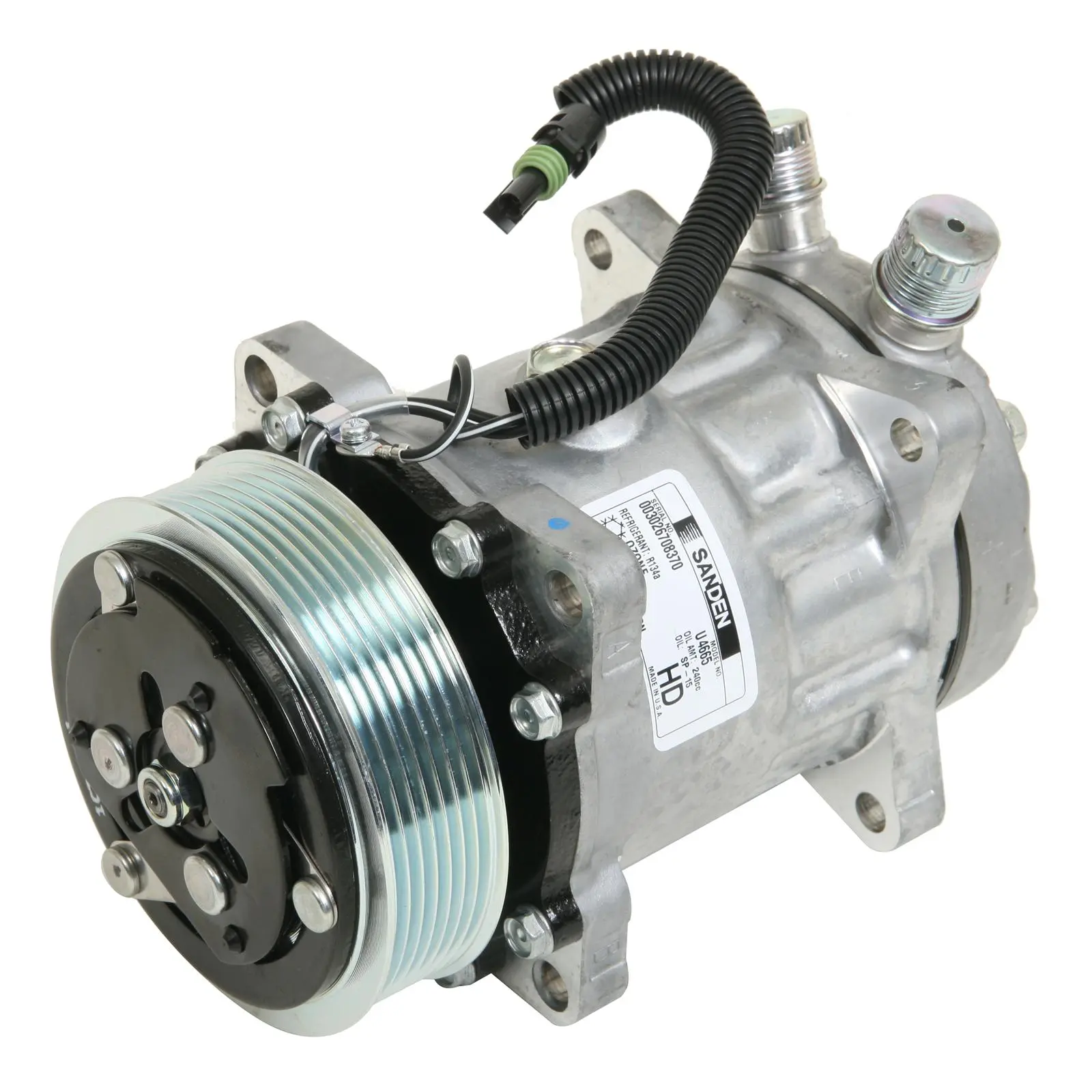

For AC, there were two options. One is factory AC which is the standard setup we all know, and the other is a dealer installed AC option for cars delivered without it. There was a discussion a long time ago about dealer air and I believe the reason behind it was that you had to order certain options packages to get factory A/C. Some people didn't want this I guess so they took delivery of cars optioned the way they wanted to and then had the dealer add A/C
Factory AC uses a Denso 6P148A compressor. Dealer installed uses a Sanden SD709 compressor
Here's an SD709
