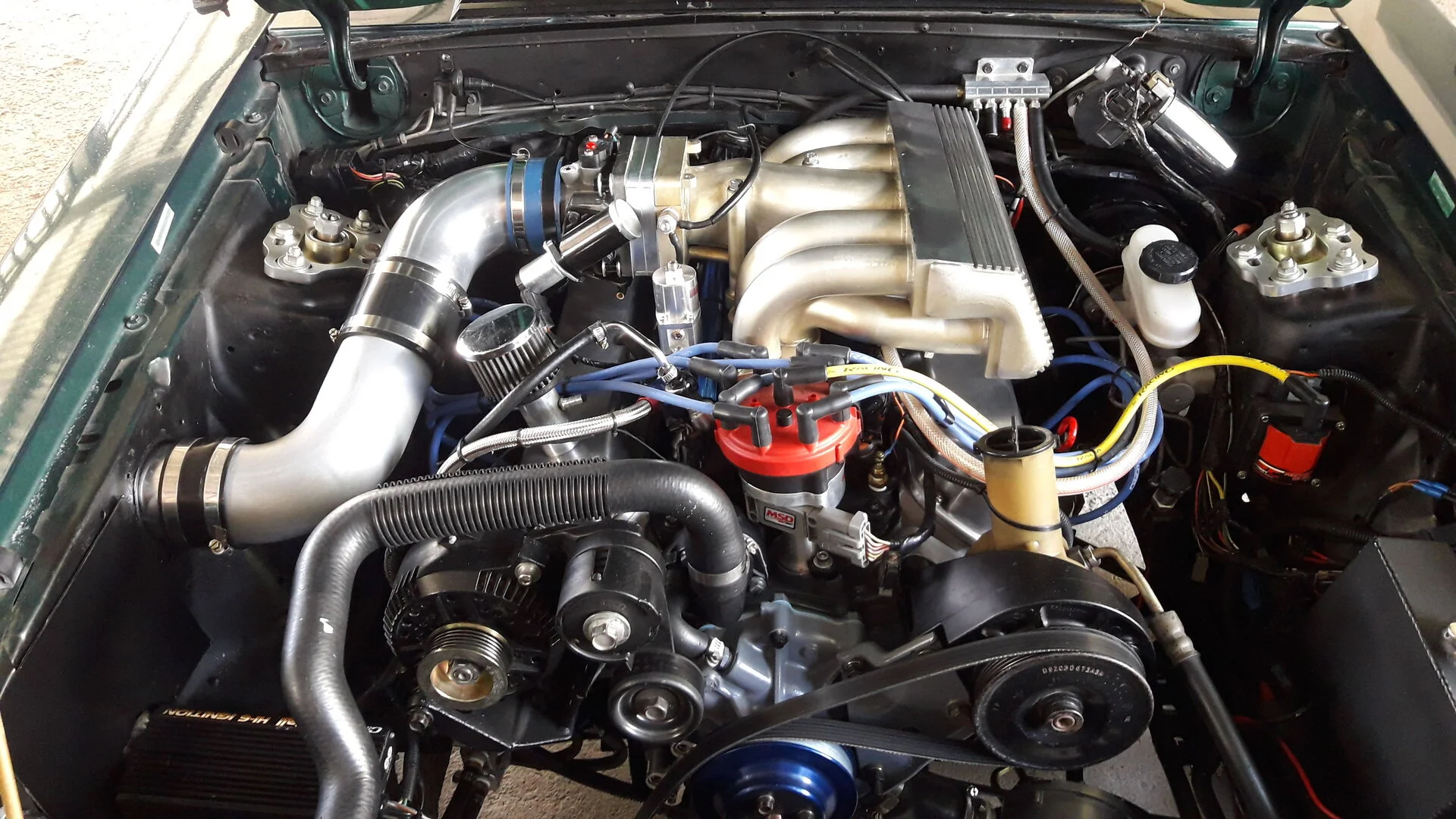

Wow, that engine and engine compartment is beautiful! I’m envious! My ‘86 has the Edelbrock Performer intake, Trick Flow heads, roller rockers and Bassani ceramic coated headers, but doesn’t look nearly as good!
Thanks a lot! Mine might look nicer, but you have more power :)

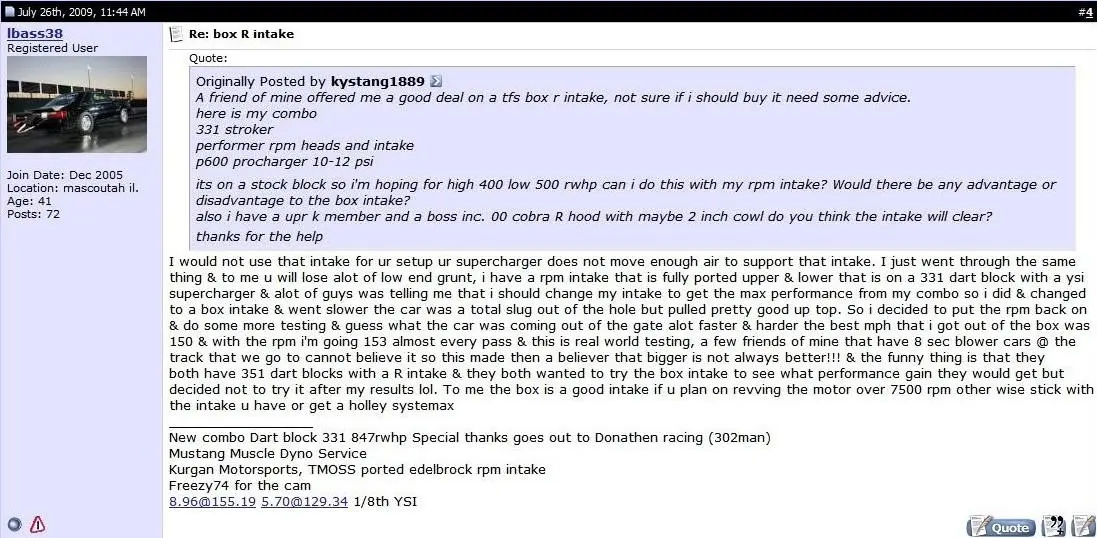

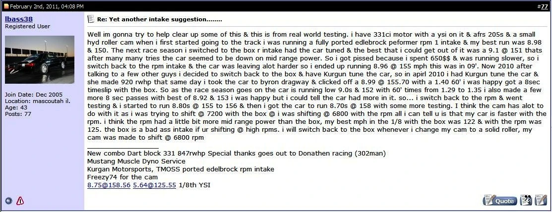

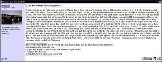

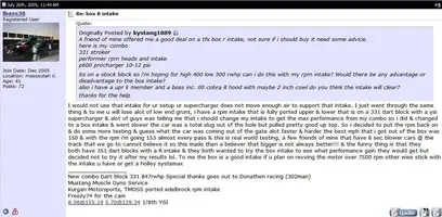

which intake is better depends on the whole car build. I ported an rpm1 intake for a blown 331 race car and it flow tested 277 cfm average (we have ported then to flow 313 cfm) when I was done. It went on AFR 205 308 cfm heads. He tried a Box-R intake to go faster but couldn't and when he took that off and put the rpm1 back on he went quicker and faster than ever. There is one primary reason for this - let's see who can guess why.
The Power glide 2 speed transmission. He made more peak power with the Box-R but lost average power. He needed his torque curve to be FAT in the one shift range for shift recovery and hang in therethrough his stated shift point. The torque (average hp) lost was too great with the Box-R to match the "smaller" intake. If he had a 6-8 speed auto things might have been different.
