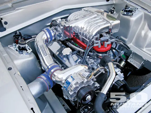

The intake that's on there has obviously had a lot of work done to it. An equal amount of work would need to go into its replacement.
By the time/money that could have been done, you could add one of these and call it quits:
:shrug:
Yyyyep. Looks to me like it would fit in there quite nicely. :D

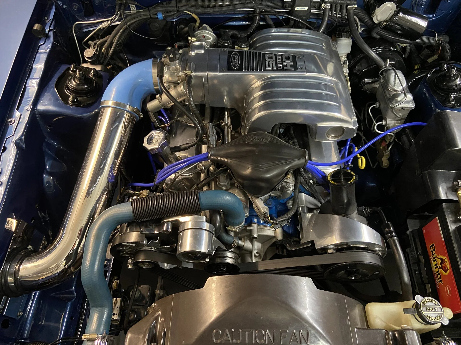

What I mean is: Keep your intake. It's gorgeous. Add a supercharger, fuel injectors, fuel pump, and a tune instead.
Instead of replacing the intake, replace the CAI with a Supercharger! :rock:
Reactions: General karthief
Looks like the heads are painted so I'd guess they are gt40 irons. The rpm is probably more intake than iron heads need.
With that said, it's a nice engine, pay up for a gt40 tubular and have it polished. It will be worth every cent.

That’s beautiful!! You’re running the stock ‘86 block with those GT40’s?
