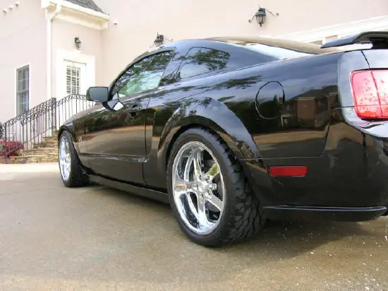

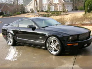

I dropped mine with the sportsline kit from eibach and i have 19" adr racing rims with 295/55/35 on rear and 255/55/35 on front. Rides great with no rubbing or anything...just lots of looks:nice:
im confused on your tire sizes. did you mean 295/35/19 rear and 255/55/19 fronts? :shrug:
That looks good and i like the tire selection to bad there sizes for 20s suck unless i want to go 275.
