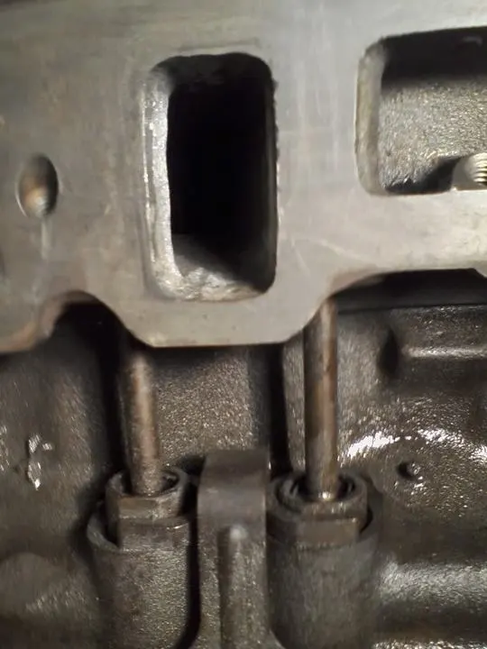

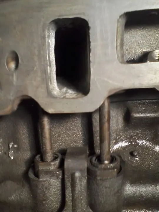

pics of what the heads???, theres nothing to see
just the ****ty port job. but this wont tell anyone anything as to wether or not its cracked internally in like a coolant passage way. but here u go

Hmm im not sure if it can be linked to just one specific problem. The origional drivers side oil leak sounds like the gaskets were not sealed correctly or heads were not torqued right. (as stated above) Have any pics of the steam coming off or place you suspect the leak is coming from? I know its most likely a difficult angle to take shots from but any pics of the actual leak would help. If its a head problem Tmoss can prolly help you when he gets word of this thread, the coil and dizzy problem may have been from not installing them right after the head cleaning and stuff and the timing could be off which could lead to a lot of problems.
