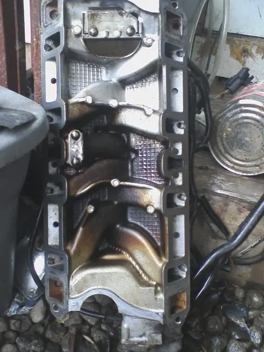

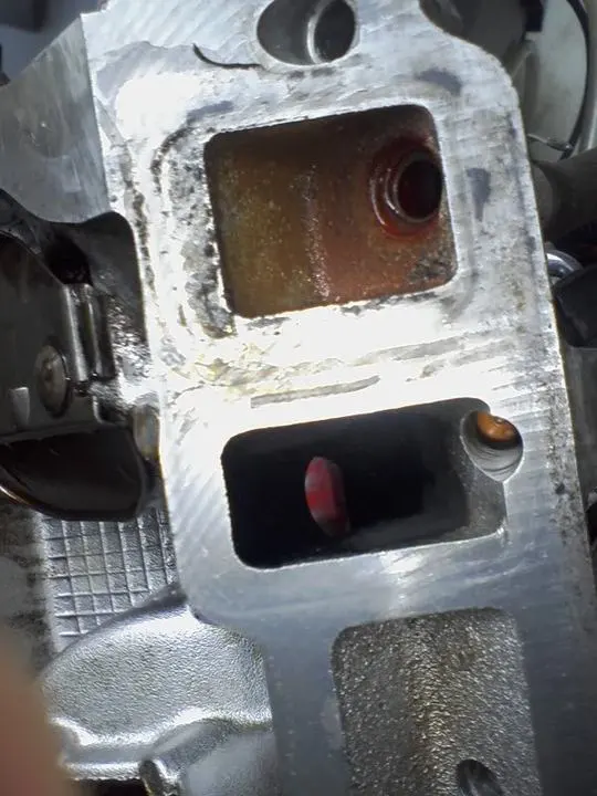

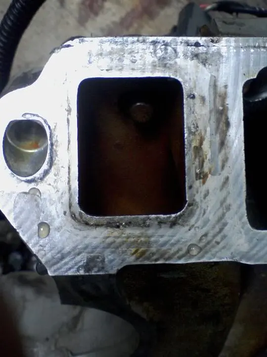

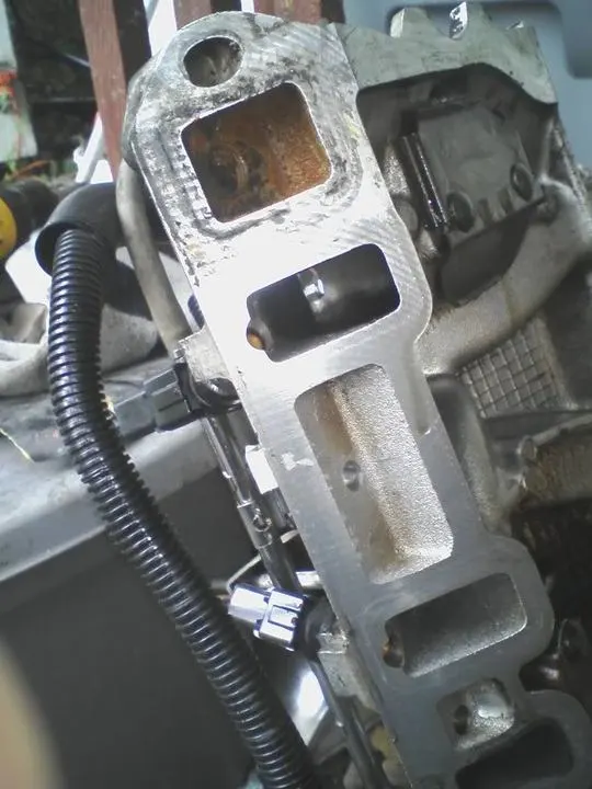

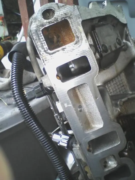

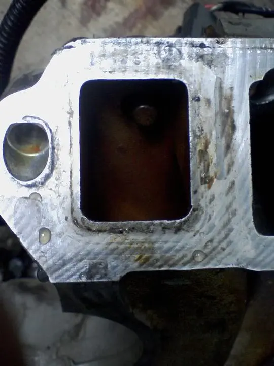

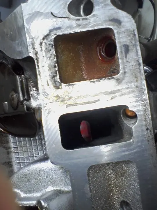

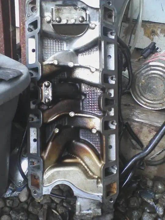

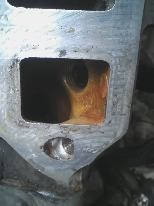

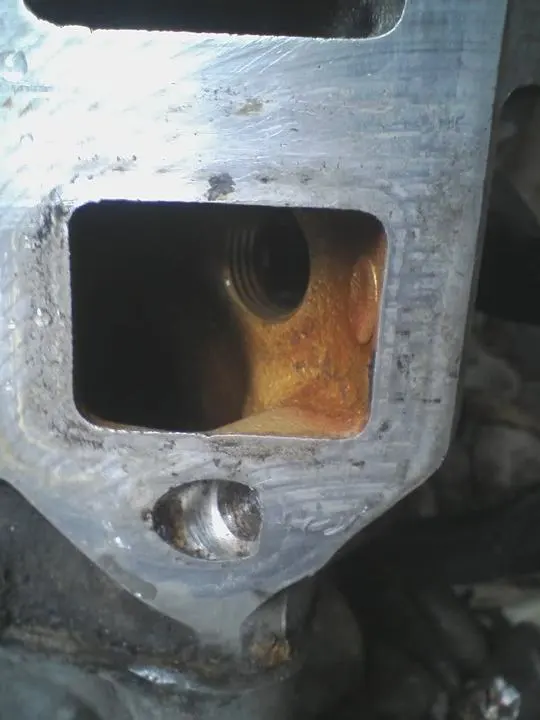

they were dirty when i did the heads in the first place.anyways im putting my lower back on this morning, heres how it looked when pulled, kinda suspect if you ask me\
