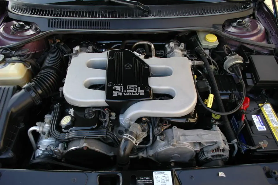

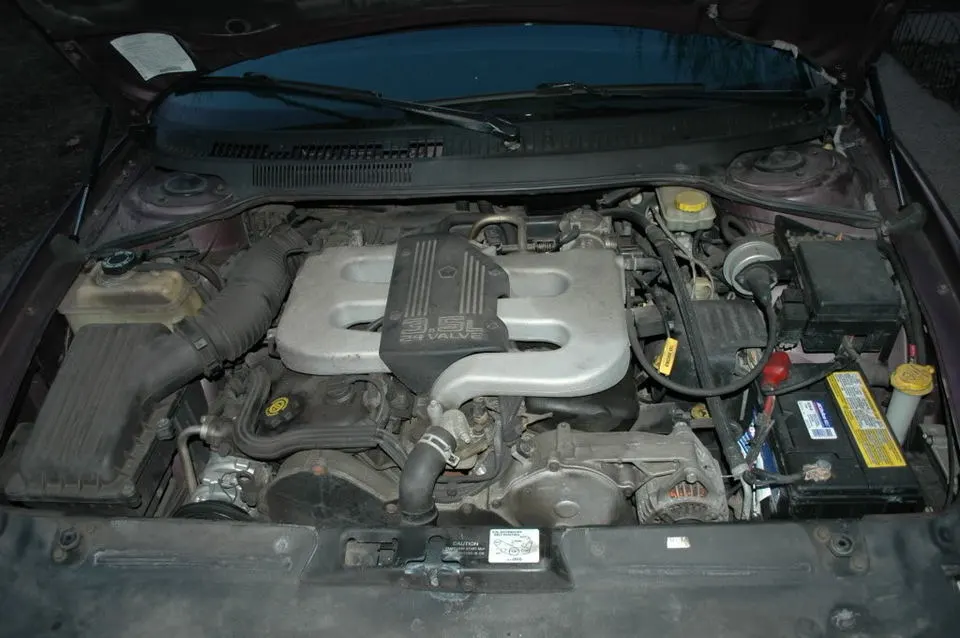

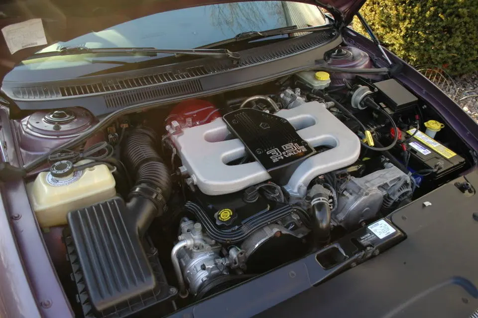

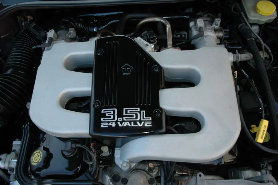

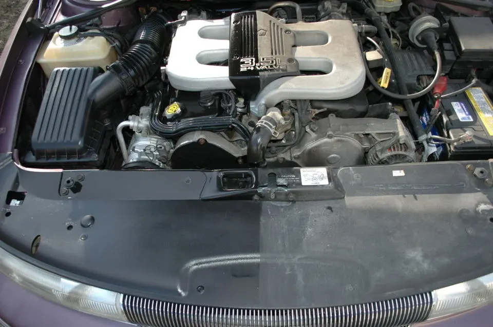

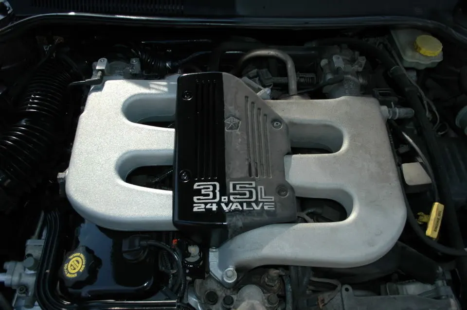

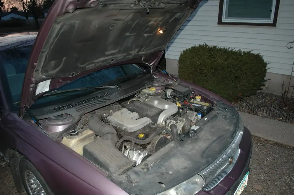

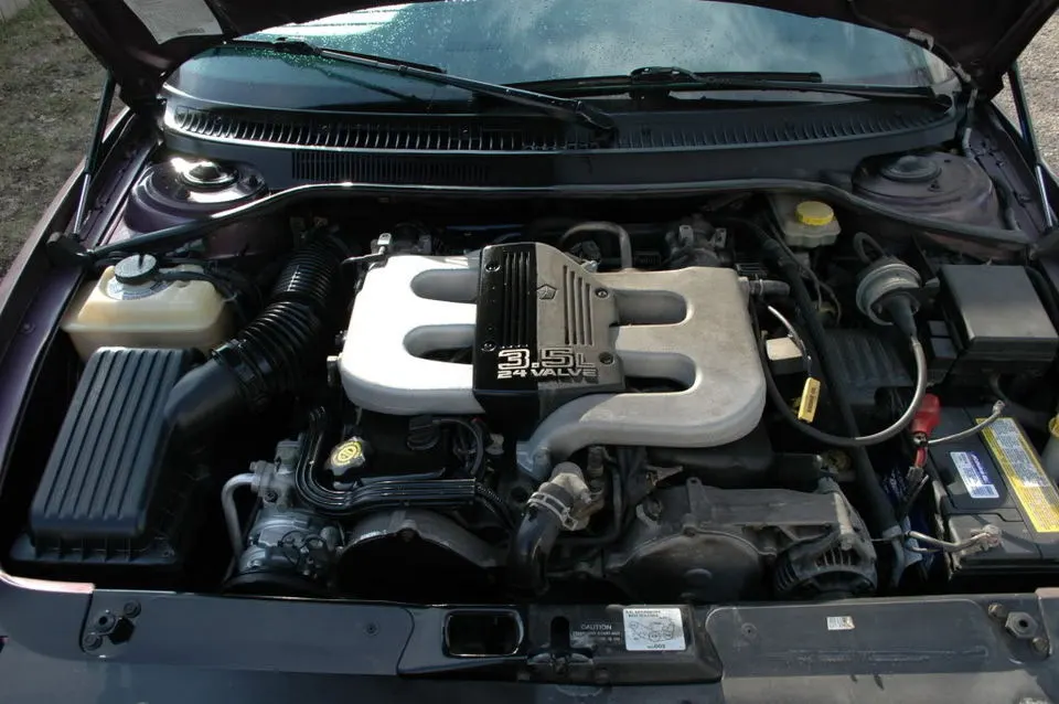

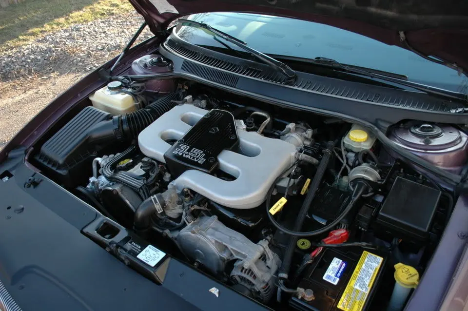

Here's a couple pics of an engine detail I did on my DD.
Before:
50/50
Afters:
Before:
50/50
Afters:
