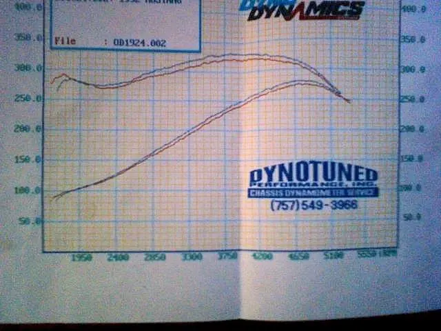

While my setup is significatly different than yours and mine choked @ 4500, your can use your imagionation (or a straight edge) to see what I's working to.
I personally think you'd be looking at about 270 RWHP and 290 torque.
92 Mustang coupe, 331 stroker w/ 10.4:1 compression. 30#injectors, 190 lph fuel pump, msd coil, bbk ssi intake, cold air, cc 1.6 roller rockers, World Windsor Jr. iron heads, Diablosport chip, shorty headers, deleted smog, high flow cats, flowmasters, 70 mm TB, 73mm MAF, SRP forged pistons, 5.4” H-beam rods, 4340 steel crank, balanced @ 28 oz, billet steel flywheel, Kevlar clutch, etc.
