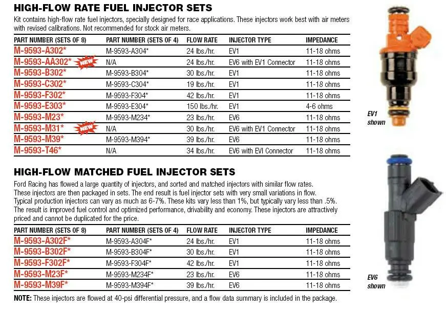

I then decided to check Fords parts catalog. Which is where I found...
As you will see, the "high impedence" style injector is normal for us. Several years ago you needed would use a low impedence injector for the very high flow rates that were necessary for high performance cars. These required special drivers, or added resistor packs, to be used in cars that required high impedence injectors.
Fast forward to today... you can get 200# injectors that are still the proper resistance spec for our cars.
the highest number I see on those charts is 42# for the high impedence injectors.
that said I recently bought a set of 50lbers from ford that are high impedence. at some point the resistance must change [low impedence] to get a proper flow rate. but you are correct as of today there are many options available.
