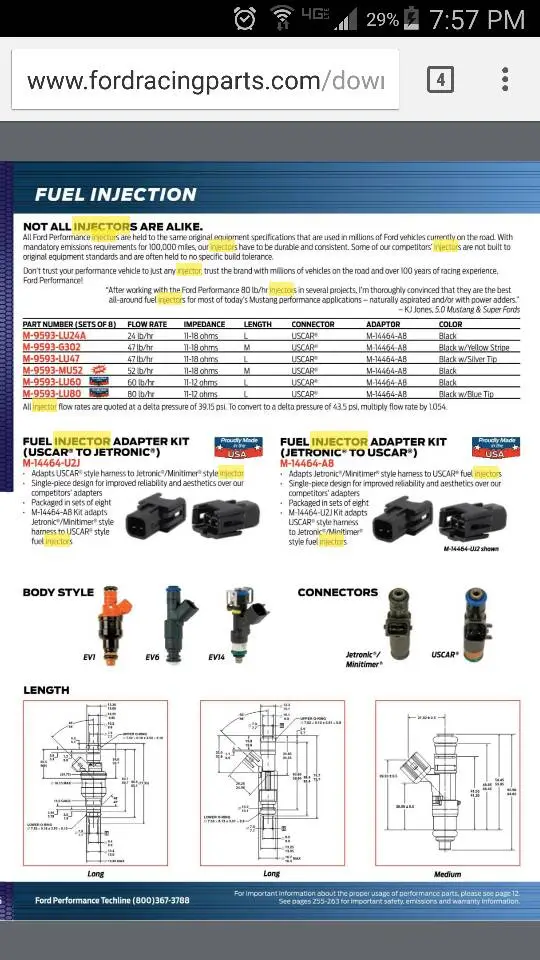

the highest number I see on those charts is 42# for the high impedence injectors.
that said I recently bought a set of 50lbers from ford that are high impedence. at some point the resistance must change [low impedence] to get a proper flow rate. but you are correct as of today there are many options available.
Old chart.
Here is the current.
This isn't exactly black magic. I'm not selling lies here.
Old chart.
Here is an article written in 2012 on the subject by the guys at hotrod. It describes the difference between low and high flow injectors with regard to impedance. They may possibly know what they are talking about. I don't know about you, but I wouldn't exactly say 2012 is ancient history. As far as I knew, this is/was accurate.
http://www.hotrod.com/how-to/engine/hrdp-1211-low-impedance-vs-high-impedance-fuel-injectors/
Btw, nobody said you were selling lies, only going off of the latest known tech. It's been stated by me once in this thread that you obviously know your stuff. Just because someone isn't up on the very latest thing is no reason to gloat or get testy.

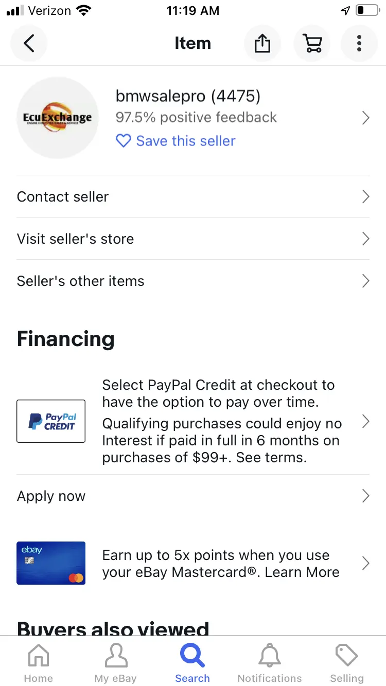

The ECUExchange can make that 30 year old ecu like new, they can be found on Ebay, I've used them many times.

The seller’s name for the ECU exchange is bmwsalepro
