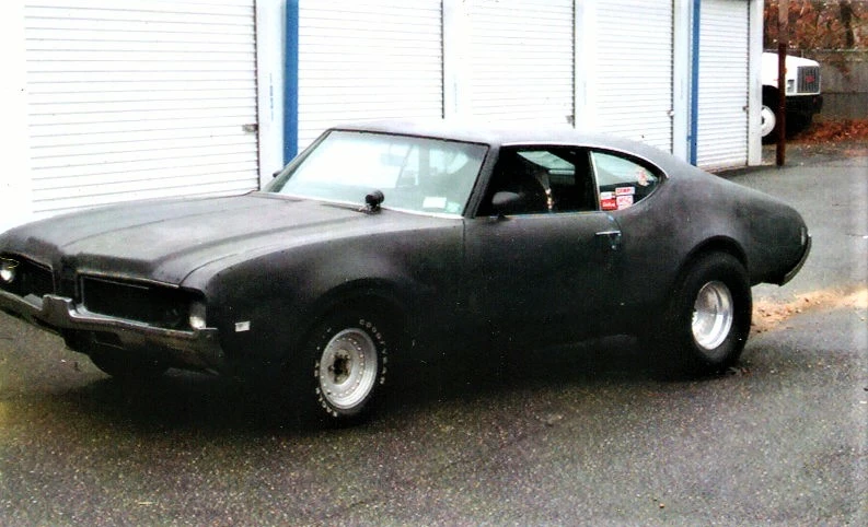

Ive been cited for reckless driving in my 69 Olds442 w/441cuin SBC w/a 350turbo transmission w a 4000 stall converter ,purple hornies attached to longtube headders and a 411 rear quite a few times and paid hefty fines.. When I hit the gas to get the car moving when the light turned green it sounded like I punched the gas off the line...I tried explaining to the cop about the camshaft n converter plus gearing and he said tell it to the judge....LOL
Now I build my performance engines for the street with such brutal lowend torque they get up to speed really quick n effortlessly through the Magnaflow cats n the mufflers and it doesnt even raise an eyebrow of the local fuzz yet Im still having fun plus also saving my valvetrain from heavy high rpm abuse and always having that feeling like its futile to defy gravity by being sunken into the seat with some nice force is a pretty awesome feeling without the diesel smell or the black soot..........LOL
