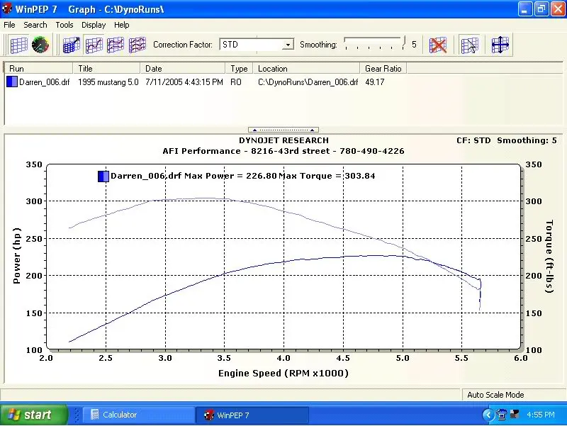

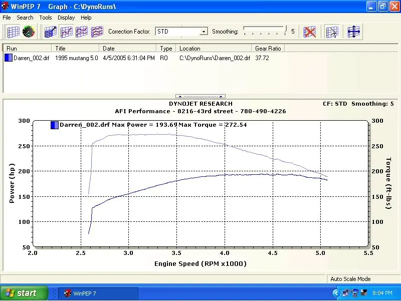

This is from a post on corral
Before Exhaust:
After Exhaust:

That first dyno curve looks like a failed run. The torque has a flat spot early on, and the run ended far too soon.
BTW, I would think it would be fairly impractical for someone to run a comparison dyno comparing shorties and LT given the work in installing LT headers. Unless you had the motor out and were running on an engine dyno. Maybe a before and after when installing LT, I guess. Anyway, hopefully that's what those graphs are showing. Please fill in the details on the runs, if available.

I don't think anything is wrong with the first pull.
To me, it looks like the tech started capturing data a bit before he had the pedal to the metal.
I've seen curves that look like that from the start of the pull on more than one occasion before.
Grady

final5-0 said:
igotyofire
Have you got any more details other than .............
before & after exhaust :shrug:
Grady
Corral Thread http://www.corral.net/forums/showthread.php?p=5546281#post5546281
His user name is "Darren5.0L" on the corral forums and this is his mod list in his sig
1995 Mustang GTS
226.8 RWHP and 303.8 RWTQ NA
MAC Longtube Headers
MAC Prochamber
Ford Racing M51 Catback
ZEX WET Nitrous Kit w/Purge&Bottle Heater
March UD Pulleys
UPR Smog Delete
EGR Delete,
K+N
Cervini's Ram-Air
C&L Truflow Inlet Tube
Superchips Inc. Bluechip (it sucked, now gone.)
MSD Blaster
FRPP 9mm Wires
