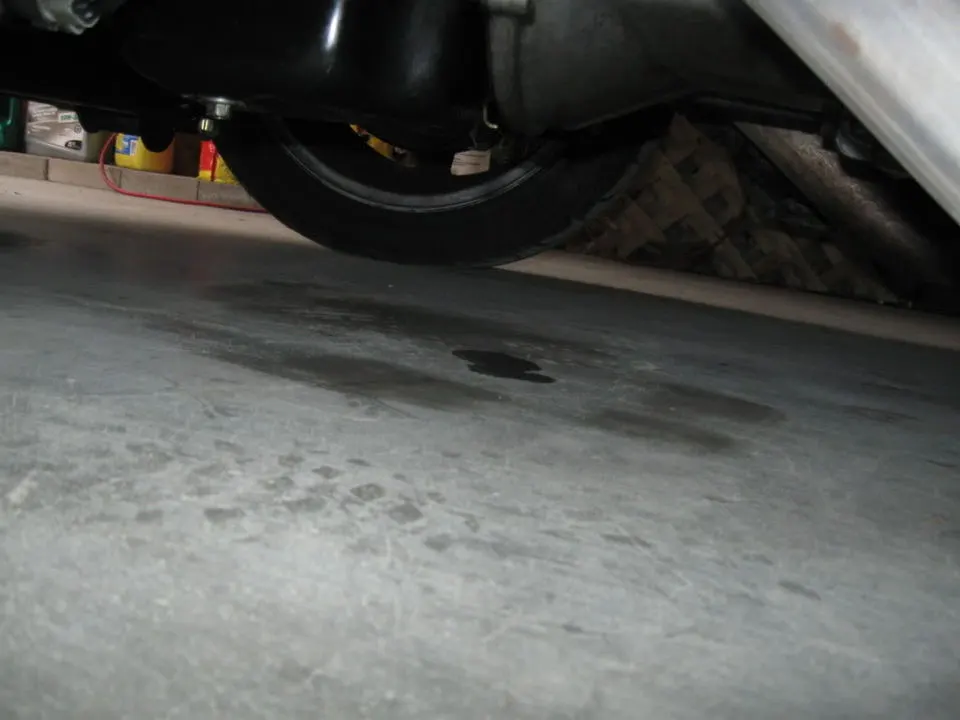

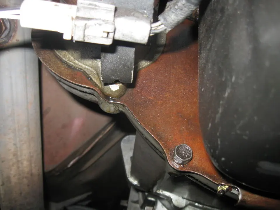

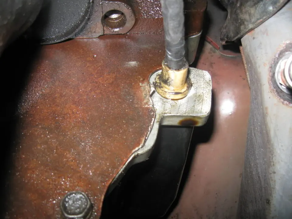

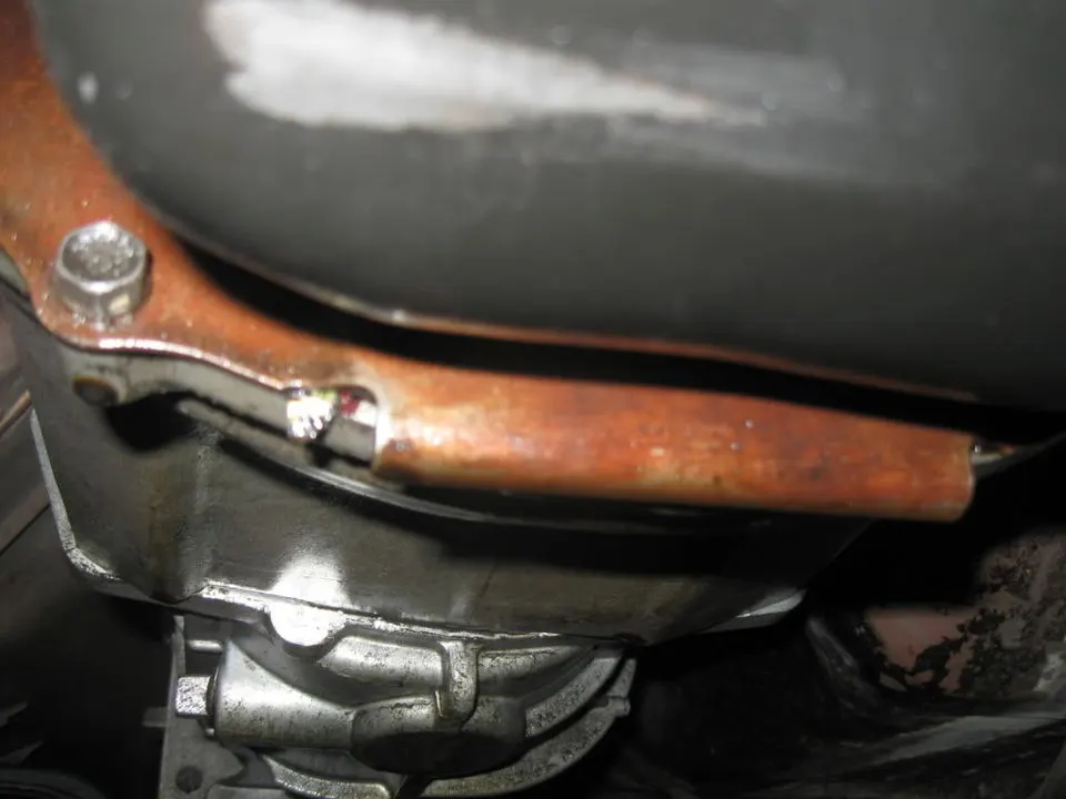

So Im fed up with my oil leak and have decided that Im going to fix this issue once and for all. I did discover oil today which appeared to be coming from the valve cover, it was pooled up between the bolts on the upper intake. I also took pics of what it looks like under the car, you can see the oily sheen on the parts in the pics. Is it possible that my valve cover gasket is leaking and its dripping down onto the transmission and then onto the ground? It drops oil on two spots on the garage floor, one directly below the transmission where the oil pan and transmission are and another spot that is further to the drivers side which would appear to be coming from the driver side valve cover area if it were to directly drip from there off the engine block

I just confirmed that it was in fact the drivers side valve cover. I wiped all the oil off that had pooled up on the intake (in the picture) and cleaned up the transmission. Took it for a spin and came back and it was leaking down the drivers side of the trans and the oil was back where it was before on the intake coming from that valve cover.
well its either coming from that valve cover or up from the intake and I had checked the bolts and they are all tight on the intake.

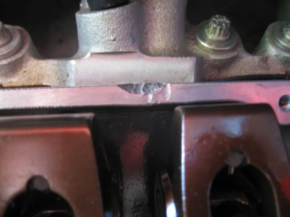

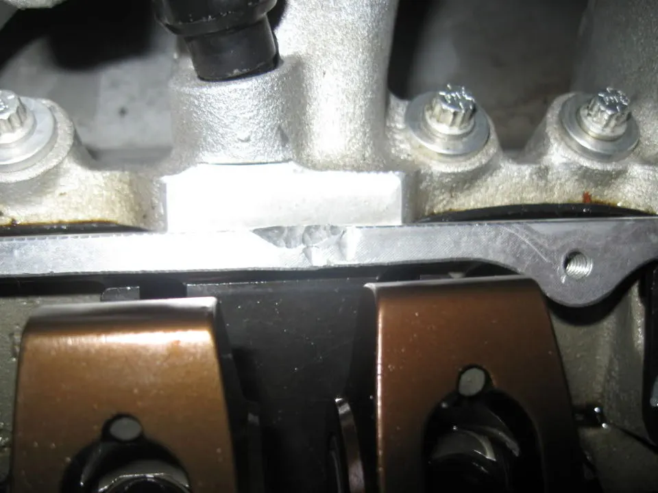

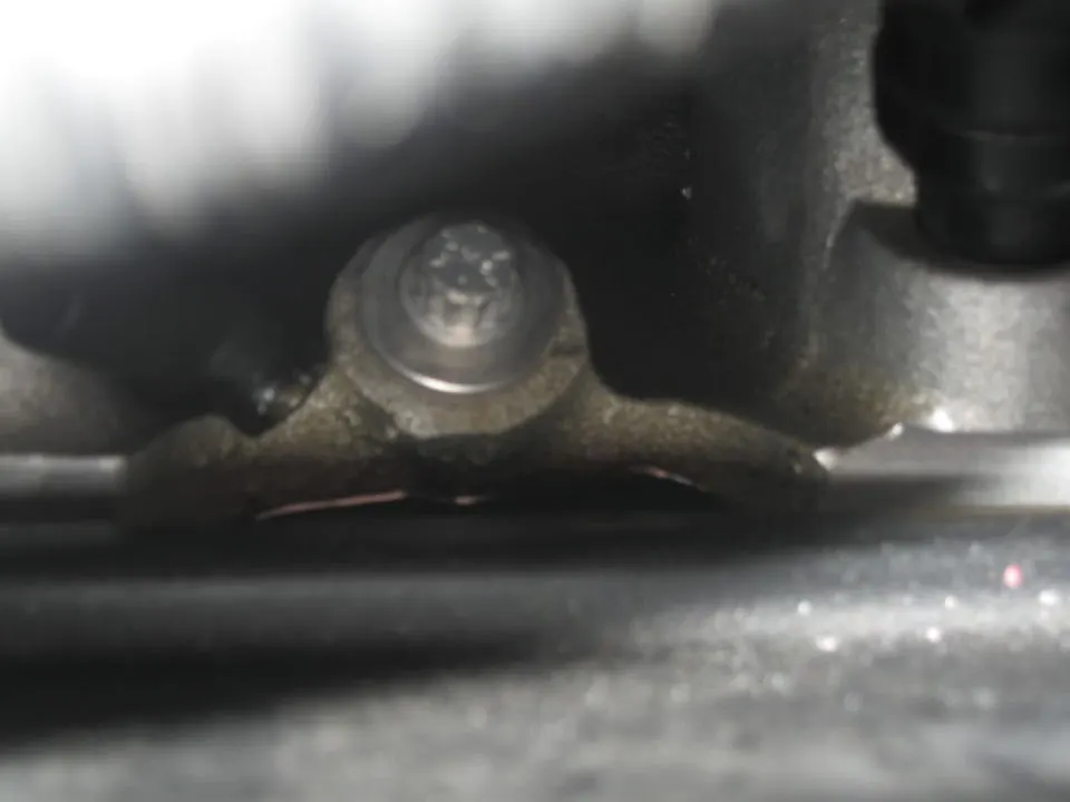

Could this spot on the head be a reason for why the valve cover is leaking? I discovered it when I took the VC's off. It is on the drivers side, the one that was leaking.
also the ones I took off did not appear to be the re useable rubber ones. They were very hard and stiff and the valve covers had been replaced at the same time the TFSR intake was put on when this whole issue started.
I picked up some JB weld and some really rough sand paper 60grit b/c I could not find a honing stone at walmart. It should do the job. I'll start working on it later this week or friday when Im off from work all day.

Was that like that when you bought them?
They were on the car long before I bought it. I have no idea how that damged happened
You're more ambitious than I am. I would have just filled the gap with a wad of black silicone.

Ive been dealing with this for 2 years now and it looks like I finally figured out the source of the oil leak. Im going to make sure its done right
Put some JB weld on the bad spot tonight, there was actually another small ding further down toward the front of the engine. I'll let it dry tonight and tomorrow and sand it down tomorrow night when I get home from work
