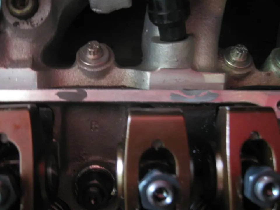

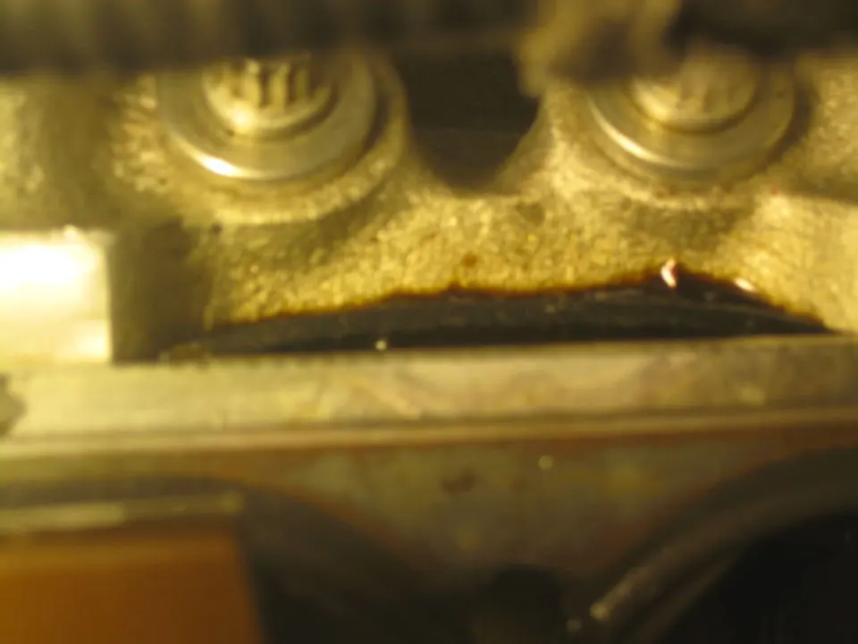

I dont get it Im beyond frustrated :mad: I redid both gaskets today, filled the damaged head w/ JB weld and let dry for over 24 hrs, smoothed it out flat w/ the surface of the head and it still leaks. All the bolts are TIGHT and its still leaking just as bad as it ever was before. I'm so done w/ these POS heads, they are coming off as soon as the car is up for the winter and getting replaced!!!!!!!!!

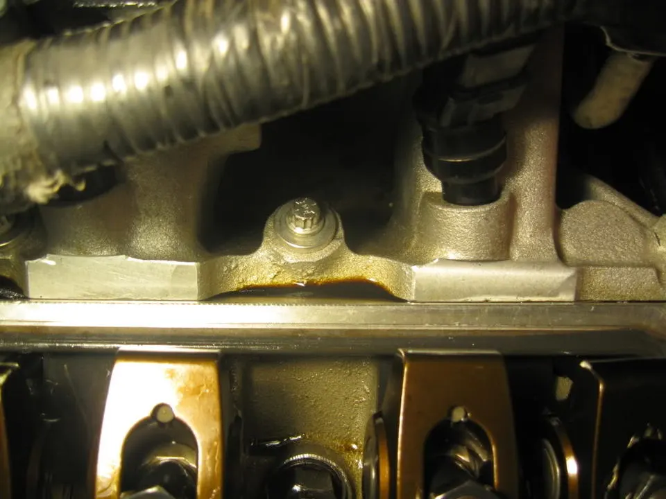

And this is what it looks like after.

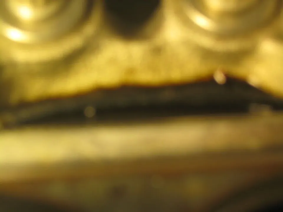

same as before
And I dont see how they would be warped or twisted either. Everything was fine when it had the stock valve covers and Cobra intake.Ever since those were swapped for the Ford Racing covers and the TFSR and now the Victor 5.8 its always always leaked. I wonder if its worth trying the stock valve covers just to see if anything changes. Ive always wanted bigger heads for this combo and this issue is really pushing me to it. On Avg I get back $1,500 from tax's, Trickflow 205cc heads are $1,800 and Id sell these things for dirt cheap with details on issues Ive had w/ them
Your repair to the ding on the heads looked good to me :nice:
That ain't your prob :nono:
The vc's are not fitting next to the heads as they should
Warped vc's or something causing interference thus not allowing a good seal
Just look over everything real good :Word:
Good Luck:)
Grady

Its not coming through the valve covers. I just took it for a drive and that oil is still pooled up by the intake and there is no way it came from the VC there is a bead of RTV all along it. its coming up through the intake but why????? The bolts are tight I dont dare to tighten them anymore w/ out damaging the intake or head.
